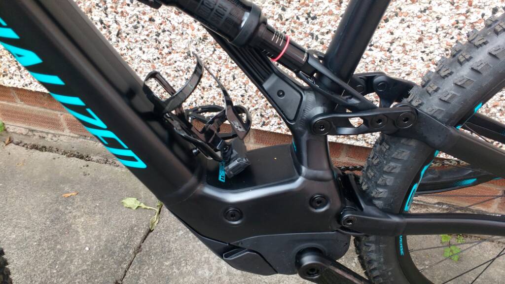

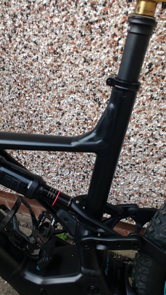

After a ride the weekend and dropping the post a little so not full leg extension, I've decided the fox post is enough drop. Saves me a few hundred quid getting the bikeyolk post.
So it looks like I'll be going fox kashima all round rather than rs black. My OCD would let me just have one gold part

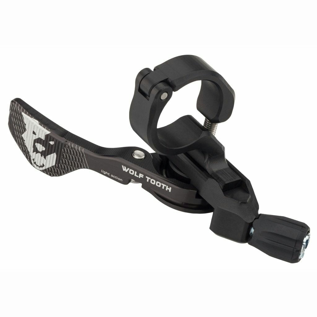

So I've ordered the next part...
Wolf tooth remote lever in SRAM flavour
https://www.kustombikes.co.uk/wolf-...jAEzkqzdHpDD1-yHWE9FbiZ0q_9C741kaAkUTEALw_wcB
Now I can run the coward levers where I can actually reach them

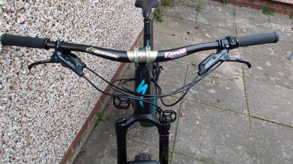

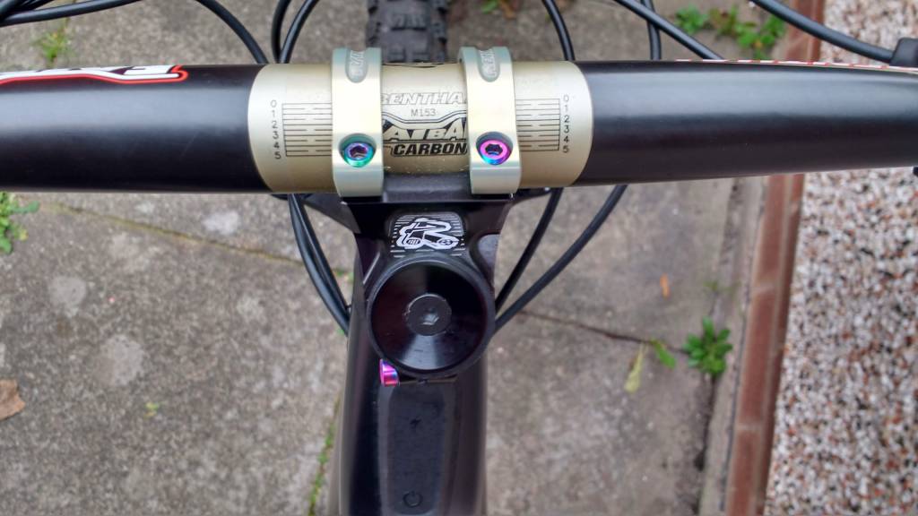

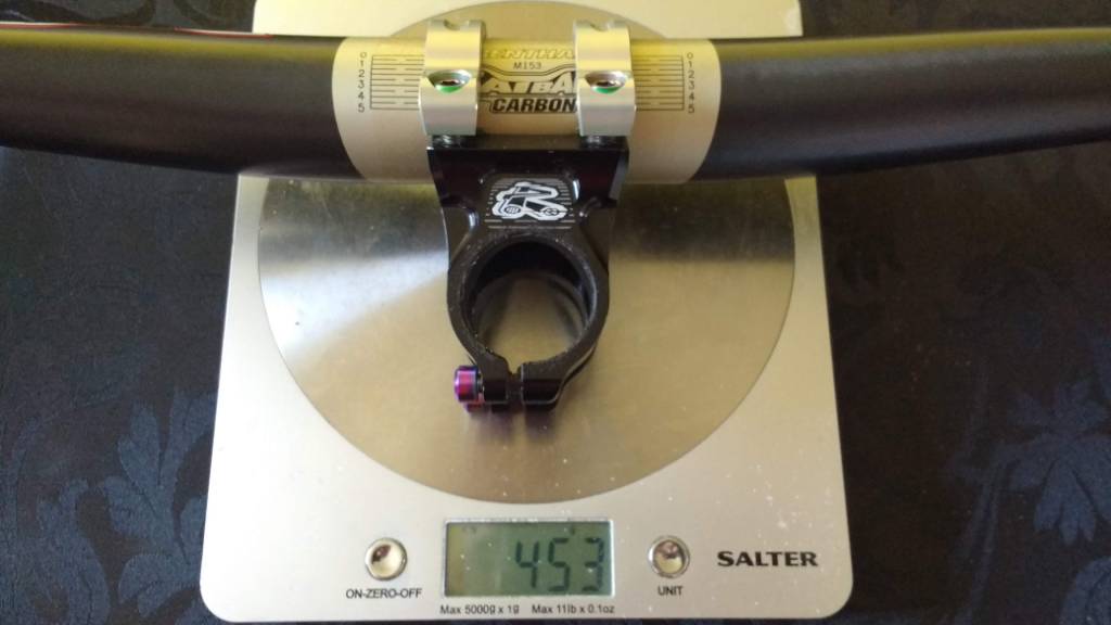

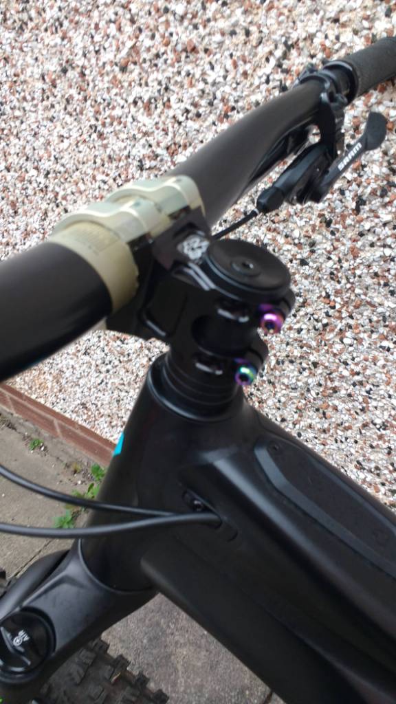

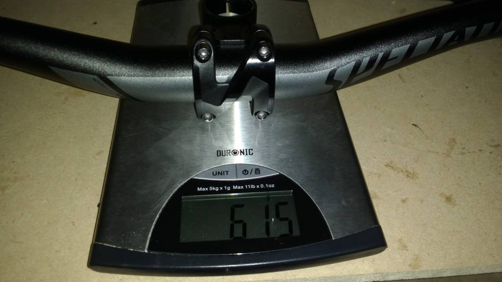

New cockpit has started. Out with the standard 45mm stem and on with rental 50mm (35) apex and ti bolts
Standard bars replaced with renthal carbon fat bars 780 (35) and Odi elite grips.
165g saving.

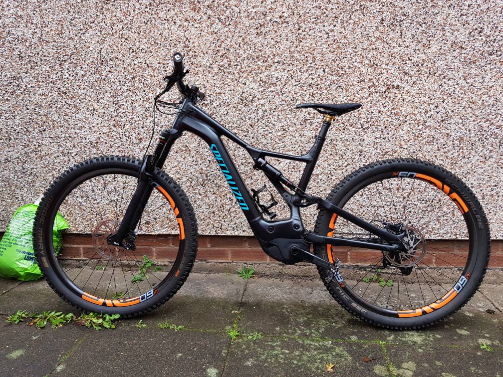

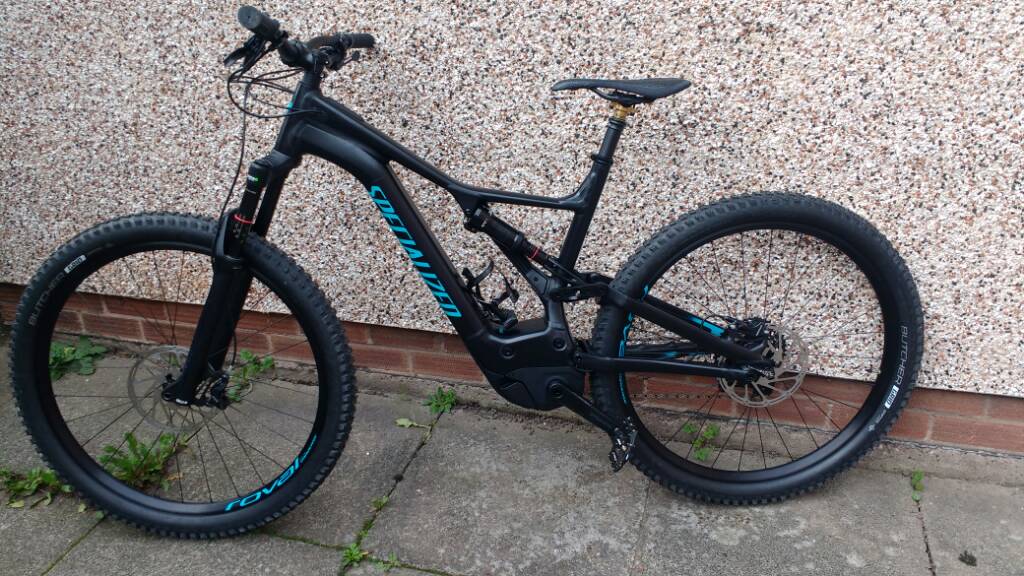

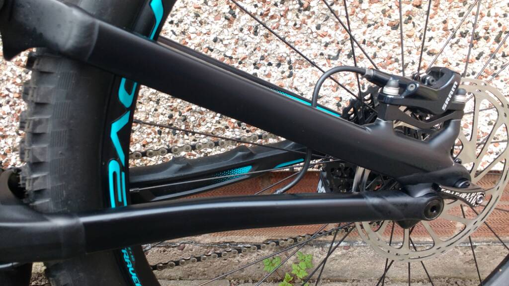

Swapped out the wheels, now had Enve m60hv with DT Swiss 240s (centre lock) -don't ask and Magic Mary 2.4, Nobby Nic 2.35 both tubeless. And twin 180 rotors with xx1 cassette.
New decals were supposed to be here Monday and the brake situation is on going.
Put her on the scales. Total 21kg. Massive 1.5kg saving. Bet the magnet was 0.5kg
Doubt I'll get her under 20, but will be 20-something with pedals for sure. So a sub 20 carbon version is totally feasible without getting impractical lightweight components.

Had a wee ride on it today. It was just brilliant! Taking 750g ish off the front end has made a massive difference, i'm back in business with coaster wheelies :cool:
Can't wait until next weekend when it'll be near enough final spec.

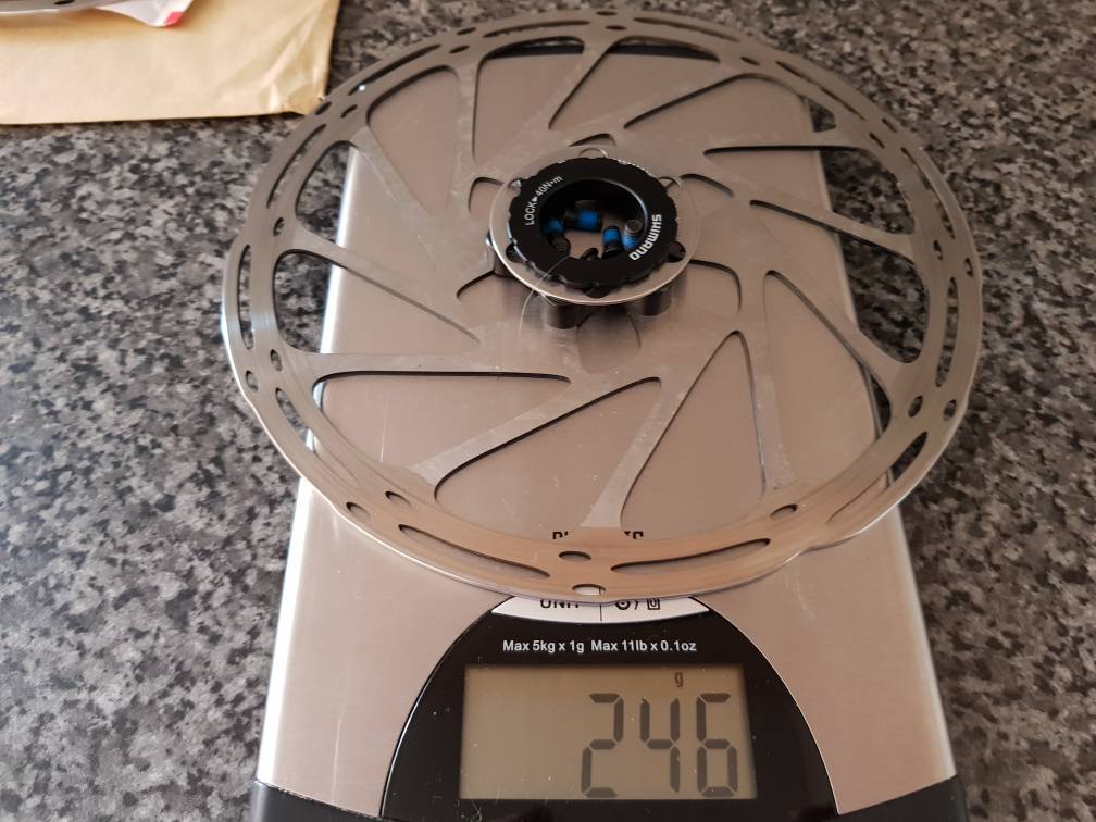

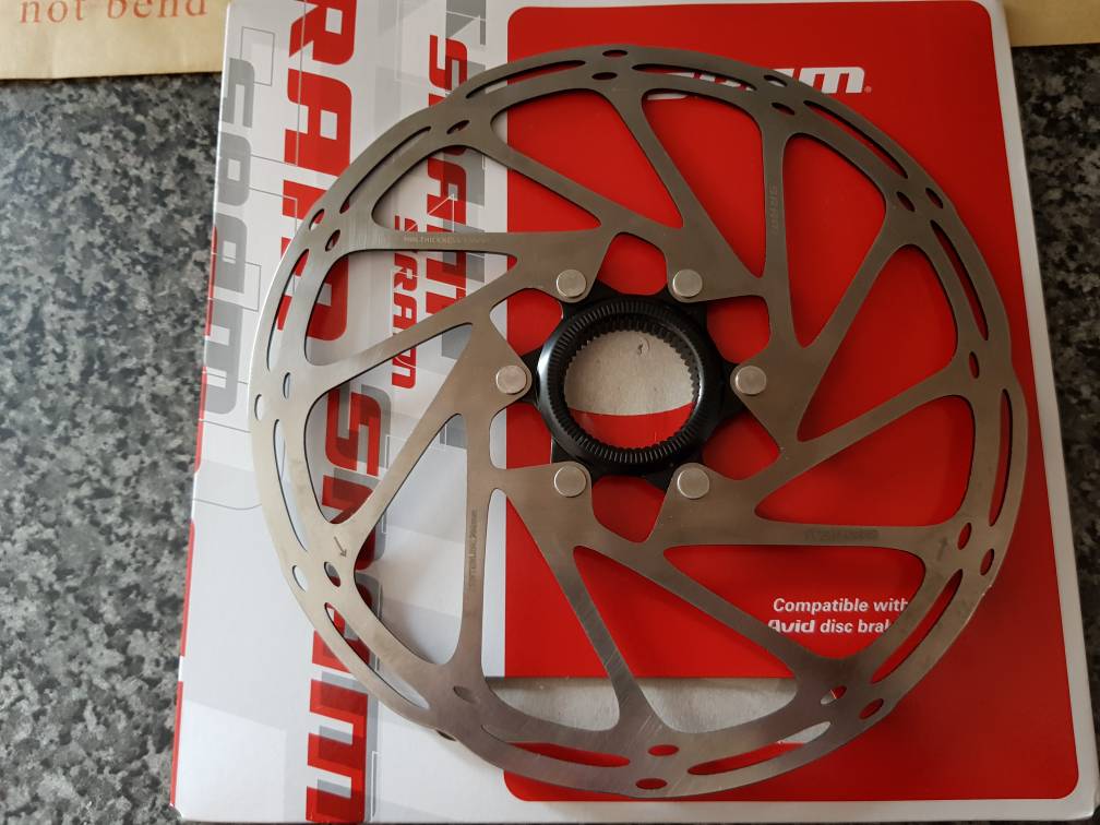

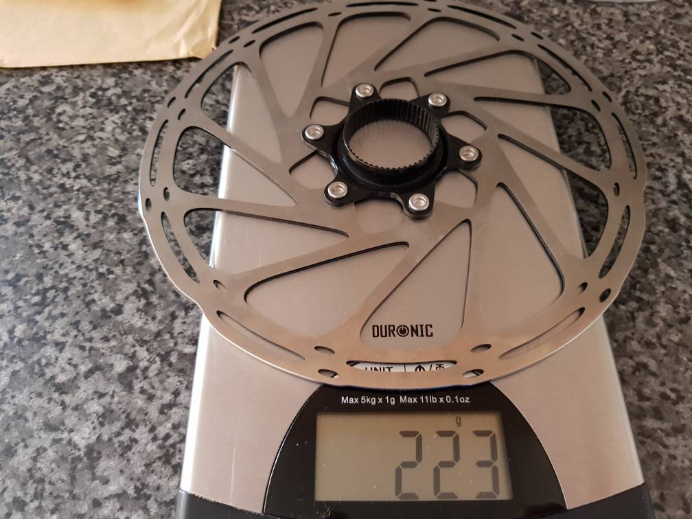

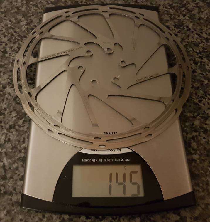

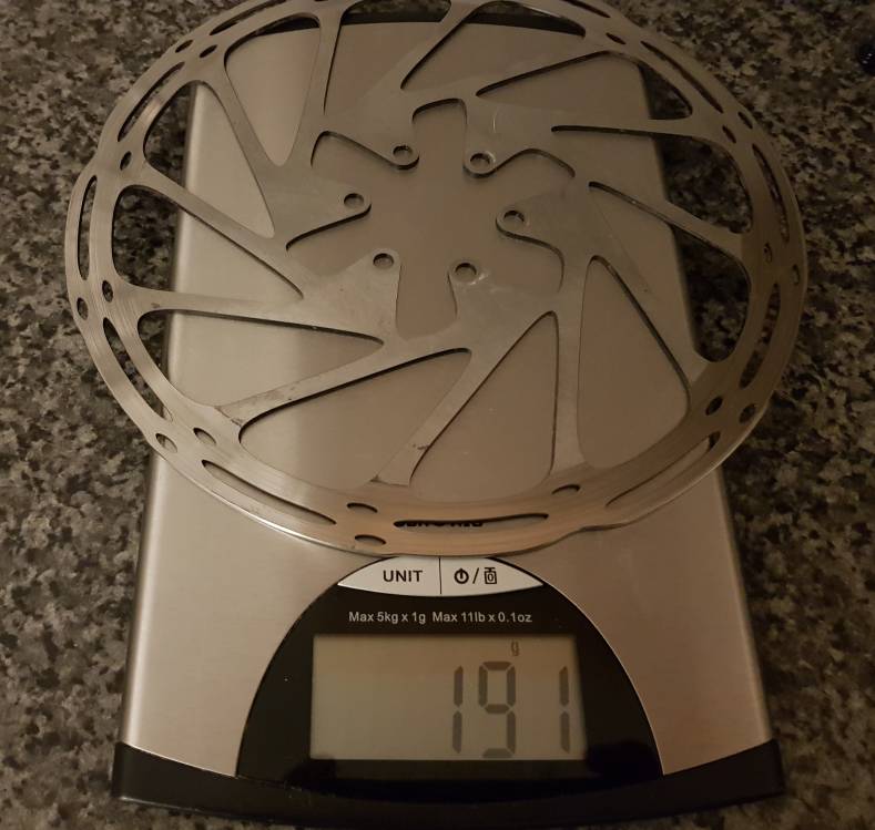

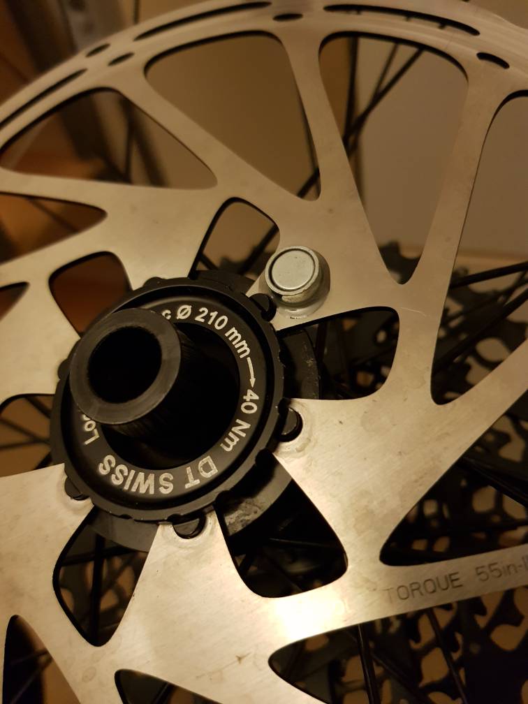

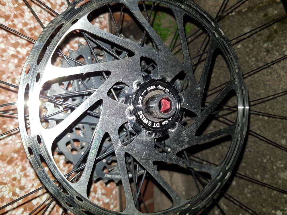

I was able to use the existing rotors on my centrelock hubs. .
Here's a few pics of the different rotor setups and weights. 180 centerline, 200 centerline, plus 6 bolt adapter and 200 centrelock.
I managed to solve the magnet issue and now I've one glued on. I'll update the brake thread with what happened.

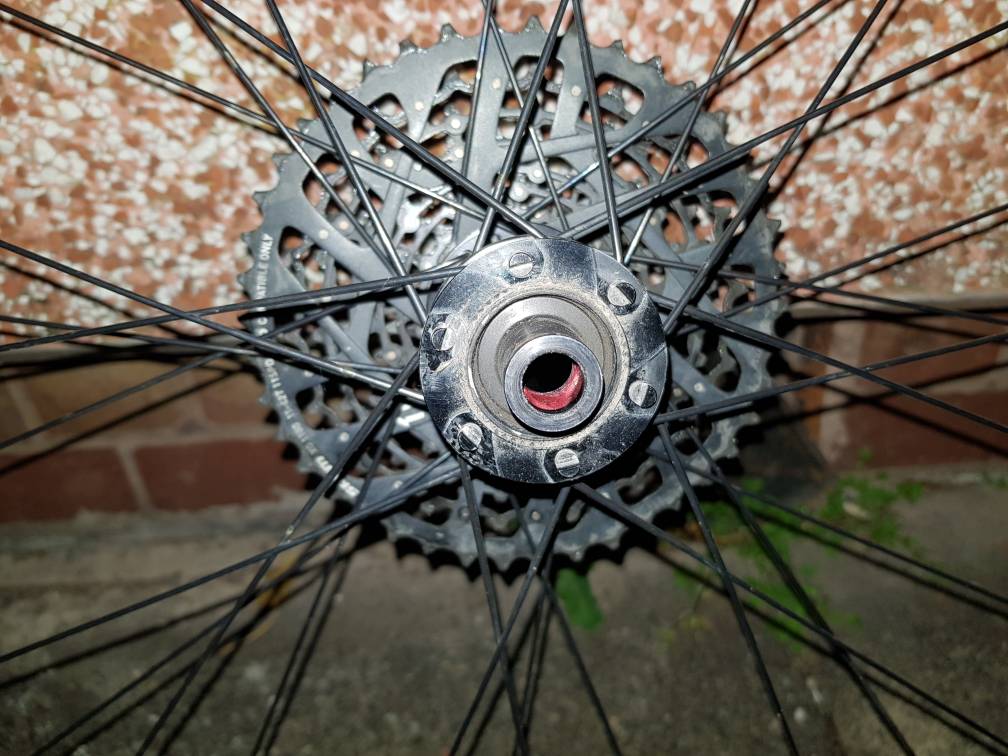

So the xx1 cassette was slipping pretty bad yesterday, so I've decided to go back to the standard gx cassette for the winter and get a bling one and chain in spring. (Maybe in 6m most will be on eagle and the 11sp will be on sale)
