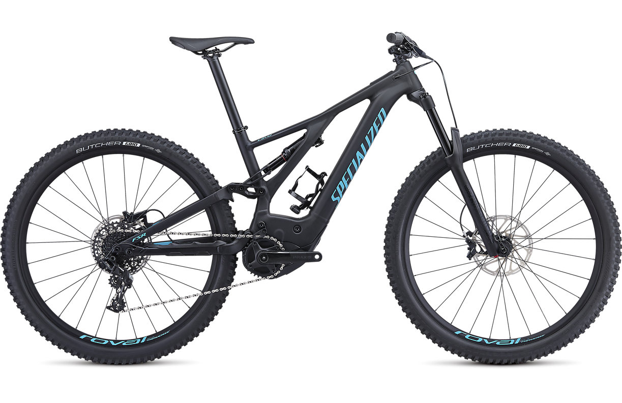

Hi guys, so it's NBD tomorrow! :cool: Super excited. First e-bike.
I'm a bit of a serial bike swapper, always interested in new bikes and tech. Afterall, it is my job!!
What i decided to do was get the base model and change up the spec to what i want, as there was no way i'm dropping £10k on an S-Works. Especially as i'm not even sure i'll keep it. :ROFLMAO: I'll be using my current bike as the donor for parts. The frame/shock are listed in the FS forum.

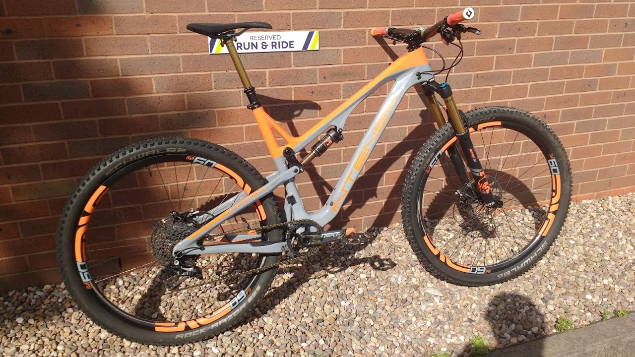

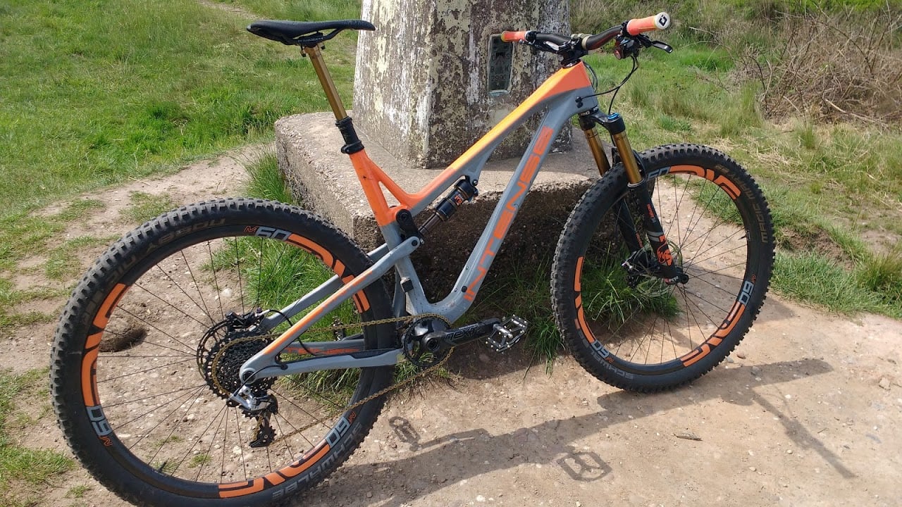

Intense Primer Factory Custom Build:
11.9kg with Pedals. Yes, i'm a weight weenie. Can't believe my next bike will probably be double that! :eek:
I built this bike using the lightest suitable parts I could get. As i ride 99% of the time at Cannock Chase, my backyard, so it's got to be able to pedal. When i first got it i felt like i was cheating it climbs that well and it's easily the best trail bike i've ridden. So why change? Knees! My knees are creaking and giving pain, so enter an ebike. I'll do anything to keep doing my brilliant job...MTB Coach.

So i've got hundreds of questions, hopefully you knowledgeable lot can help... (y) and i'll keep this thread updated with pics, spec, changes etc.
I'll kick it off with...
- Can the RF NEXT R Cranks even fit on the Levo? I've not been able to find this out anywhere.

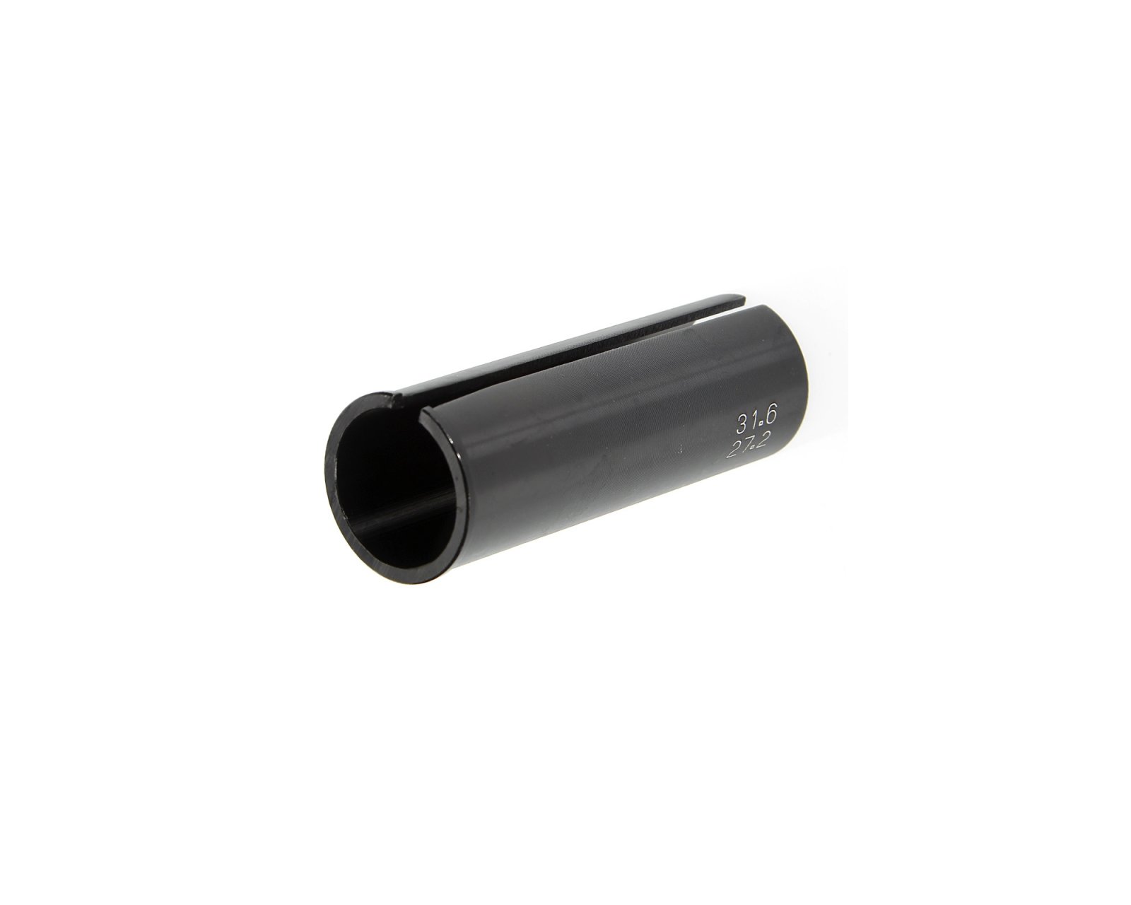

There is a pretty good chance that changing a bunch of components will invalidate your warranty, especially the seat post shim. Probably worth checking with the shop you are buying from.
dont see thats a problem specialized shim the 2018 enduros from 34.9 down to 30.9

Specialized supply a seat post shim with their Enduro carbon SWorks. It is a 30.9 to 34.9. So if they don’t have a problem with you using a shim on this bike then in theory they should not have a problem with you using a shim on your ebike. I would give them a call and state the above to see if they are okay with you using competitors 31.6 to 34.9. Or if you have to purchase a shim from them.
