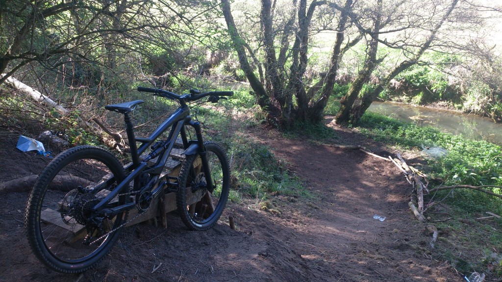

Here's a pic of it so far. Spesh Stafford (thanks Pete!) managed last minute to get the dropper fitted. It's really fiddly apparently.

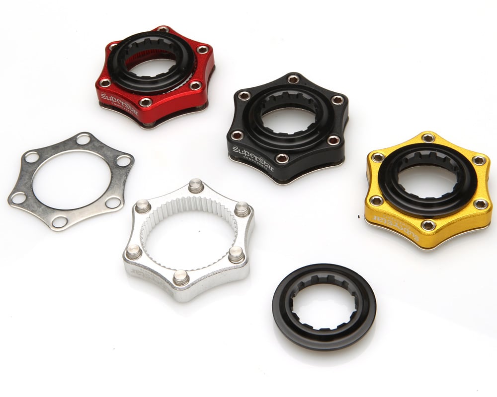

So i've decided to buy an adaptor for the current 6-bolt rotors so they fit on the dt240 hubs. That's £10 vs £80 for new 200mm CL rotors.
Was gonna order black, but i really don't like the laser etching on them. What do you guys think? Go silver (to blend in with the rotor) or black?
That's not a bad idea. I've asked Superstar for some pics of rotors with the two colours attached. Not holding my breath, so let's see.

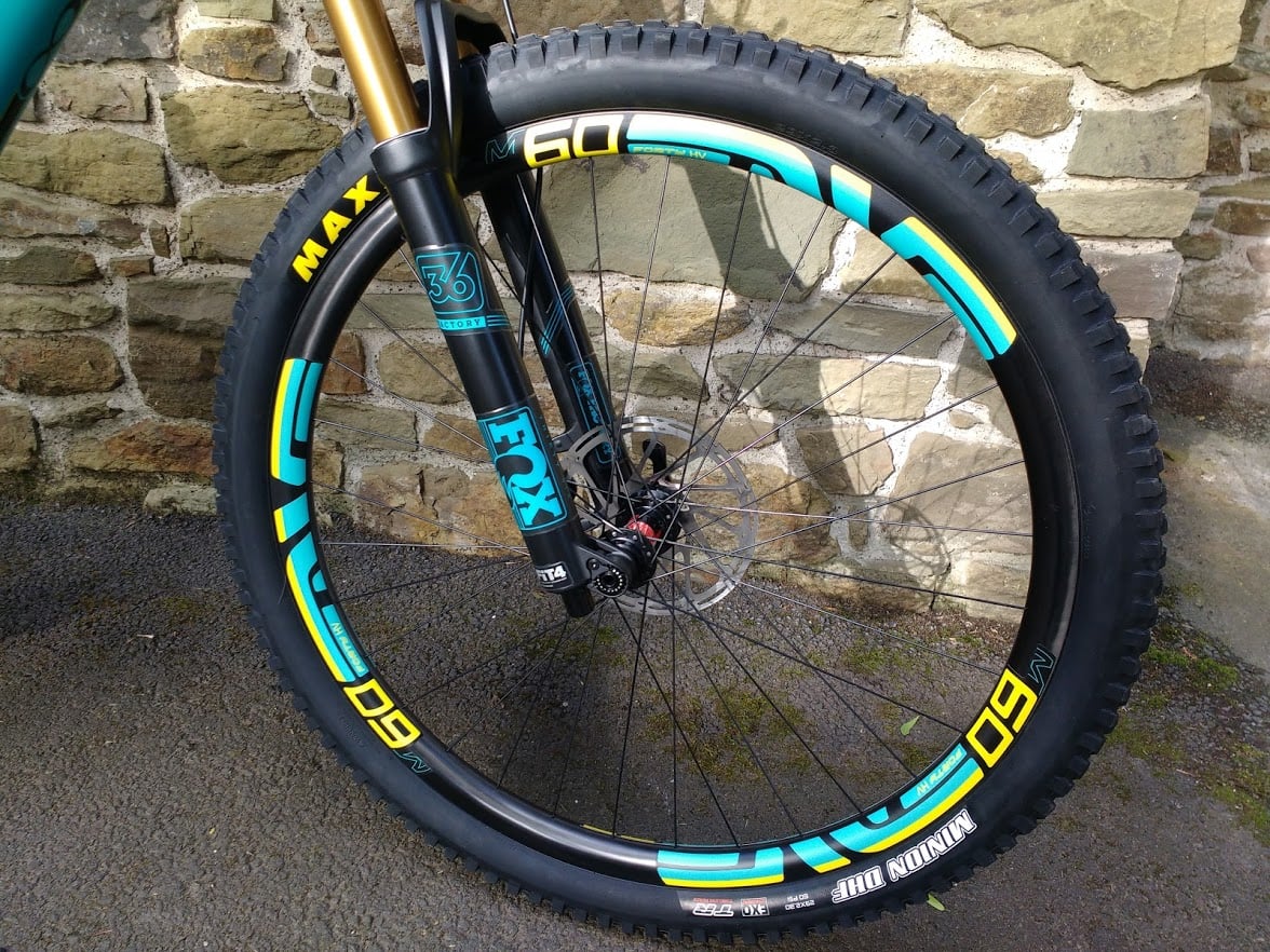

Being a black bike, i want to run stealth again like my old enduro. I've had a few "shouty" bikes in a row. Just deciding on decals for the enve...
Stealth:

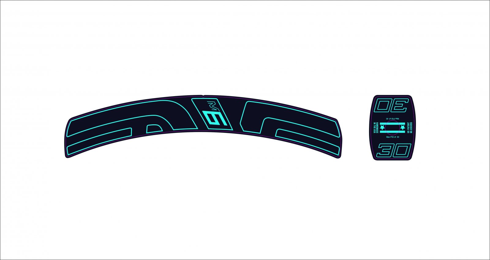

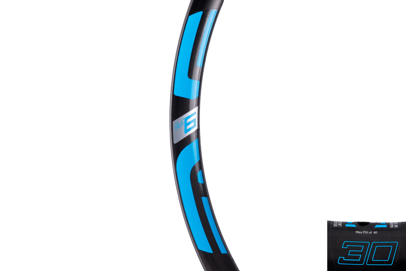

Louder:
Your could get the envi decals with a dark grey pinstrip for even more stealth. Where are you getting yours done? A lot of people at Spokes get theres done by merge decals and you can get whatever colour or design you want on them.
I'm not sure i'm allowed to say. When i had the Yeti ones done they told me not to broadcast, because Enve were frowning against it. That's 2yr ago, i'll ask them if it's cool and spill the beans if it's ok. Stroll on Friday!!
No probs, Didnt know there was any problem as we have been having custom decals made for a ages now and merge have never said anything about not broadcasting it. One of the riders even gets pre-production wheels sent to him by envi for testing purposes and he has the custom decals done.

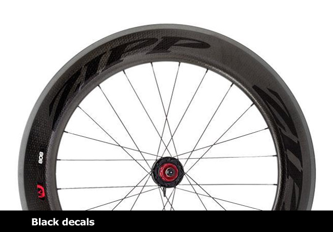

Can you do them like the stealth out Zipps?
Now that's bat man Stealth. I can't rid the blue off the bike, so it's not super Stealth. After the yeti and intense I could have gold logos and be considered more Stealth
