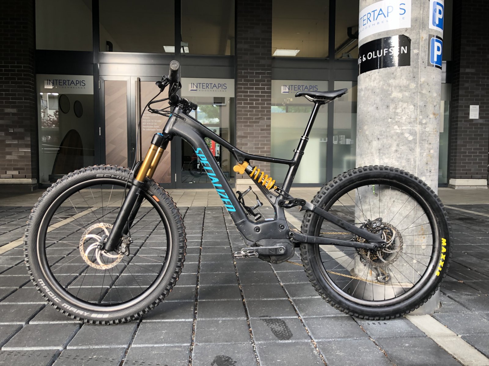

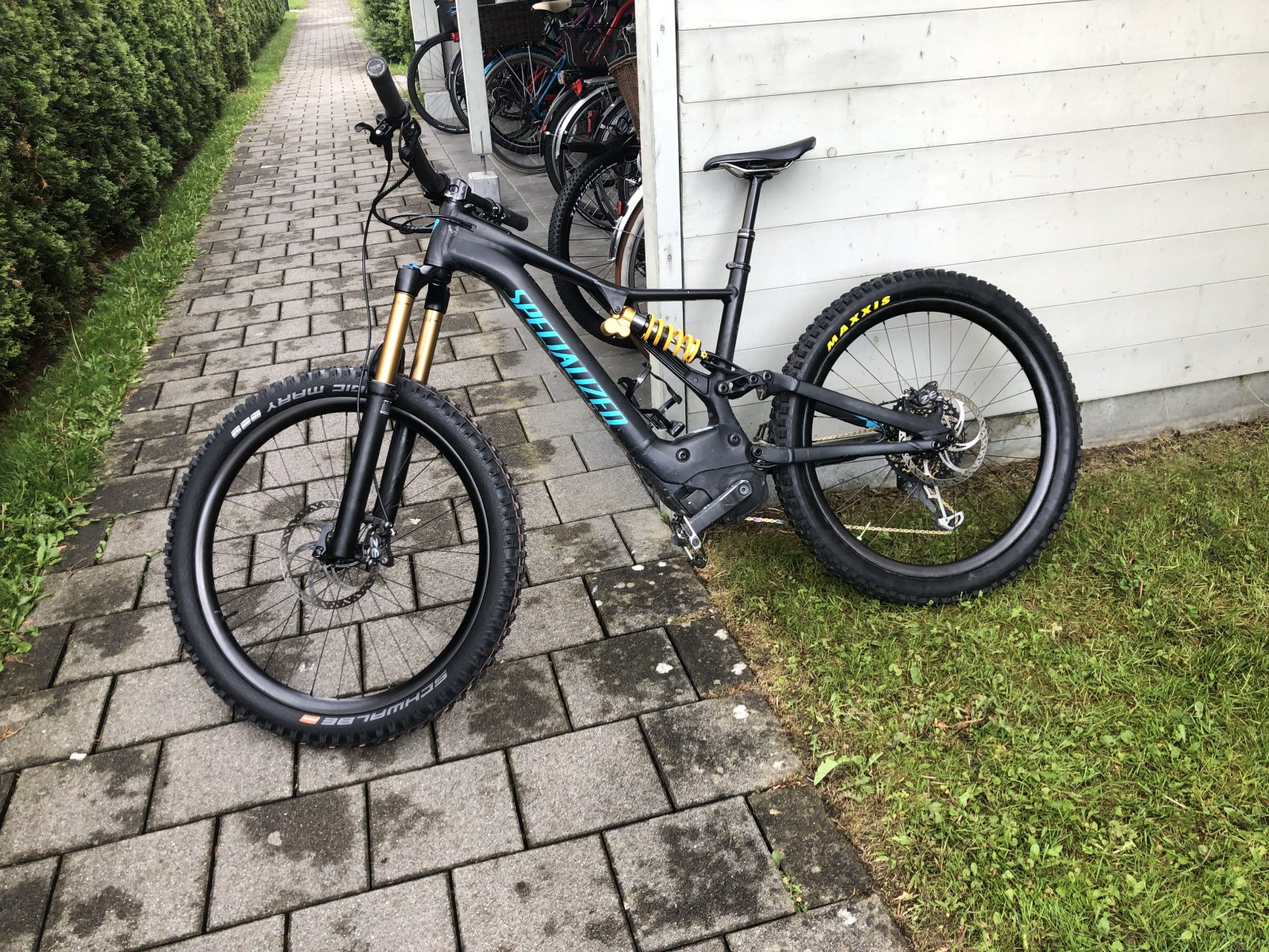

I have put my 27,5 on my 2019 Levo. I run the 2.6 Butcher in front and 2,6 Purgatory in the back. These tires because I haven´t shifted theme since they were on the rims from my original bike. What I found out was where I ride even the tiny pattern of Purgatory in 2.6 work just fine when it comes to grip. Would like a more precise cornering tire though, but still...I ordered 2.6 Maxxis DHF and DHR in 27,5 now which I belive will be plenty of grip and better when it comes to cornering. The BB hight comes in around 330mm(3mm higher than Stuntjumper EVO) now in the low setting. The frontend feels a little bit low so ordered a 160mm air shaft to the front end to raise it up a bit. I think the bike would be fantastic with "normal" 27,5 wheels with 170mm up front....The handling is 10 times quicker and more fun than the 29". The low BB is just noticeable on a slow step down but works great on slow step ups when it comes to hitting the motor and battery...You also need to plan a little bit more where to paddle for not hitting your krank arms but I really prefer that than a high BB

have now install, front and rear 27.5 wheels 35mm inner wide and 2.8 tires. BB drop 34.5cm flip chip high and a fox 36 160mm. booth wheels with cushcore.
test ride is tomorrow.

Hi, I don’t know if you can call 2,6 for +tires any more it seems to be pretty standard these days, I guess 2.8 it starts to be pluss. What ever… actually I’ve changed back to 29 but that is because that I had an order of Cush Core on 29 before I changed it to 27 and wanted to try it out. Now I run 18 psi in the rear and 15 in the front!!(I weight 68kg, 172cm) which just opt for an insane roll ability over obstacles. I think I will stick to this set up for a while since where I live its more downcountry terrain with huge obstacles and for sure bigger wheels is normally the way to go here, I even see small kids roll around with 29 here. I do still think the handling was really good with the 27 on…Trying out the cush core was also a game changer in the suspension feel and stability of the tires. Will never ride without again on an e-bike.
It so many ways you can ride your e-bike…I see you live in the Thun area, lucky you! That is an insanely beautiful area:) I guess you use your e-bike more like an shuttle machine?? I live in Oslo and we don’t have that steep and long terrain here but its rough and fun and goes up and down all the time:) I would definitely go the smaller wheels and a longer fork(air piston) if I lived where you live, though I haven’t tried the longer fork yet…Its nice with the low BB going down hill:) I don’t think I will ever put larger than 2.6 on my bike 27 or 29…It also gets lighter with the smaller wheels which helps the machine to slow down easier which is constant battle in the steep Alps. Normally you get more traction with more rubber to the ground but I don’t think its an problem on e-bikes going downhill so much, its more on technical uphills. I also see more new e-bikes coming speced with 2.6 instead of 2.8 which was the norm before…
