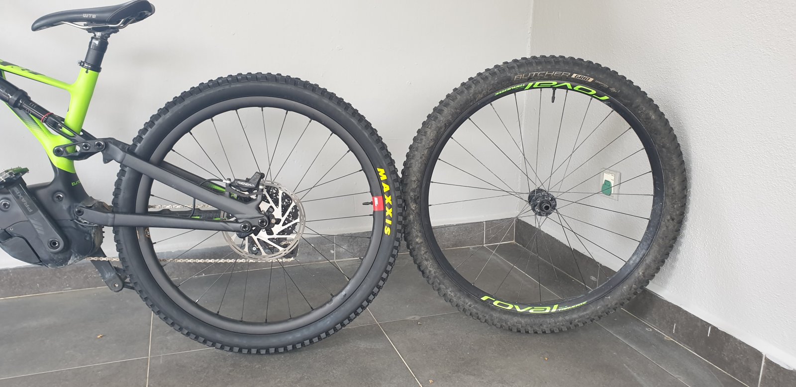

HI all, I just swapped out my 29" wheels for some 27.5" Hope Fortus 30s with the same Butcher Grid 2.6 tyres as were on the original wheels. For me, a 5'6" woman on a women's medium Levo FSR, it has made the world of difference to handling (so much more agile, steering feels much more direct) and there's a happy little payoff in terms of standover height too. I'm so glad I made the change! Anyone looking for a set of Roval 29" wheels?? ;)

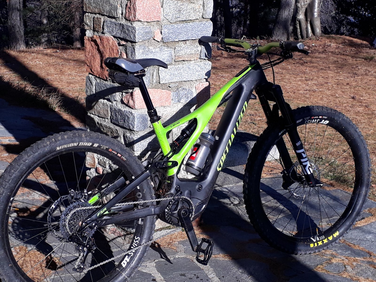

Wife's was built up with 27.5" DT Swiss XM521 (35mm inner) wheelset and 2.8" Minions. And a 170mm Fox 36 with the Push Coil conversion. At her shorter height, 29" wheels just don't ride as well. The bike has absolutely zero problems being run this way. She'll outdescend 99% of the riders. Biggest problem with the small frame is lack of full seat tube. Had to BikeYoke Revive 160mm we bought for her because it wouldn't drop down far enough into the frame. On a OneUp Dropper now, which works but is waaaaay less awesome.

Im on Santa Cruz Reserve, with DHF 2.5/DHR 2.4, pic shows original butcher 29ner

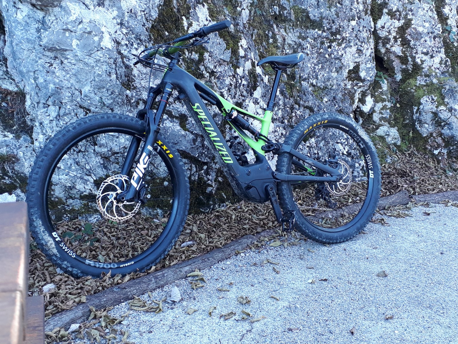

I have put my 27,5 on my 2019 Levo. I run the 2.6 Butcher in front and 2,6 Purgatory in the back. These tires because I haven´t shifted theme since they were on the rims from my original bike. What I found out was where I ride even the tiny pattern of Purgatory in 2.6 work just fine when it comes to grip. Would like a more precise cornering tire though, but still...I ordered 2.6 Maxxis DHF and DHR in 27,5 now which I belive will be plenty of grip and better when it comes to cornering. The BB hight comes in around 330mm(3mm higher than Stuntjumper EVO) now in the low setting. The frontend feels a little bit low so ordered a 160mm air shaft to the front end to raise it up a bit. I think the bike would be fantastic with "normal" 27,5 wheels with 170mm up front....The handling is 10 times quicker and more fun than the 29". The low BB is just noticeable on a slow step down but works great on slow step ups when it comes to hitting the motor and battery...You also need to plan a little bit more where to paddle for not hitting your krank arms but I really prefer that than a high BB

My Levo 2019 27.5
