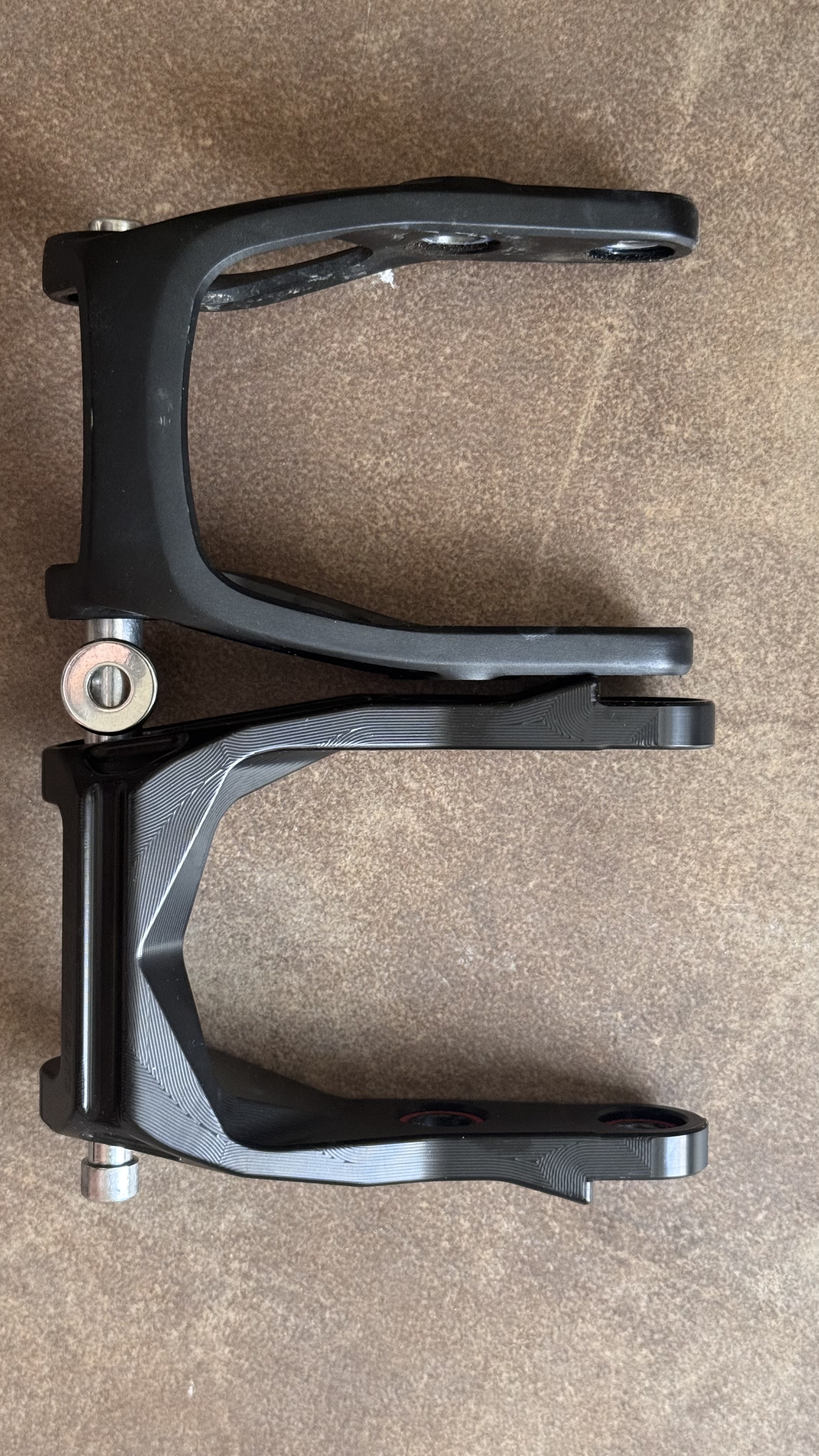

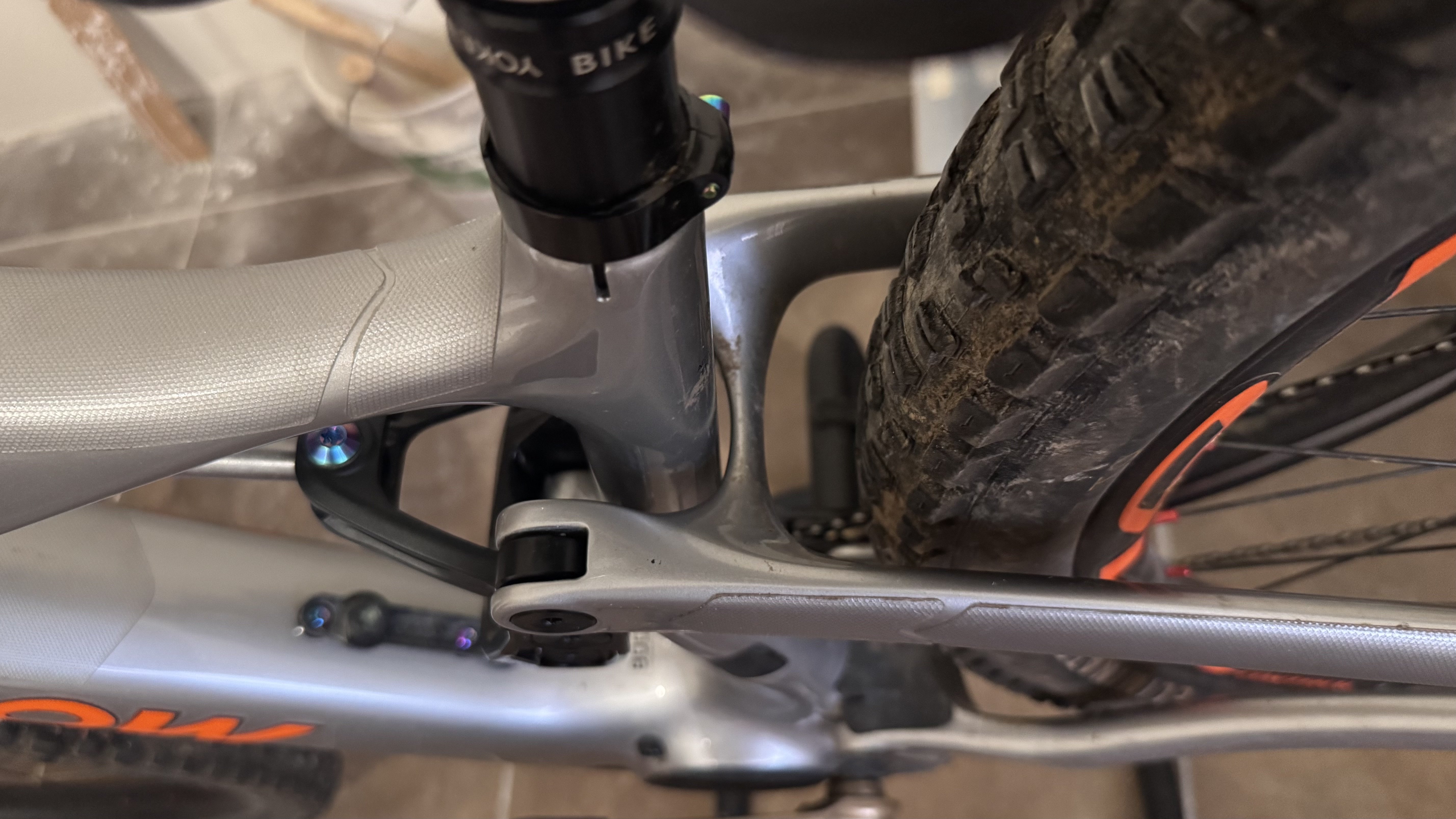

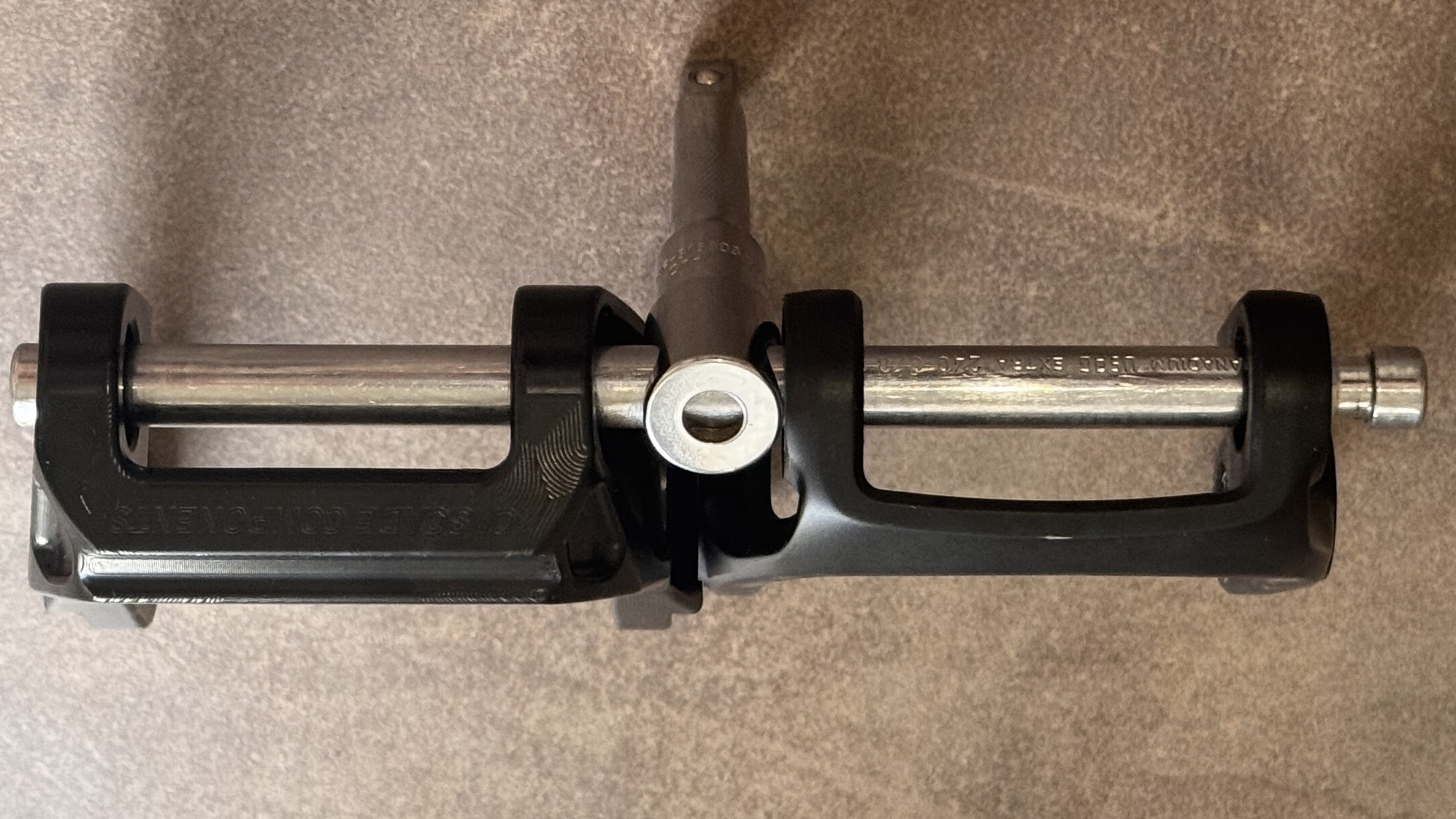

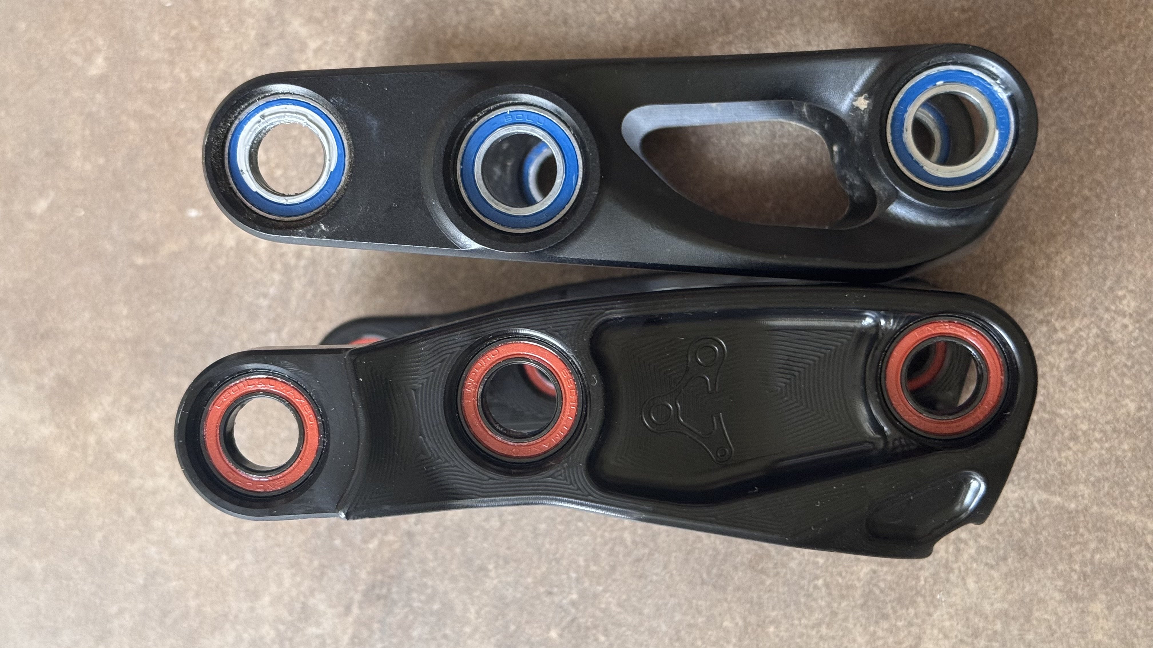

Received Cascade link today.
Some pictures just for comparison between original and new one. I’ve tried the “29”” setting just to verify if there is some interference at full stroke (135mm full compressed shock length) and it seems to be fine. The only downside is that with this setting and with a 170mm fork the head angle goes down to 62,3 so I ended up going for 27,5” setting (63 degrees)

Different story here: to obtain exactly the same sag (30%) I’ve raised the pressure of just 10 psi (from 245 to 255)
Regarding the head tube angle there is a mistake due to having taken the misure in a rush. The actual ones are 63,5 in 29” setting and 64 in 27,5” setting. Mullet set-up

Isn't the stock shock 185x55 which would mean 130mm compressed length not 135mm?
