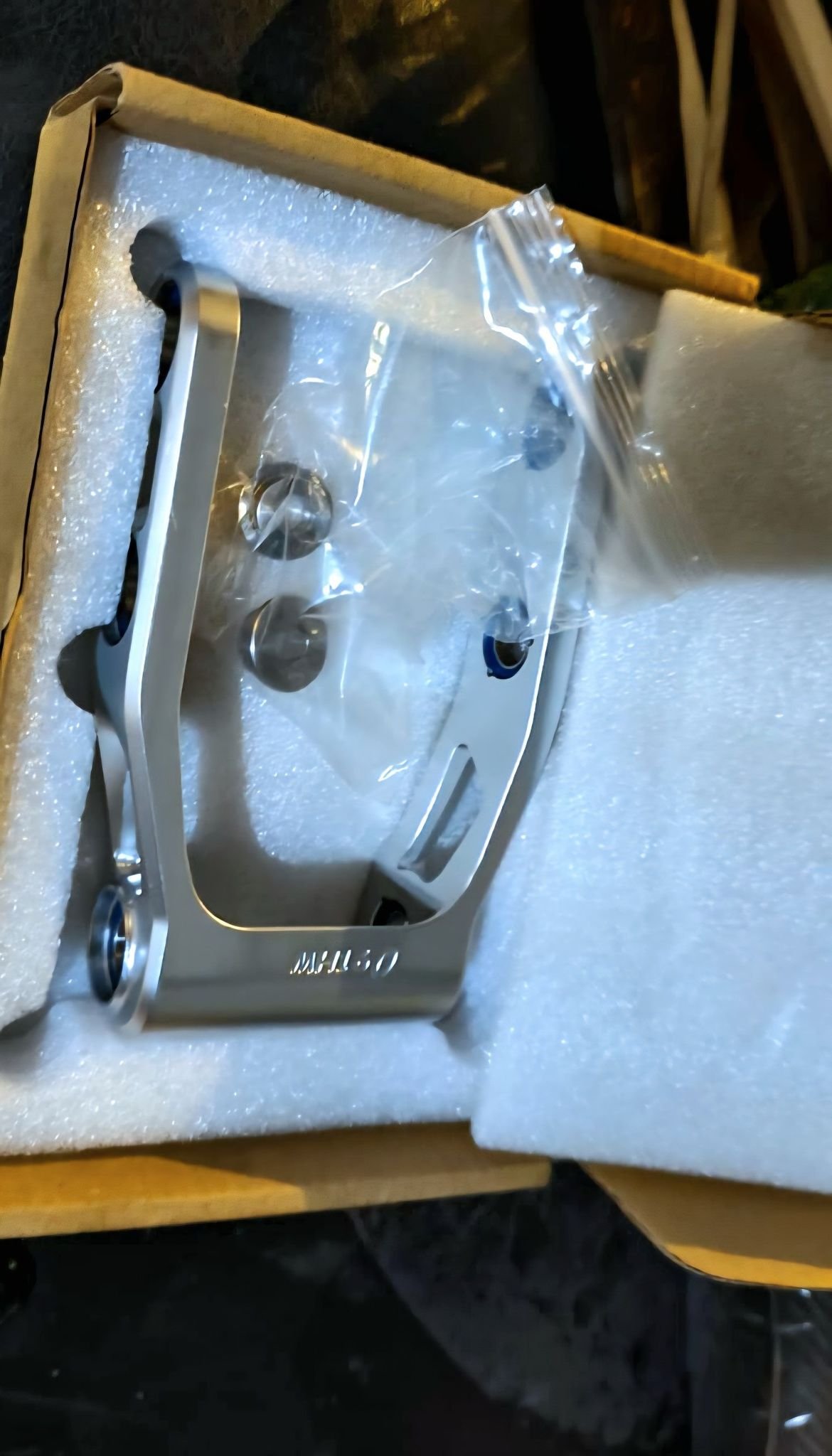

A Guy offers this linkage 160mm for amflow. It is total custom made. You find him on FB
Did someone order it ?

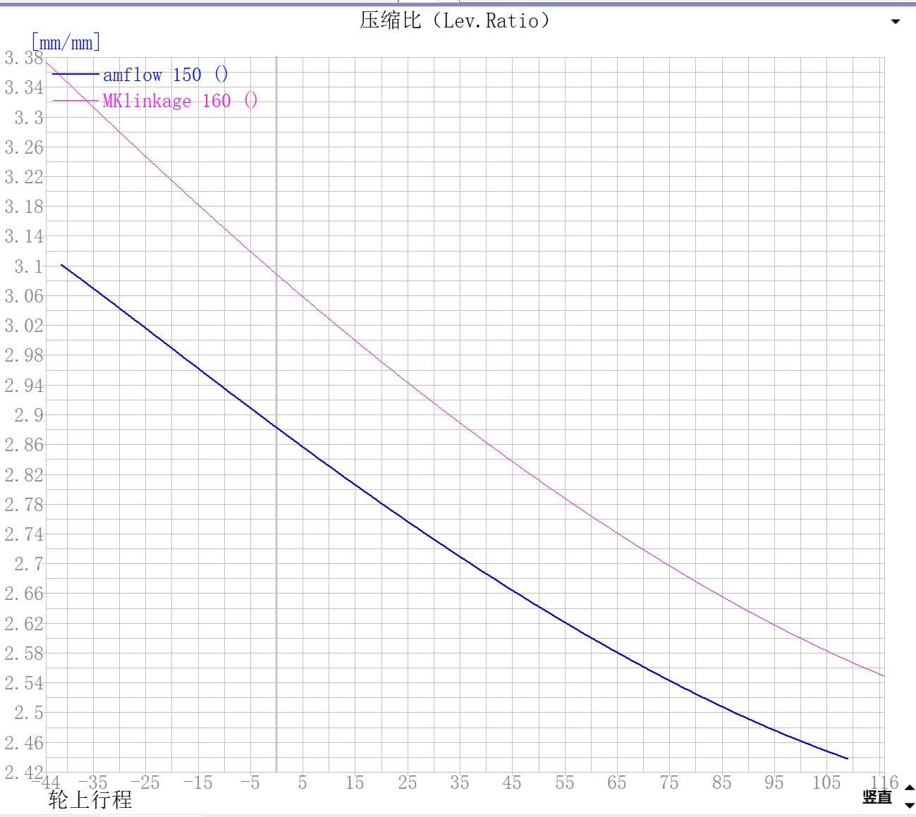

Just an update for everyone interested in the Amflow extender link, thank you all for the overwhelming response. Here I will try to give everyone more information about this product.
• The linkage is made by a new company called 'Velo Dynasty' who are a new bike components company (they are so new that they dont even have a website yet).
• The Linkage will cost USD$290 (previously this price stated does not include shipping BUT it will now include shipping to certain countries). Price of shipping wil be put to a minimum and for Tax reasons it will be labelled as a xmas gift or let us know what you would like it to be shipped as. The link will be shipped by tracked shipping that will need to be signed for when delivered.
• The linkage seen on the photos that I have is a prototype and is silver colour. All shipped linkages will be in BLACK colour which is same as the original linkage. A SPECIAL LIMITED EDITION (FOX KASHIMA) colour will be available only during this Xmas holiday period at a little extra price. • Early orders for Xmas will also recieve a special 'GIFT' included in the package sent.
• The extended linkage will increase the travel by 10mm (from 150mm to 160mm) and will increase the progression of the stroke which will be great for small bumps in the initial compression then stiffer towards the end of the travel to combat bottoming out.
• This extended linkage is a straight swap for the original linkage and will NOT need a new shock to achieve this desired result.
• Bike geometry is practicaly the same for the whole bike including bottom bracket height etc. (there may be discrepancies of a few millimetres here and there)
• These linkages will be shipped out in 20 days time, ready for Xmas! I have tried and tested the prototype linkage and the first feeling I got was it is definately noticable right away when I climbed up the mountain as the traction was way more and felt less harsh on the loose rocks. Then came the downhill. With the 10mm extra travel it felt like it had more than that, the rear wheel was following the ground way better and even on stairs the feeling was less harsh taking away the edge on each bump. Basically the easiest way to explain is that this is the 10mm that Amflow needed to complete the perfect package of this already near perfect bike. I would go as far as to saying that this linkage turns this ebike from an All Mountain short travel ebike to an All Mountain/Enduro Ebike. *Extra Info: I directly swapped both linkages over, used the same shock, didnt change the air presure or change any of the settings on the shock or bike at all and my shock was the stock Amflow shock that came on the Black Amflow. If you are still interested to purchase this product please reply and I will send you a Google link to fill out. All payments will be made by Paypal to secure the transaction and protect buyer and seller. Fist batch will be shipped out in 20 days time. 2nd batch buyers will have to wait untill 2026 and no special colour, only black. I will send a Youtube Link for the test video later.

Isn't internet great with everyone and their grandmother claiming to be experts in everything?
No graphs on progression, no data whatsoever, "a few mm here and there". Yeah, that's a exactly a credible info we'd like to see.

Comment wasn't direct at you, but at the linkage. I saw same post on FB, made in China with lots of claims.
Purpose of the reply is to think critically and read between the lines for all claims being made.

Amflow is a very light frame, It's designed for mild trail riding not hardcore enduro riding.
Slapping a 160mm link on it and riding it like an enduro bike will lead to increased flex, load and potential failure.
This link will likely void any frame warrantee also... Its a bad idea!
If you want an enduro bike, go and buy one.
