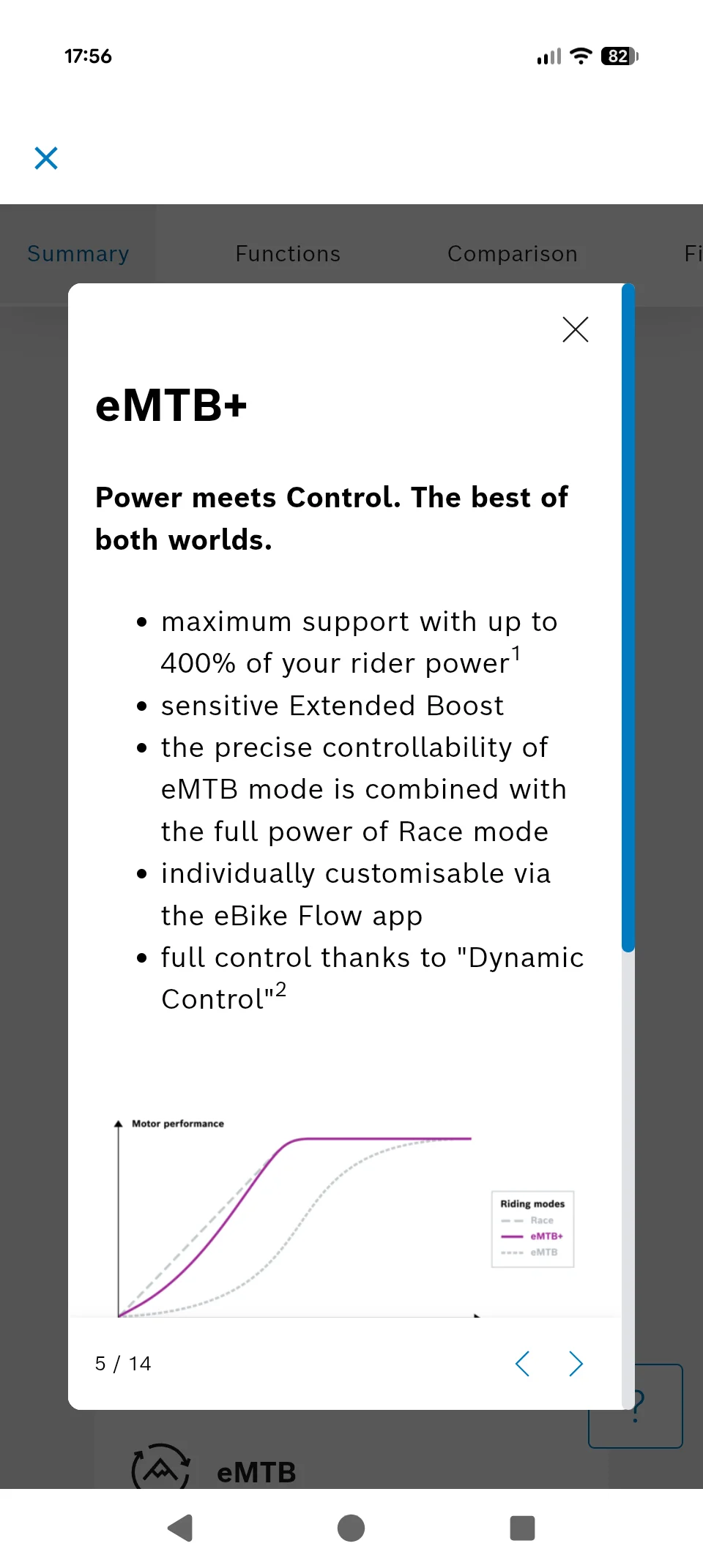

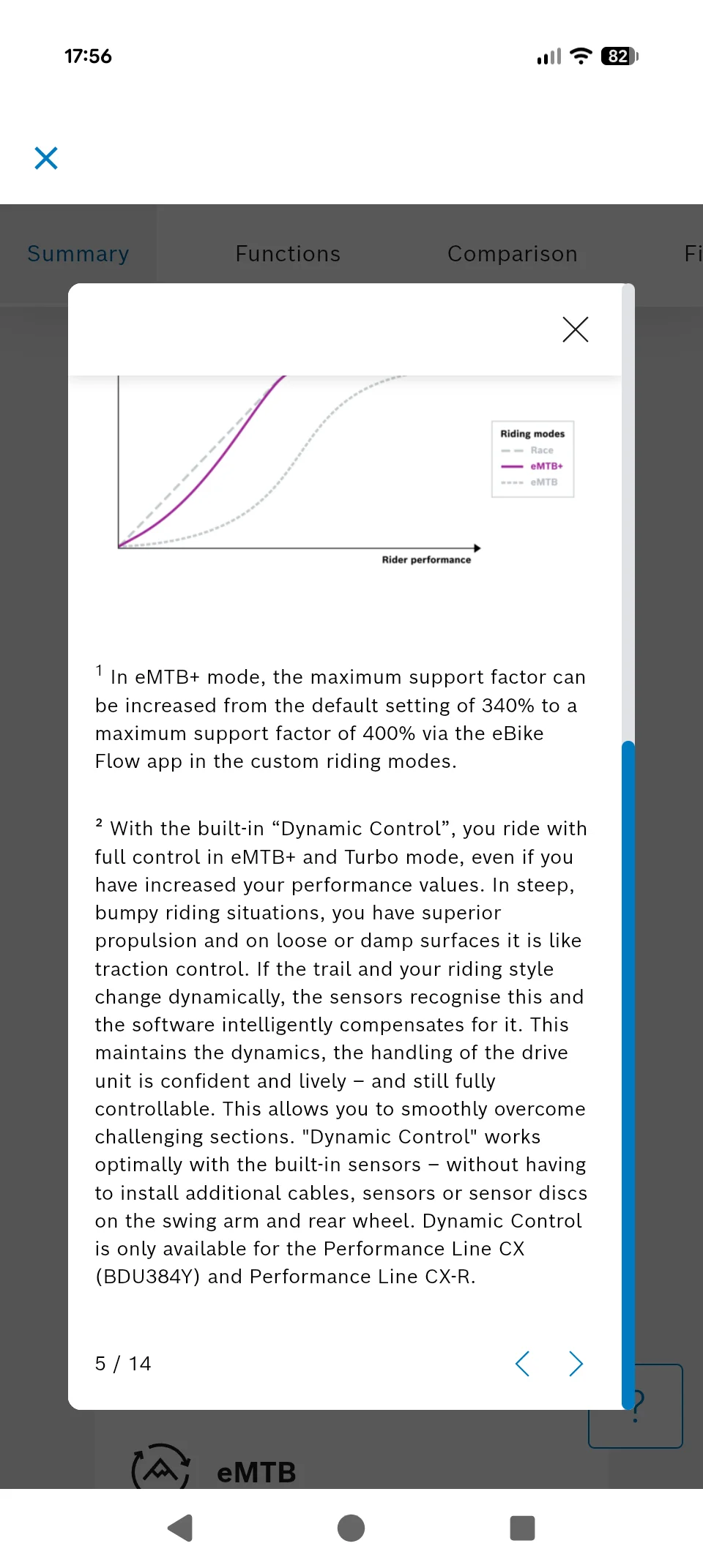

In relation to previous I think it was 340% that you could use the slider on assistance to bring it up to 400%.

So you are saying prior the update when eMTB+ was 400% max and i left it at 0 i was getting 300% instead?
340% to be exact. All in all Bosch scale for support % is confusing to say the least. If 0 is 340 and +5 is 600 then:
600-340=260 (difference between 0 and +5)
260/5 (5 steps from 0 to 5) = 52% in a single increment.
That would indicate that a single increment is 52% which would make +2 = 444%
And that is just for EMTB+. If you take other modes eg Tour+/EMTB then +5 is still 400% which makes the single increment 12%
So it's either this or the entire scale is not linear not to mention that if you go down the scale you can't really be sure if goes down to 0% or something else.
Your assuming its linear and it doesn't have to be... the only thing its needs is to provide more support the higher the number for it to make sense.
Hence a comment from the CEO made about feedback from testers/consumers... wanted "clearer" parameters and what the settings actually mean vs. arbitrary settings.
