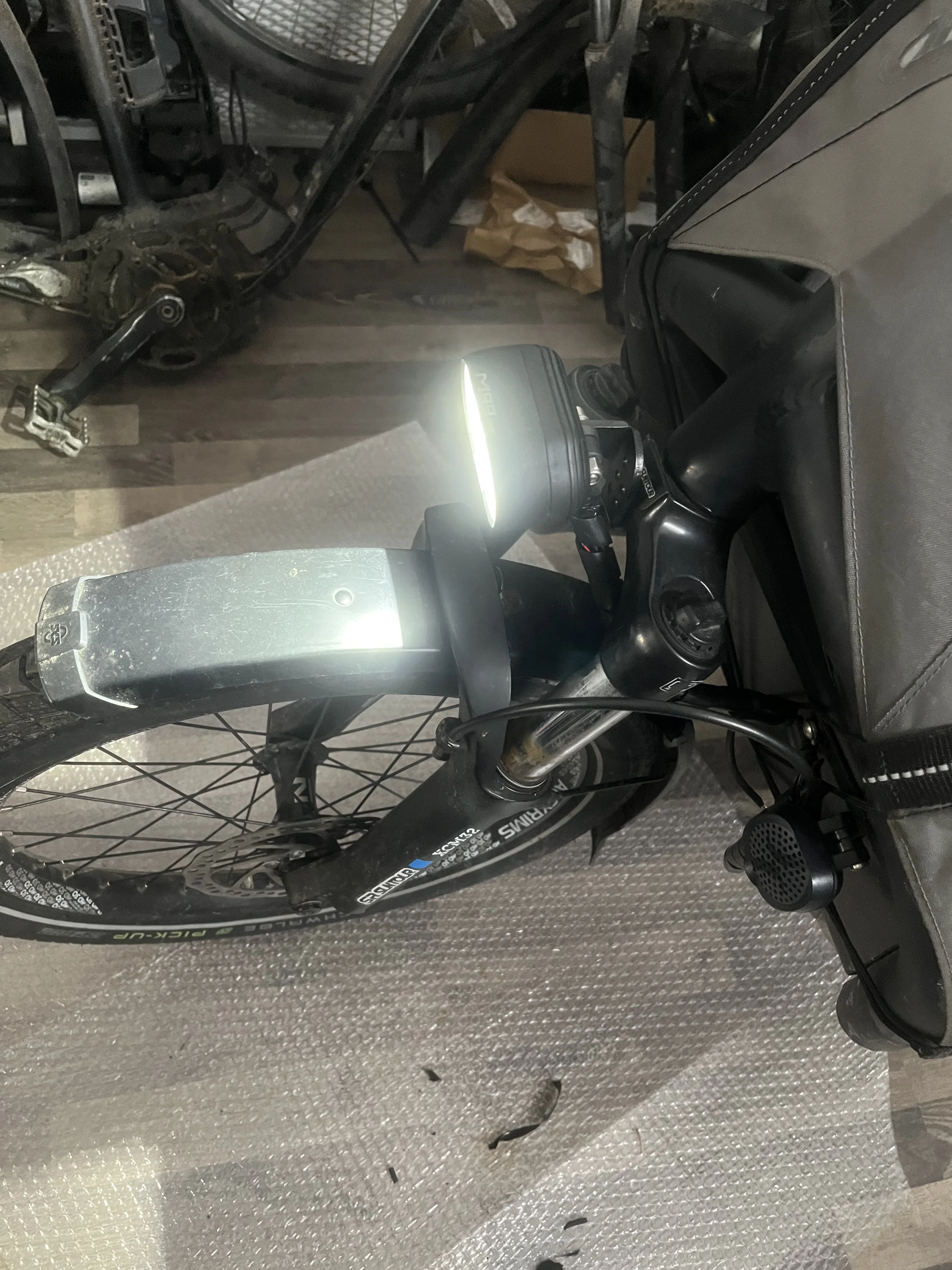

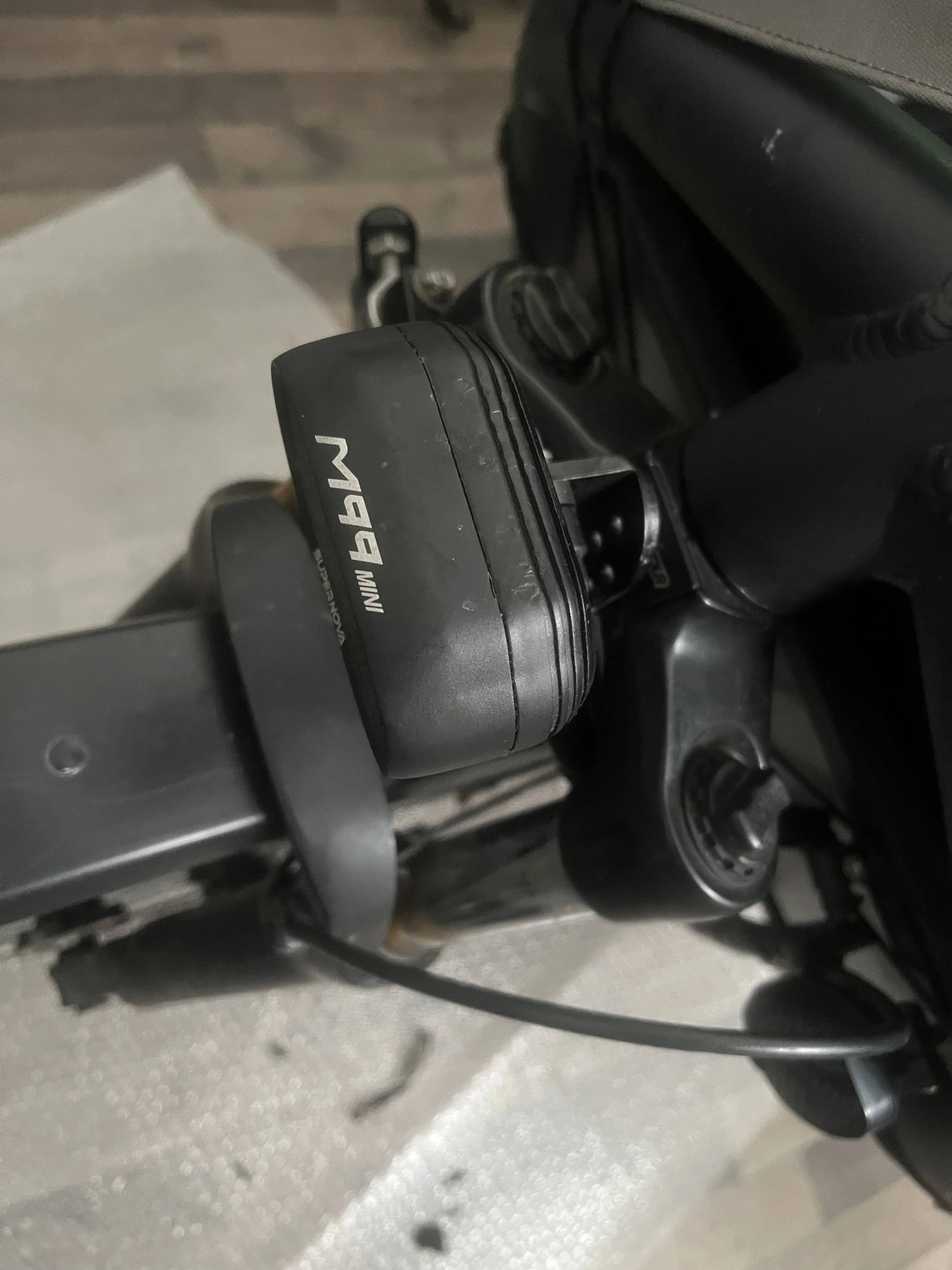

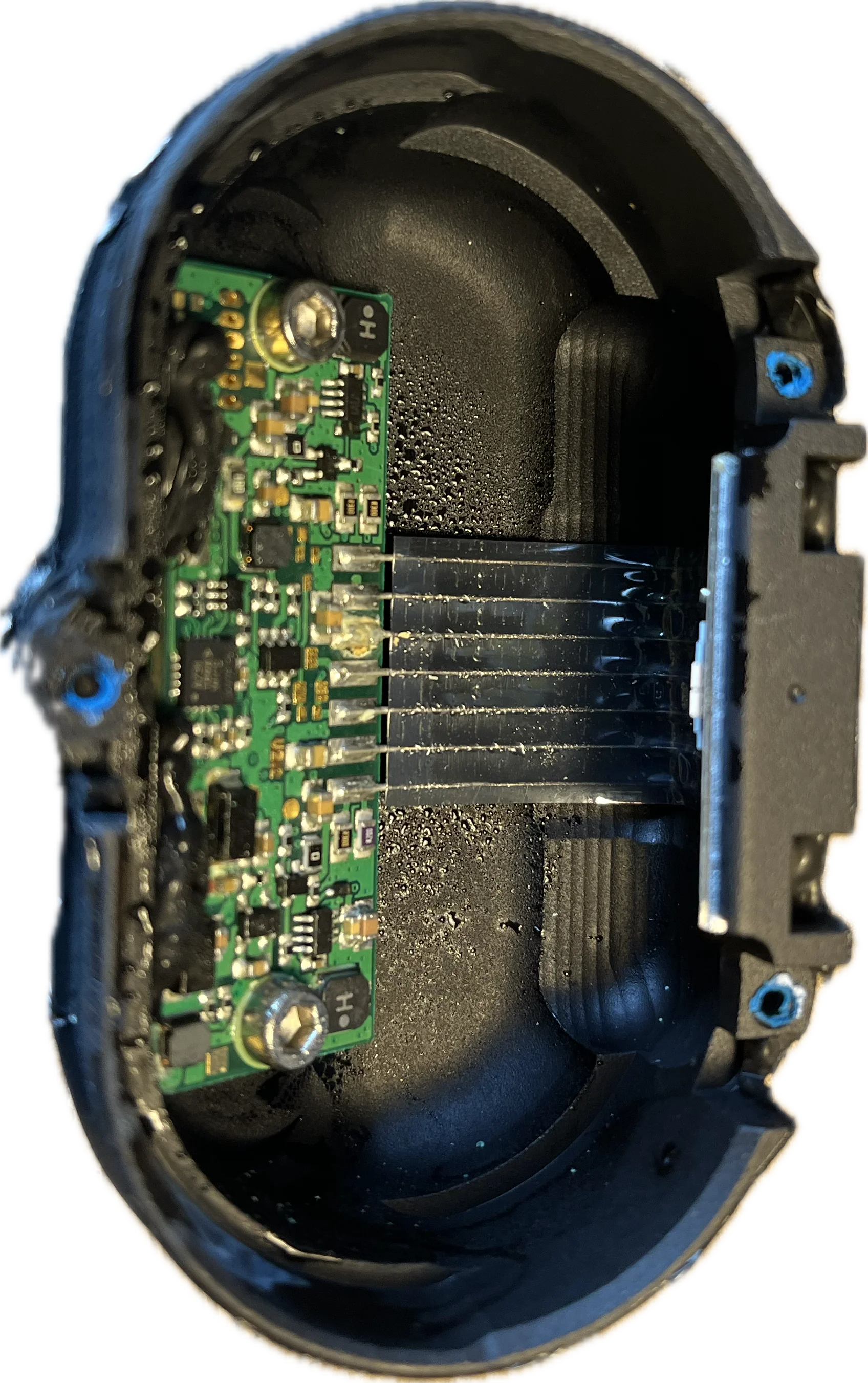

Last thing I repaired that annoyed me as F&(k was a Supernova M99 mini ebike light. What do you think the problem was? Water inside... a 250Eur sealed bike headlight that is not meant to be opened!!! 2 piece aluminum glued together with some hard silicone on plenty of contact surface. You don't want to know how much time I spent opening this marvel without completely destroy it in the process. Really, I got lucky.
In any case, I managed to repair it in the end, the whole thing took longer than expected (5 hours I think), including PCB repair and case reassembly/sealing. But, I'm not going to do this again :-)

View attachment 179187View attachment 179188
I have a Supernova like that one, I don't ride on rainy days, nor leave the bike outside, but, would you, by any chance have any advice on how to prevent that water ingress?
Not cheap, and wouldn't like to throw away a light in the future.
Thank you!
