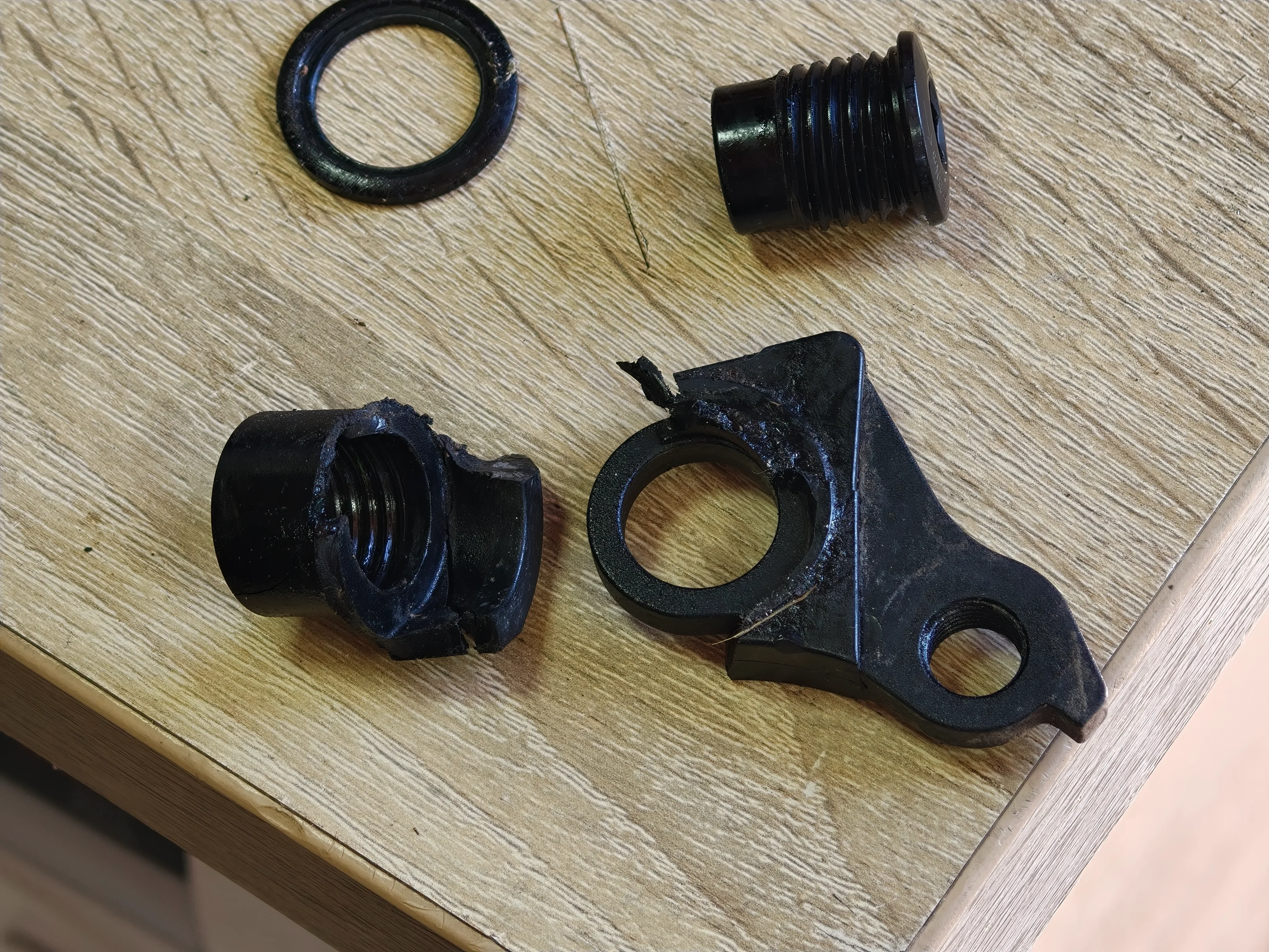

CEF69 isn't even 1 year old. Hard that he's been using it for 2 years, I dont believe it's a cef69
Plastic UDH should be prohibited. Dangerous, waste a lot of time, savings they are making on it is laughable.
Do not bother of fitting it, get the proper one.
