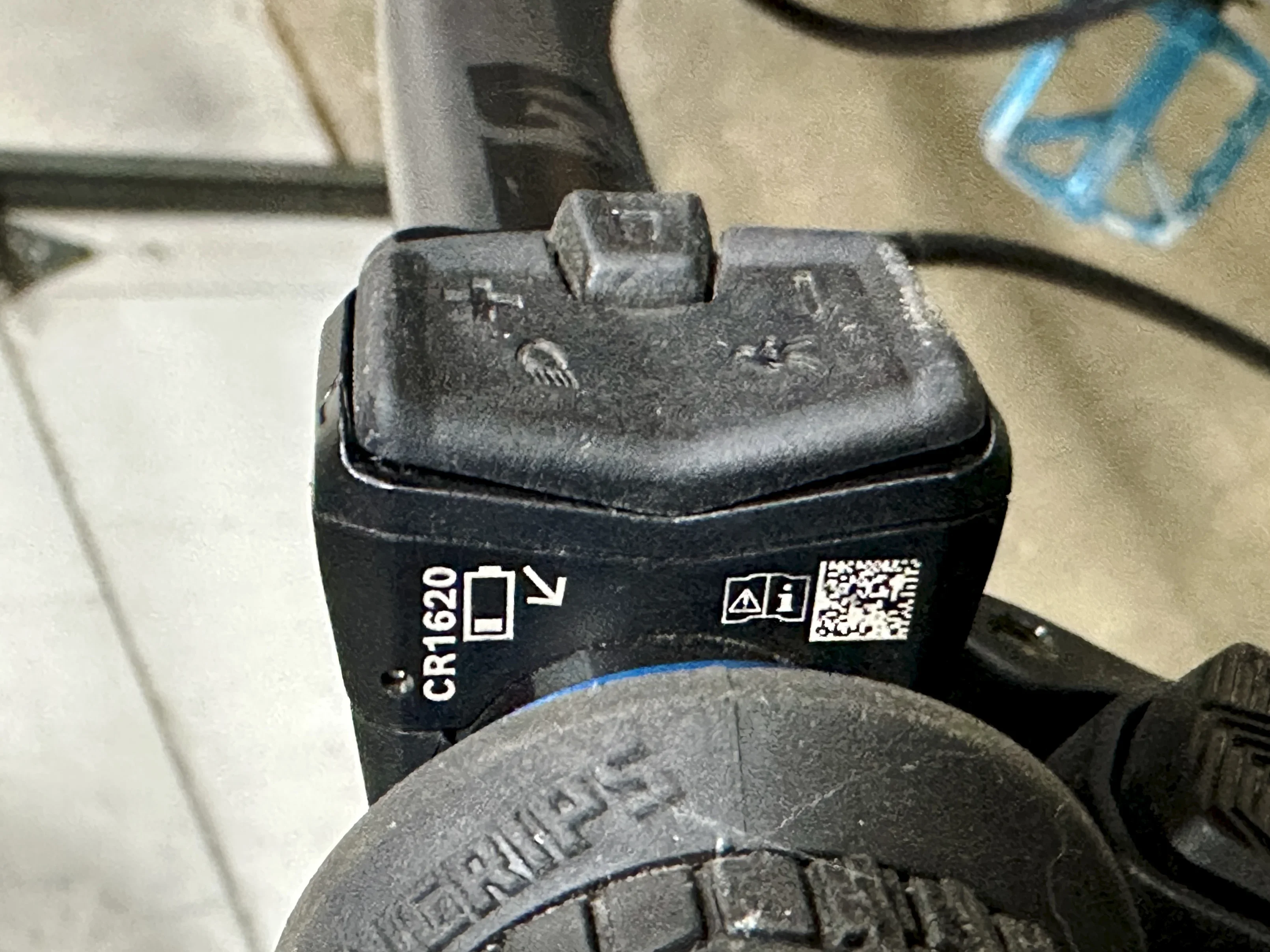

I still don't see any soft rubber (cover or rectangular thing). See my pic. Have I got something missing?
Oh, Mister Euro-Exclusive fancy bike-parts man. Yours looks like hard plastic, not the soft floppy parts they pawn off on us unsuspecting Yanks as they pick our pockets with maximum markup.
Check out the attached pic of mine. A clue is the bottom of the V shape. Yours has a little cutout. Mine does not. Mine is soft enough where I can push into it with a fingernail. If I depress one side so it's "fully clicked," I can also press down the other side. It's that flexible. I'm glad to see that Bosch has improved one aspect of the switch.
