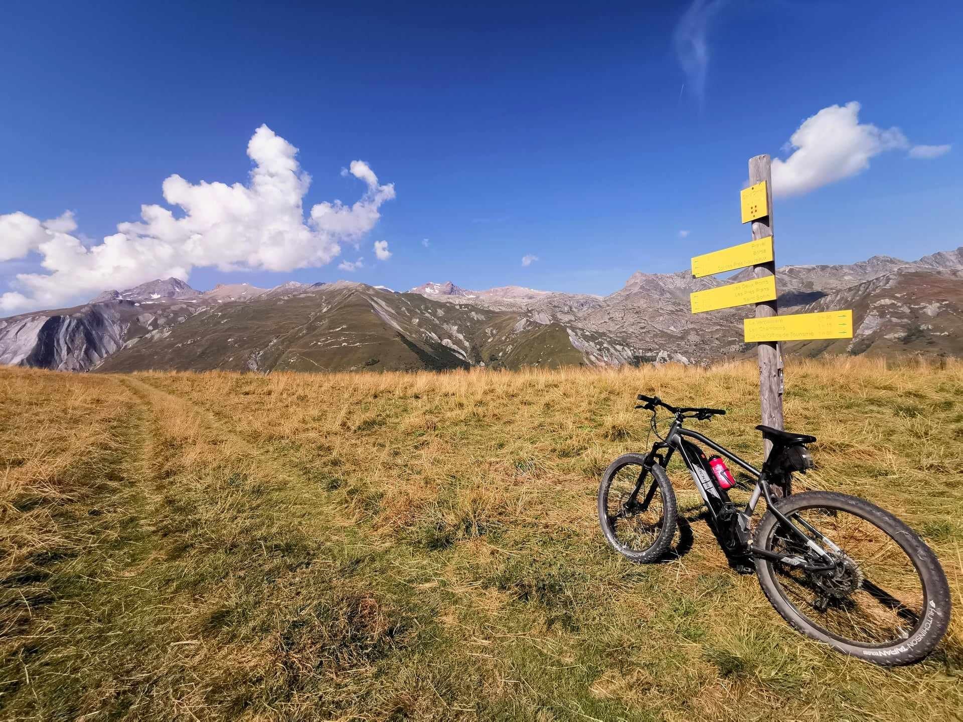

Hello all
I joined this site last year as I was looking at buying an EST 900 for my Wife.
I bit the bullet and bought one, then bought another for me!
I've seen posts about the bottle mounting (what were they thinking?!?) so thought I'd share my solution.
I bought a generic mounting base from amazon. I then removed the straps from it and cable tied it to the battery.
I can't seem to share the link here, but have it if anyone is interested.
I've been running it like this for a while now with no issues.
I thought it would move around a lot but it's been good as gold.
I live in the French Alps, so the bike sees a lot of very bumpy trails, and all good.
The pic is from this mornings ride :cool:
Hope this helps people
