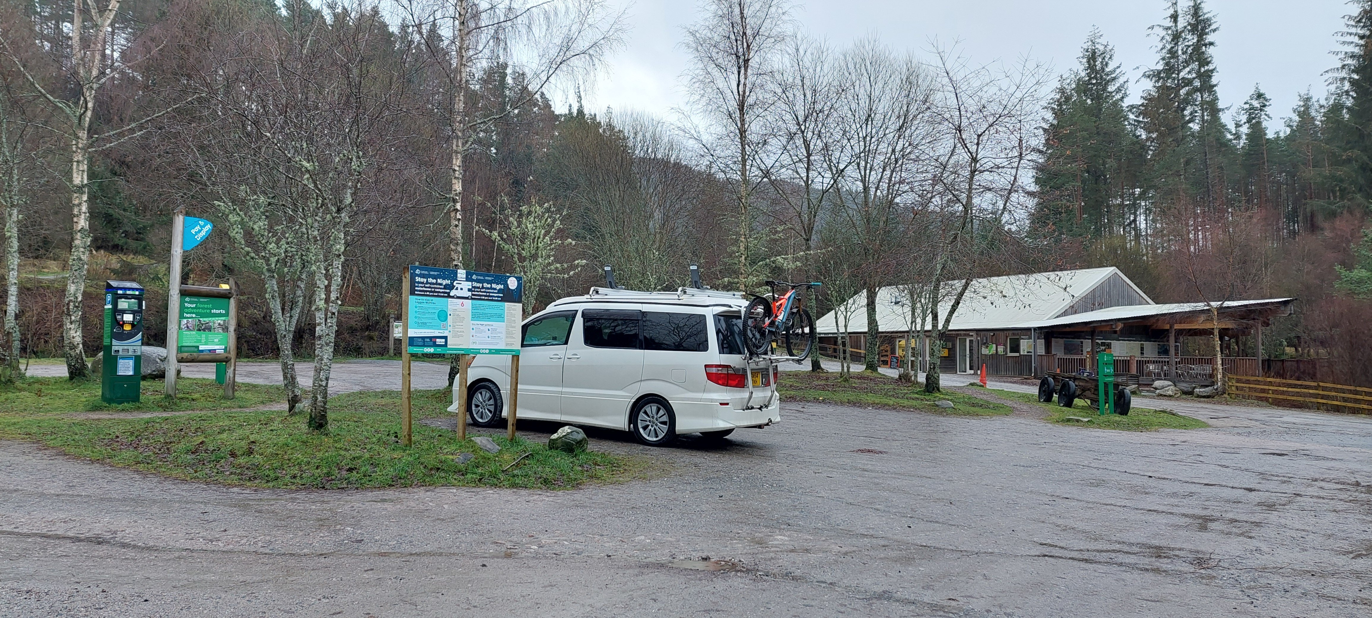

Laggan Wolftrax today arrived 11 am no one there . Cafe lad turned up 10 minutes later. Near the top met the lad who designed and maintains the trail clearing a few trees that had fallen across trail. Did two runs then back to van still nobody there cafe shut ten minutes later. £4 parking fee for day was all they made , that's not much profit. Took one look at Ayres rock and thought that looks steeper than summer when i did it 0, and on my own was the only excuses I needed not to do it. 20 years old this trail . I had a Xmas meal at 4 pm to go to at Kingussie with my walking club . I definitely made the best choice cycling the hill walking was horrible they said .
