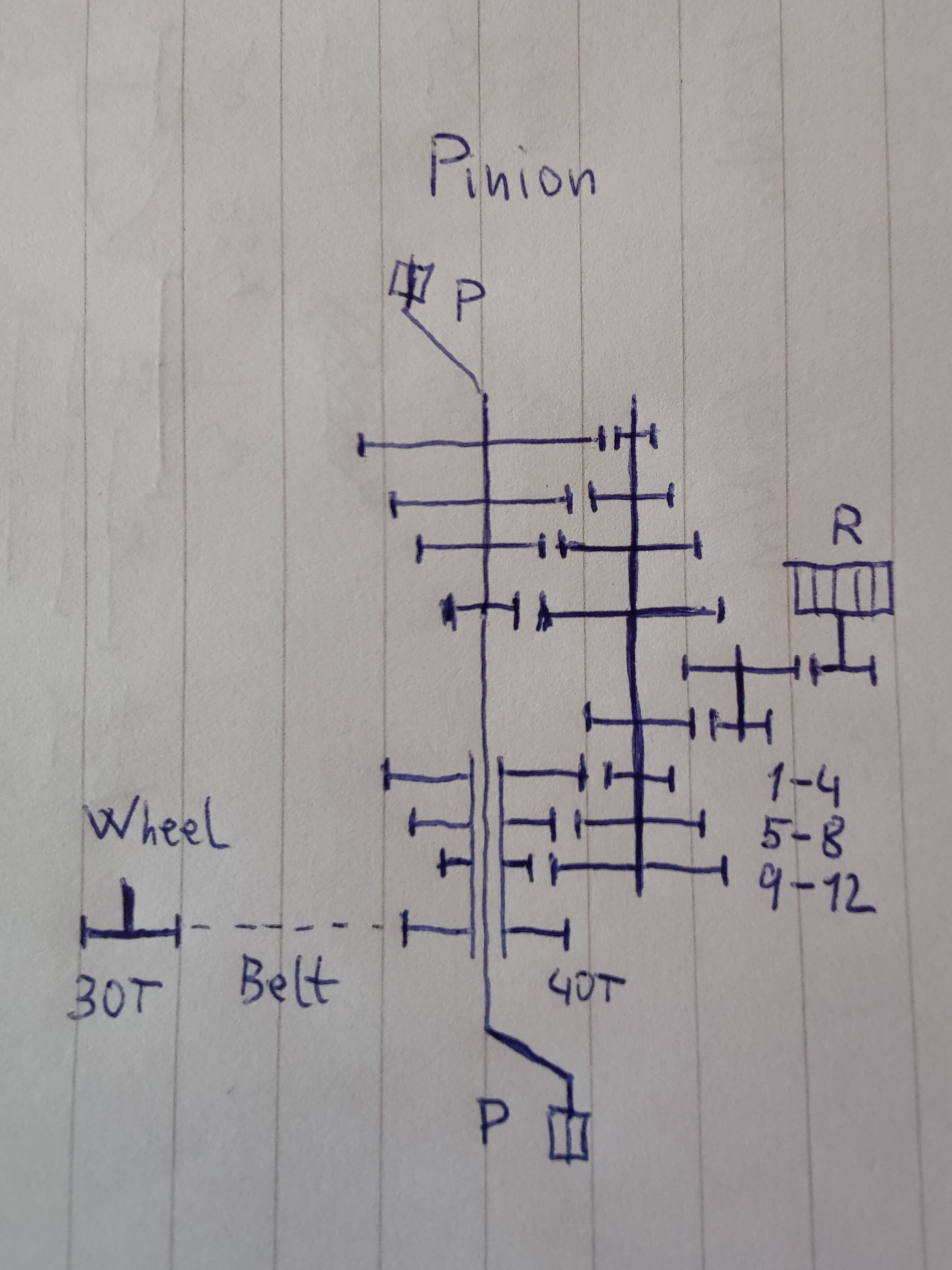

Started to think about gearing, how it is done. Heres is my diagram from Rob video and open motor pictures. Can be wrong though, feel free to comment. Did not yet looking for some indepth gearing explanation or videos on internet.
From this, my assumptions:
1. There will be higher drag on pedalling, you need to go over 2 gears, plus it is rotating in an oil (Which is good, no more greasing). Standard motors have pedals directly to chain ring (or over one way clutch)
2. There are 3 gears (1 to 4, 5 to 8, 9 to 12) between belt ring and rotor. Rotor is reaching max rpms only in gears 1 to 4. Which means worse effectivity of motor in higher gears. Will go to heat. Comparing to standard rear deraileur, you could keep rotor in optimal rpms.
3. According my calculation, belt ring will reach cca 300rpms, which is not that high, I wouldnt be worry about some danger to chew your trousers. ;)
4. Belt would have worse efficiency comparing to chain (chains have 99% ). But found on internet belt could have better efficiency over 200W. Not sure if this is true.
Would go definitelly to 9 speed gear box (on ebike no need to have more) or even would experiment with 6 ( 3 to rotor as is and only 2 gears to pedalls)- could be enough.
Anyway, this is a huge leap in ebike drivetrains! I am glad no more hassle with chain and cassetes. Also that autoshift is great.

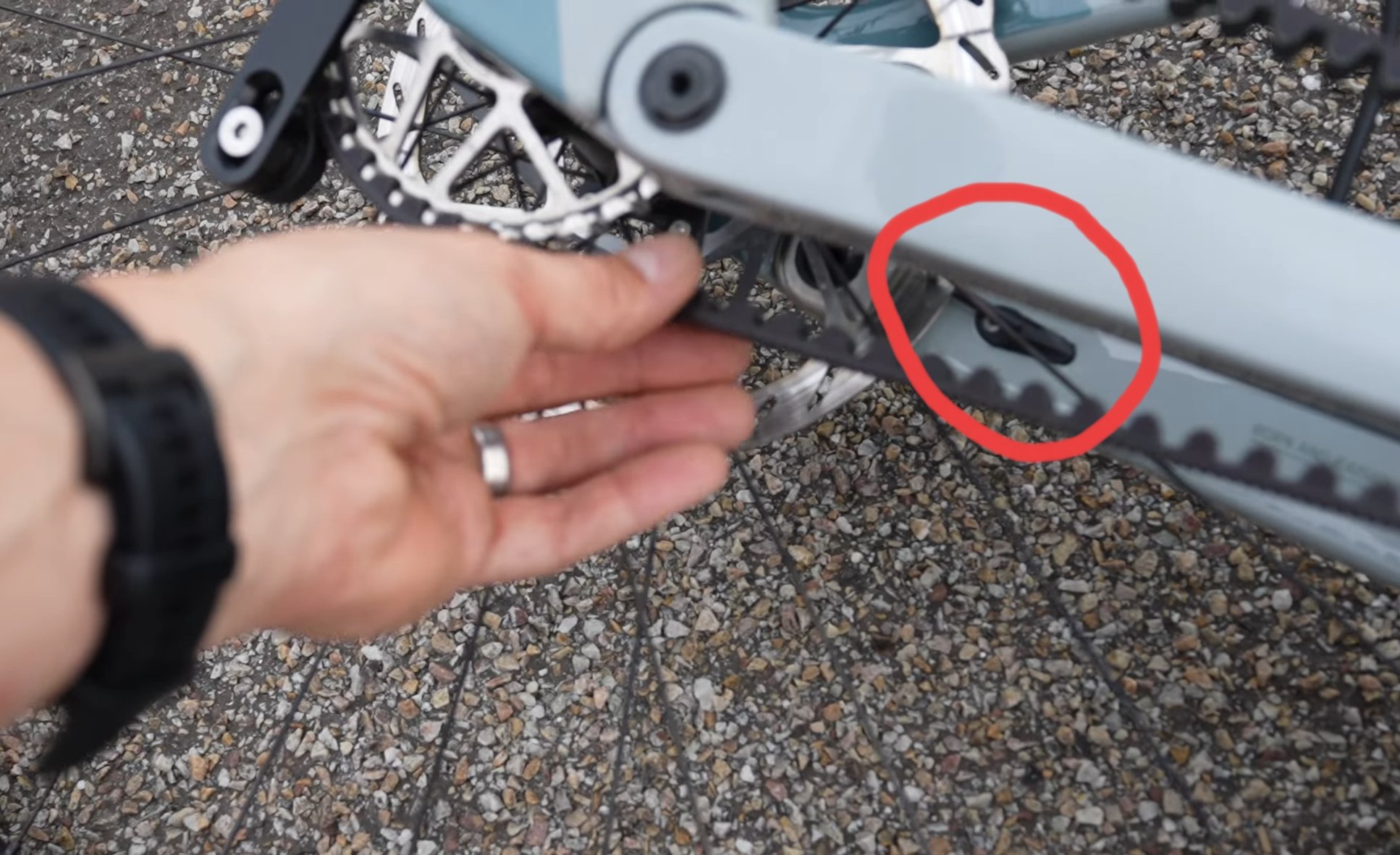

I've not worked out where the speed sensor is yet ????
De-restricting is going to be difficult/impossible ! Especially if you want to use some of the auto functions like auto shifting, pre-select (where it changes to the right gear for the speed when you're descending).
Why you think will be impossible to derestrict? Motors needs to stop assist at 25kmh. If possible to cheat firmware it should work.
If belt drive is without one way clutch at the hub, it can measure speed on belt gear axle.

Yes, would also do it over magnet on wheel, still better not to ratate belt while coasting.
Looks like there is integrated magnet on brake disc.

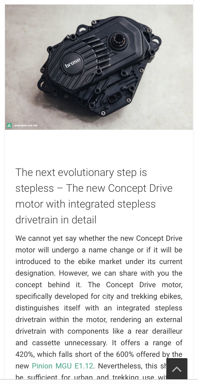

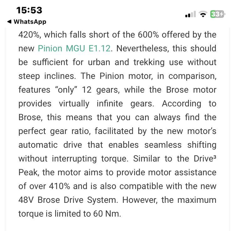

In a former life I was very involved with making gearboxes and feel I know a bit about them in larger applications but not much difference scaling them down from what I can tell.
As much as it pains me to say I frankly believe the next evolutionary step would be to a variable drive motor for mass application. I just don't think the technology to do so is scalable for this application right now from a physical size standpoint.
As I believe that's 10 years away or more so I'm happy to see this in the meantime.
My big ask would be a "gear" position which is completely neutral meaning little to no drag when coasting for downhill applications. The possibility of a legit DH long travel ride such as the Voima with this motor and drive seems ideal but the stipulation for me would be it should feel like a (heavy) analog bike when pointing down under gravity power.
