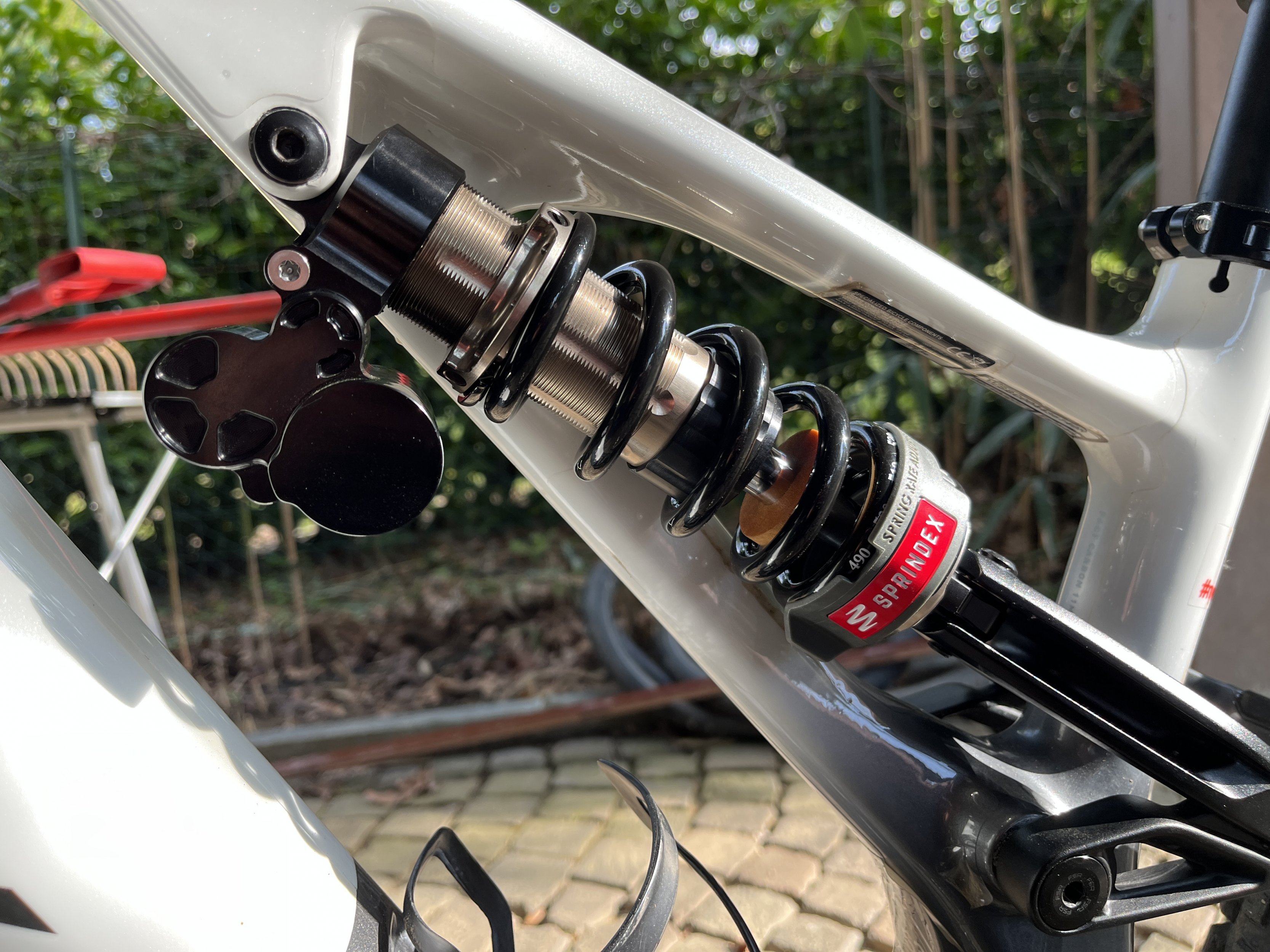

My lucky day. After examining it more closely, the fault was not in the shock, but in the Oneup post. It had so much lateral movement that it rattled when riding standing position and the saddle down. It has now been fixed, Cheers!
