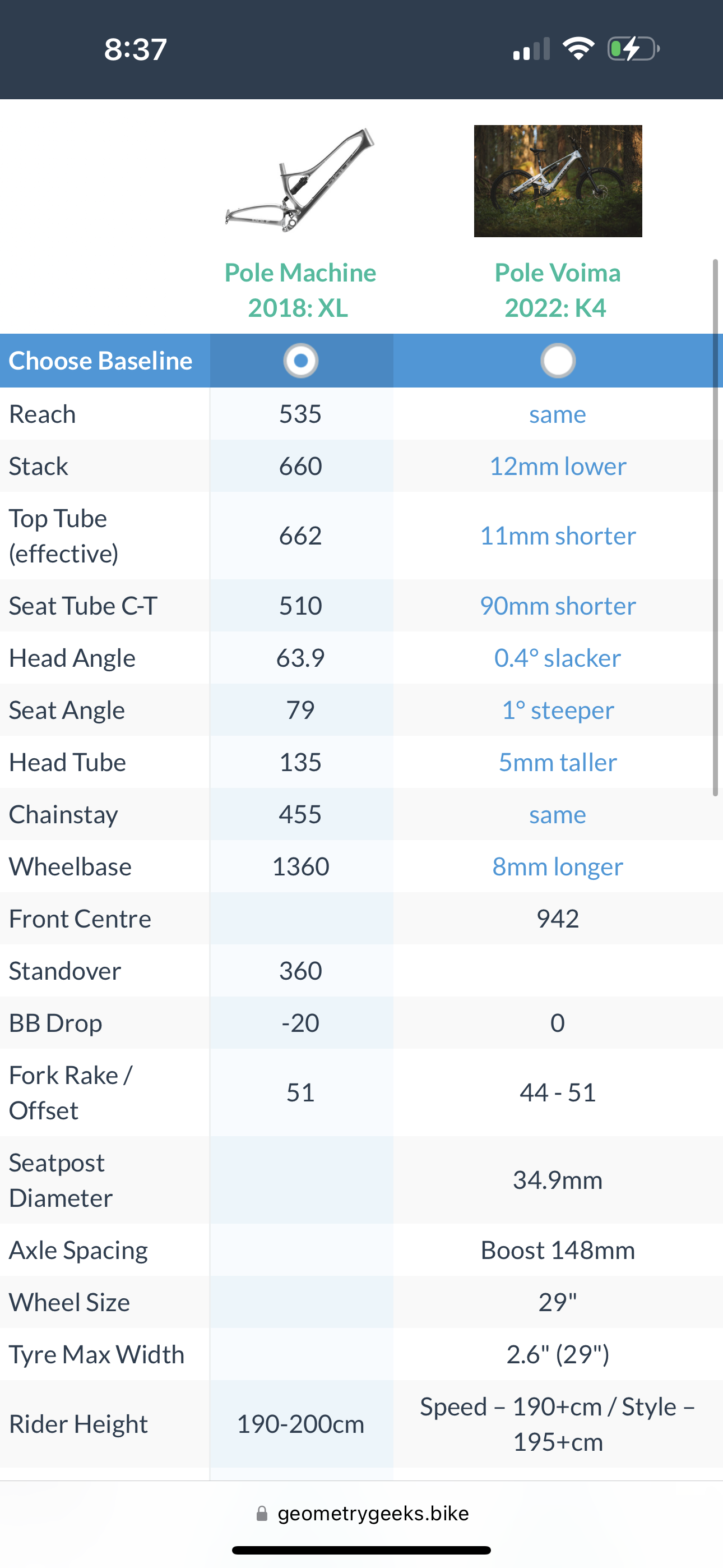

I found myself wanting to slide off the seat to get more comfortable on K4 voima. Will be installing 50mm stem instead of 35.
Being 196cm tall Machine is the perfect size for me, a bit on the planted side though, but I like it that way. Still can throw it around if I want to. Voima feels tiny bit shorter, but it has different stem and handlebars and harder to throw around due to weight and probably need higher bars. Still dialing it in.
Good to see that people are going for what they think suits - the short seat tube means its fits a wide range of sizes which is cool. I’m 173, with a k2, and think the bike is nice and agile, corners great, and loves steep weird tight stuff.
If you look at this pic of me hitting a mediumish drop - im not cramped and im not stretched when the bike is dynamically compressed beyond sag – which is where it counts. In fact I might take off a spacer to add a bit of reach for the next ride and see how that works! Would be good to see others post up “dynamic mid travel” pics as I think it would give people a good idea of how the sizing works, when it matters, and not just on paper.
I don’t think the geo is as out there as it might appear on paper. I totally have 100% forgotten about it and it just feels a like more composed but equally dynamic and playful version of my last bike (a rail size M )
