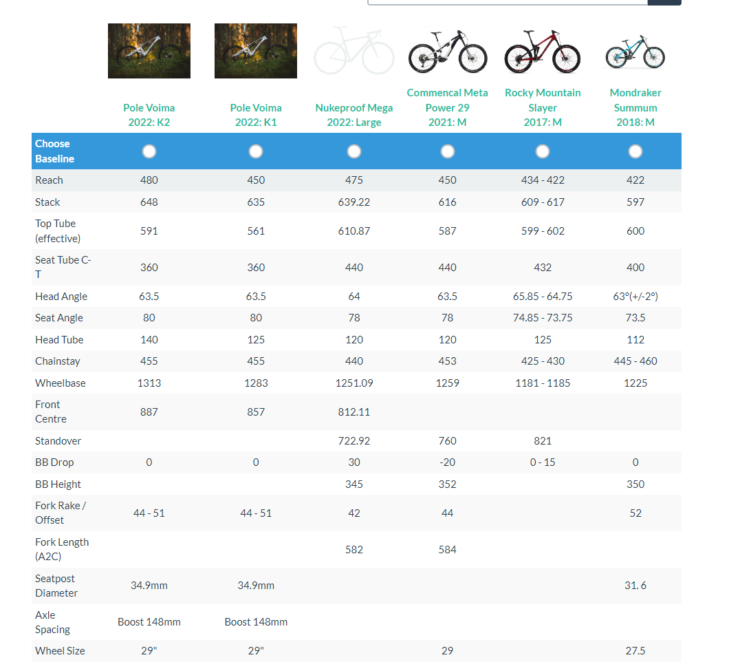

Looking at all the geo numbers the K1 is bigger than my 22 medium Rail in every dimension other than top tube length, and that's purely down to the steep seat tube angle.

I'll he honest. I wish they had a 79 deg seat tube and slightly longer tt for each reach size.
I know what i want in the reach department. For me descending set up is most important. 450 is what I want for reach. That's still 30mm longer than my current bikes.
So I will be on k1 size with a stupid short tt. I'll have to slam the seat back on the rails to try and counteract the shortness of the tt.
I do a lot of tight steep almost trials like tech. So also dont want to go too long in wheelbase.

I currently have a large bullet reach is 475mm
i do feel sometimes a bit stretched when descending. I used to ride a medium megatower and that was 447mm in low setting and when the bars were rolled forward it was fine..
I was thinking that with the reduced reach it would feel better. looking at geo it’s still a longer overall wheel base and front centre than large bullet so descending should feel fine.

That puts me square in K2 according to Pole. But not according to what I enjoy for my riding style and the tracks I ride which are mostly tight steep tech. I rode the K4 pole last week (the only one in my area) that was stupid big. But for better reference I also rode a Nukeproof Mega in large and a Comencal Power 29 in medium.
The mega at 475 reach felt too stretched. The meta at 450 reach felt just right.
Im riding 2017/18 M Slayers for my pedal bikes and 2017 mondraker summom for my dh rig. I'll admit they are on the short side and i need to increase reach. But they are also awesome for my tight slower speed track that I have locally. I don't want to go to 480 reach or 1313 wheel base. That will compromise my down enjoyment.
The meta felt fine in the riding compartment at 587TT. The k1 at 560 is 27mm shorter than that. But I can probably take most of that difference up with slamming the seat back.

I'll be honest the crazy as 80 Deg seat angle and short TT for the reach measurement is the only thing holding me back from hitting go. I simply don't like long reach bikes for descending tight tech.
If I choose the K1 it might just be too short in the TT for extended sessions. If I choose the k2 i'll probably hate it for the tight tech that I ride. If I was riding fast open chunky bike park it would be a no brainer. I'd withstand the longer reach and go K2. But a lot of my stuff is natural steep slow and very tight. Hell I have to nose wheelie flick the back around in several spots just to get around.
My daughters size small Orbea Rise has the same TT measurement as the K1 of 560. I might have to spend a bit more time on that to see if I can live with it long term.
I am also looking at the crestline RS75/50. That has the exact geo I want and its carbon. But its crazy expensive to import into NZ.

I don’t think there is any other manufacturer that has an 80* seat tube. The zero drop BB is also different from most other brands, as is the super long wheelbase and like you said the production method and looks. So yes, it is outside the box. Maybe I’m wrong here, but is seems from your posts here, that you don’t like the Voima. So if that’s the case, why are you even subscribed to this thread and posting about the bike? If you just want the same old thing, a Chinese cookie cutter bike with the same geo as everything else, the Voima is not for you bro.
I really like the Voima and I am seriously considering it but most of the posts here are about sizing and people who in theory like Voima's modern geo end up buying the wrong (usually smaller size) and then spending time buying higher riser bars, moving the seat backwards etc!
