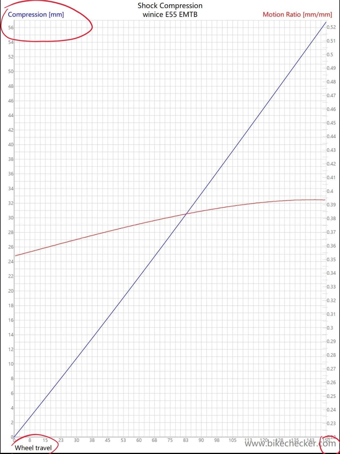

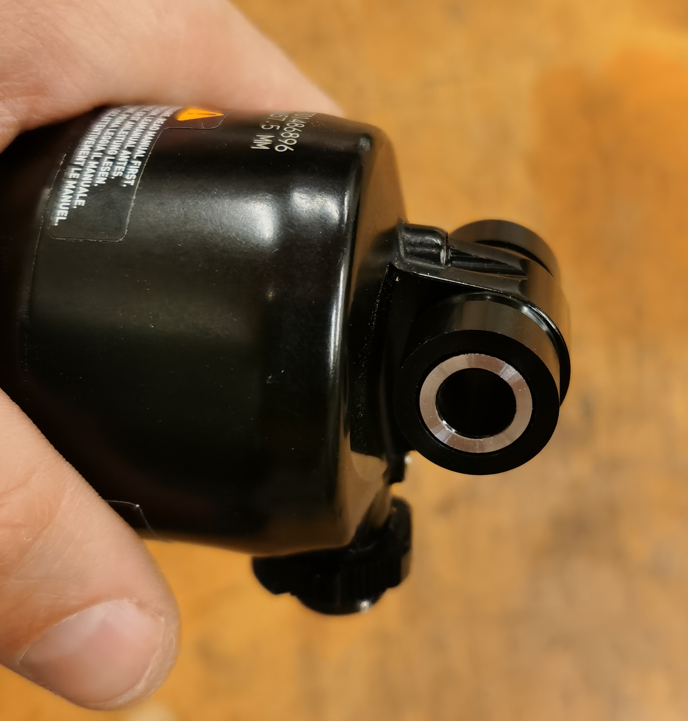

This frame accepts 230mm x 60mm rear shock (maximum stroke is 60mm provides 142 mm rear wheel travel). I found a new Rock Shox Deluxe RT3 Re:Aktiv 230mm x 57.5mm rear shock on eBay for cheap so I decided to sacrifice 2.5mm of the rear shock stroke (minus 6 mm of travel, or 136mm of travel with 230mm x 57.5mm rear shock).
It looks like this shock was detached from a Track bicycle and had the original hardware, so I had to remove the hardware first
Did the tool for removing the original bushing
The eyelet on the shock stanchion already had the insert installed. But the eyelet on the shock housing had nothing after extracting the original bushing. So I purchased POLYMER EYELET BUSHINGS 1/2 INCH 12.7MM DU BUSHING for the housing eyelet on eBay
Pressed the insert in the eyelet
Measured the width of the shock attaching points on the frame and on the aluminum rocker. To mount the shock you need 32.3 mm wide, 8 mm inside diameter bushing for the shock to frame interface and 16.8 mm wide, 8 mm inside diameter bushing for the shock to aluminum rocker interface.
I did not find shock bushings with the exact width. So for the shock to frame mount I purchased oversized 32.4mm wide Rock Shox mounting hardware on Amazon (3-Piece, 1/2", 8 x 32.4 RockShox Rear Shock Mounting Hardware)
For the shock to aluminum rocker mount I purchased undersized 16.4 mm wide Fox mounting hardware on eBay (FOX 2-Piece Aluminum Mounting Hardware Kit for DU Bushing Shocks 8mm x0.648" / 16.5mm)
As expected 32.4 mm hardware did not fit the 32.3 mm space in the frame and the 16.5 mm hardware was too lose in the 16.8 mm space in the aluminum rocker.

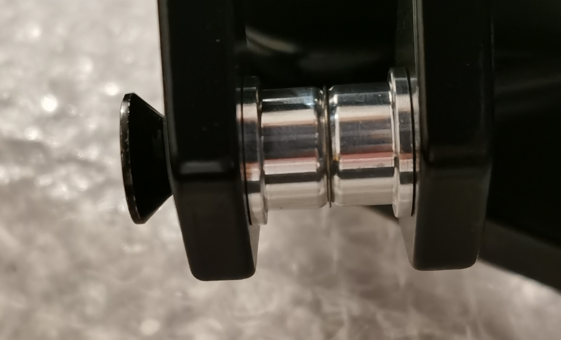

So here is what I did. I machined the 3-Piece, 1/2", 8 x 32.4 RockShox Rear Shock Mounting Hardware to 32.3 mm width.
Machined the aluminum bushing.
Then machined both plastic spacers
Pressed the hardware inside the shock
For the Fox bushings I ordered stainless steel 0.01" (0.25mm) Thick, 5/16" Inside Diameter, 1/2" Outside diameter shims
And just used one shim in between the bushings to make the stack width
The shim outside diameter is 12.7mm, but it is too large to fit the shock eyelet insert. So i grinded it down to 12.6mm to fit the hole
Lubed the hole and pressed partially one bushing on one side
Dropped the shim in
Pressed the second bushing in and pressed all together completely
Adjusted the bushings position with the press to make the stanchion centered in between the bushings

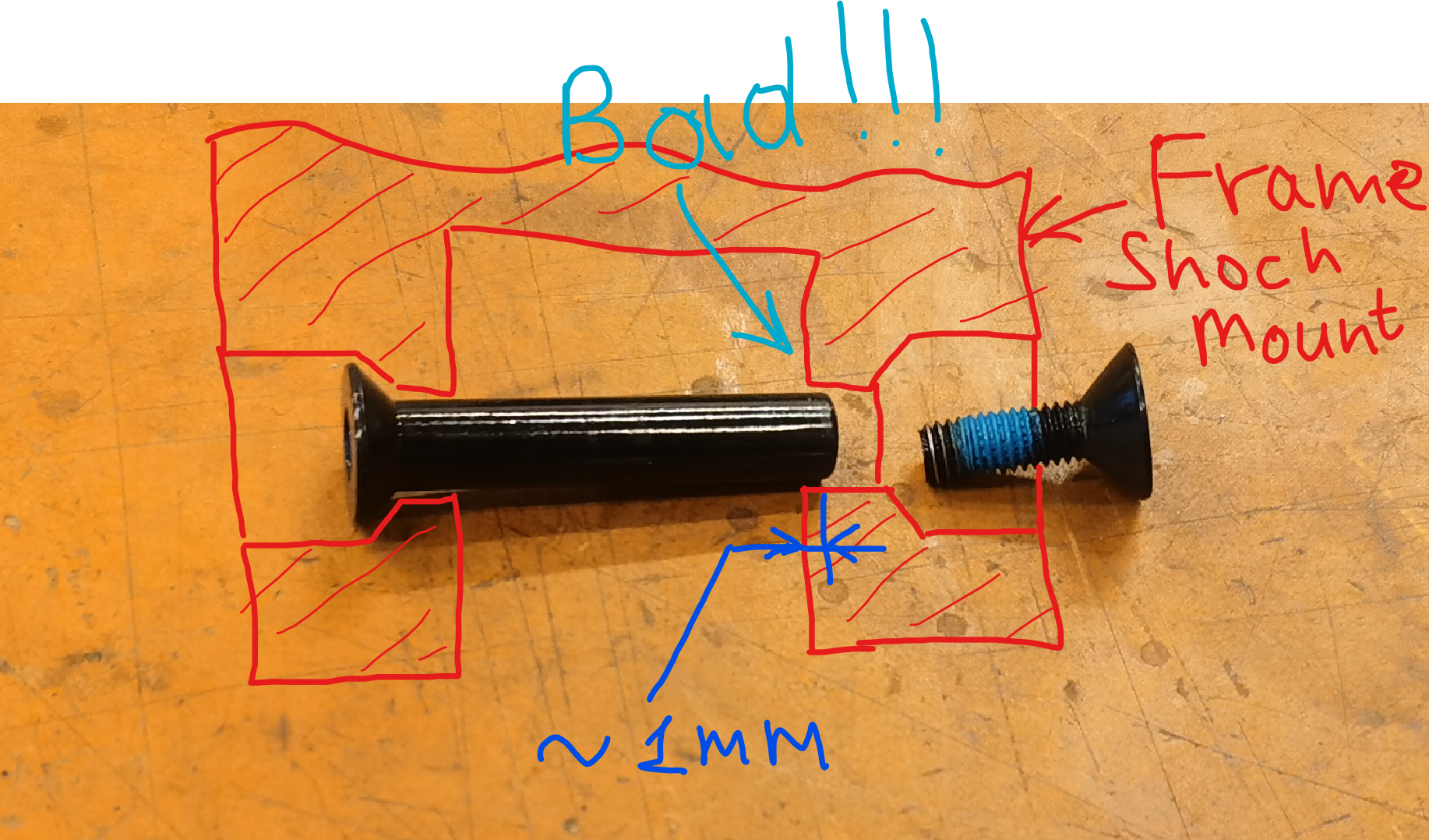

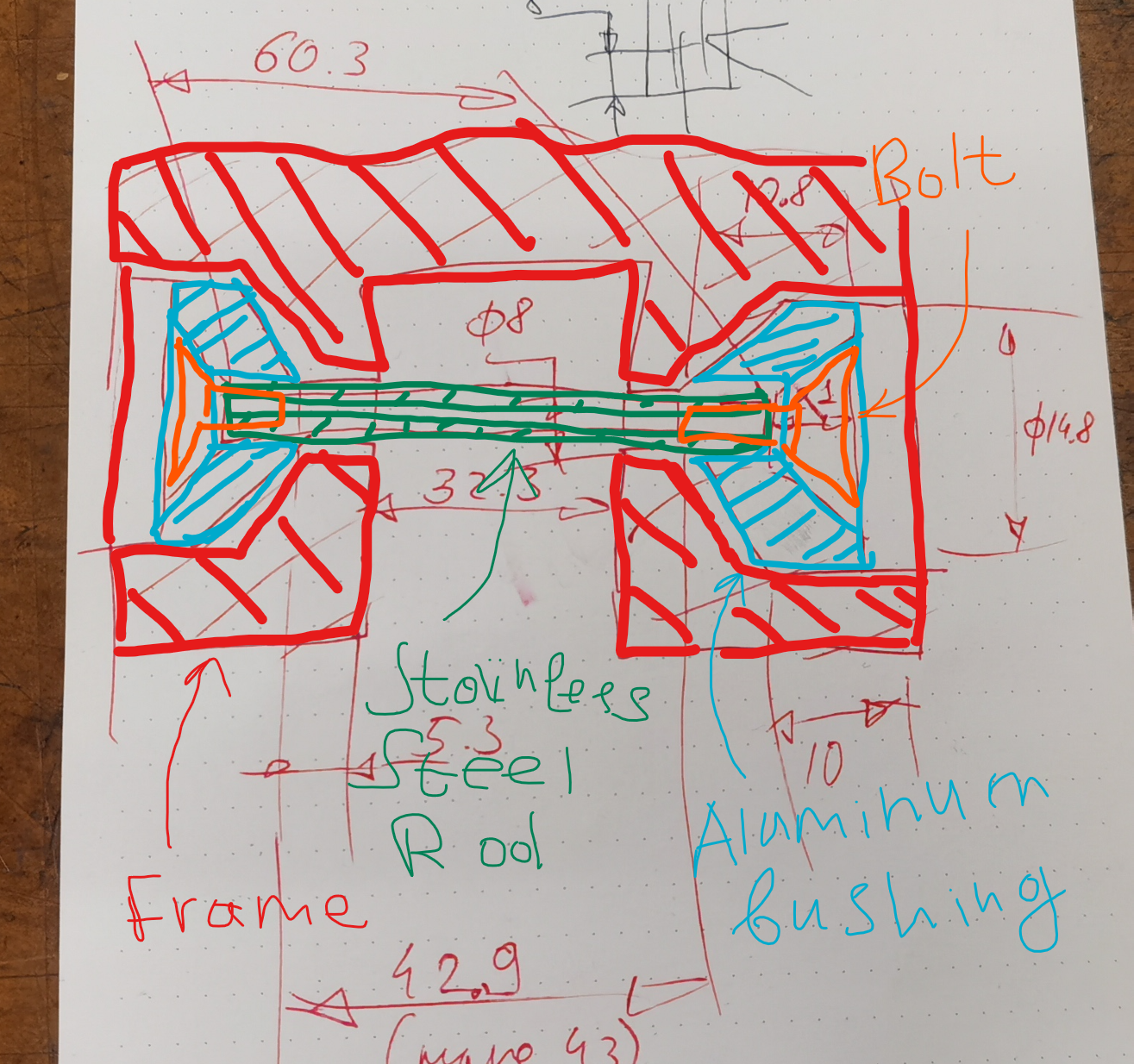

Then I figured out the original Dengfu shock to frame mounting fasteners do not fit well to the frame. The hollow bolt barely engages with the hole on the opposite side (it goes to the hole on just 1 mm) and it can cause excessive pressure on small area of the frame under the shock load or strong bottoming of the shock and can cause the carbon fiber frame crack. If it would be a few millimeters longer that would probably be OK, but it just barely engages with the hole and can cause catastrophic failure.
The hollow bolt engages with M6 bolt and that M6 bolt will be under significant stress too with such configuration.
1674954020593.png 1674955713113.png 1674955933439.png 1674956360203.png 1674957561133.png

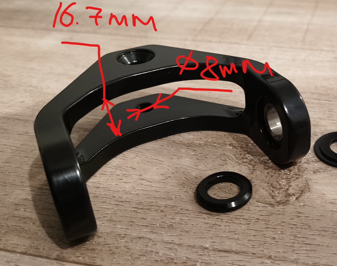

So I decided to fabricate my own mounting hardware for the shock to frame interface
I purchased stainless steel 90 Degree Countersink, M6 x 1.00mm Thread, 20mm Long screws
A stainless steel 8 mm outside diameter, 5 mm inside diameter tube
And 3/4" diameter 6061 aluminum rod

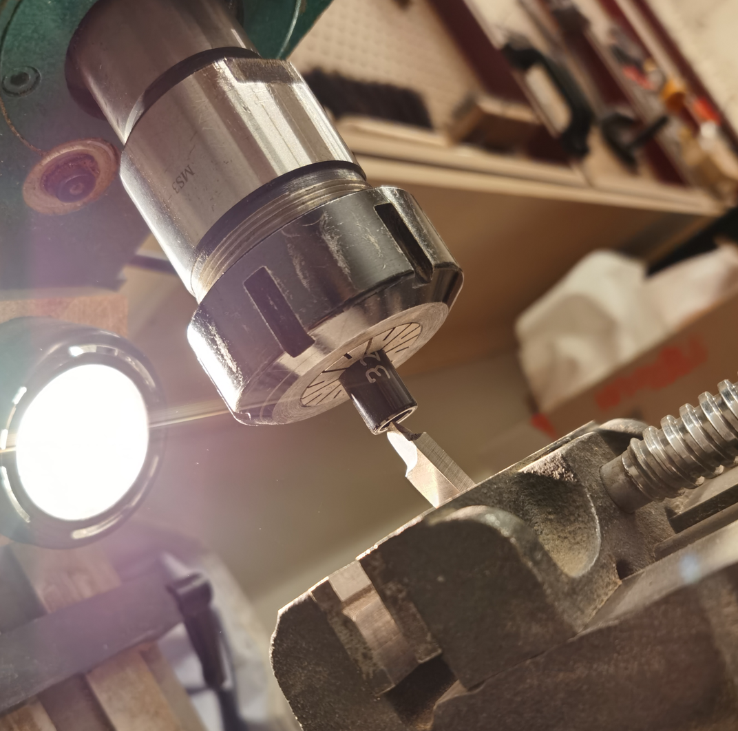

And machined this thing of of this
Machined 14.7 mm outside diameter of the aluminum bushings
Drilled pilot hole in the bushings
Drilled 8 mm hole in the bushings
Chamfered 90 deg the hole of the bushing for 90 deg flat head M6 screw
Cut off the bushing from the stock aluminum bar with 45 deg cut
Repeated it twice
Then lithely sanded with fine 2000 sandpaper the 8mm OD, 5mm ID stainless steel tube to make it smooth.
Trimmed it to necessary length
Chamfered both ends of the tube with 90 deg countersink
Tapped both ends of the tube with M6x1 tap
And here we have it
Applied Loctite 242 to the screws and attached the shock to the frame

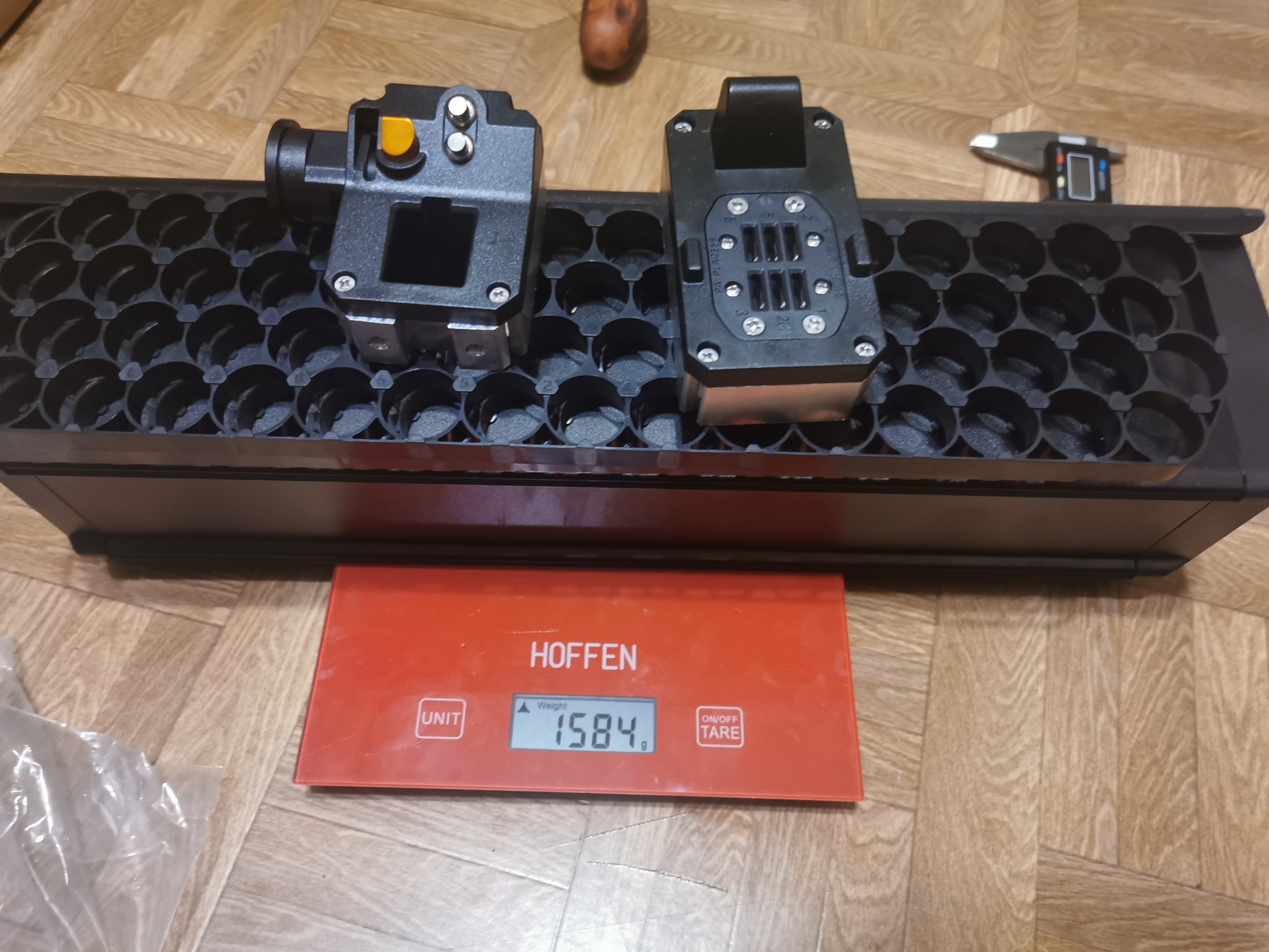

For the drive unit I purchased the Motorset X1 3000W (52V 60A) with Innotrace X2 display
The bottom of the motor has sticker 48V 30A 1000W but I guess that means nothing and any UART Bafang m620 can be turned to 52V 60A 3000W with Innotrace X1 controller?
I configured my order on Innotrace website with 60A XT60 connector but for some reason they sent me it with standard 30A Anderson connector? Can I pump 60A through this connector?
The motor fits the frame without issues

I am going to use a standard Reention Rhino 21700 Ebike Battery Box so the capacity is going to be equal or less than 1040 Wh.
The lid is separate detachable part so there is no need to fabricate it, you can purchase it on aliexpress.com. If you want to use this lid with custom case battery pack you just need to figure out how to attach it to the battery or to the frame.

Dengfu claims 150mm of rear wheel travel with 57mm of shock travel. It's not true?
I ordered an empty battery case on aliexpress, still waiting for the frame to be shipped but dengfu has delays...
I think it is possible if you put enough effort to do research.
You're right. If not then I can somehow have one fabricated for me.
Could you please also make one photo of the inside of the downtube. I want to understan if there the same 2 bolts that hold brackets securing all the housing.
Thanks!
I draw the bike kinematics based on the Dengfu E55 17" drawing they shared and the rear wheel travel is about 142mm for 230mm shock with 60mm stroke
For 230mm shock with 57.5mm stroke the rear wheel travel is 136mm (this is the shock I use)
Even according to the Dengfu E55 17" drawing the rear wheel travel they indicated is less than 150mm (144mm) for 230mm shock with 60mm stroke.
