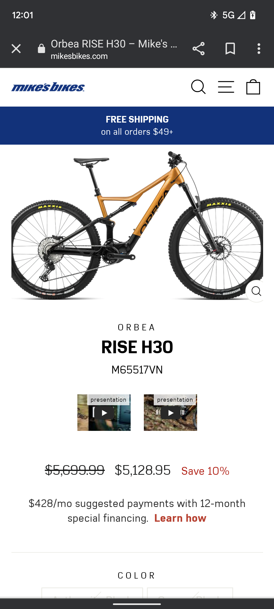

I should be testing the Rise H30 soon in order to compare all others to the Shimano RS, which is reported to be the strongest climber at a similar 60 Nm...but very unstealthy in comparison.😜
