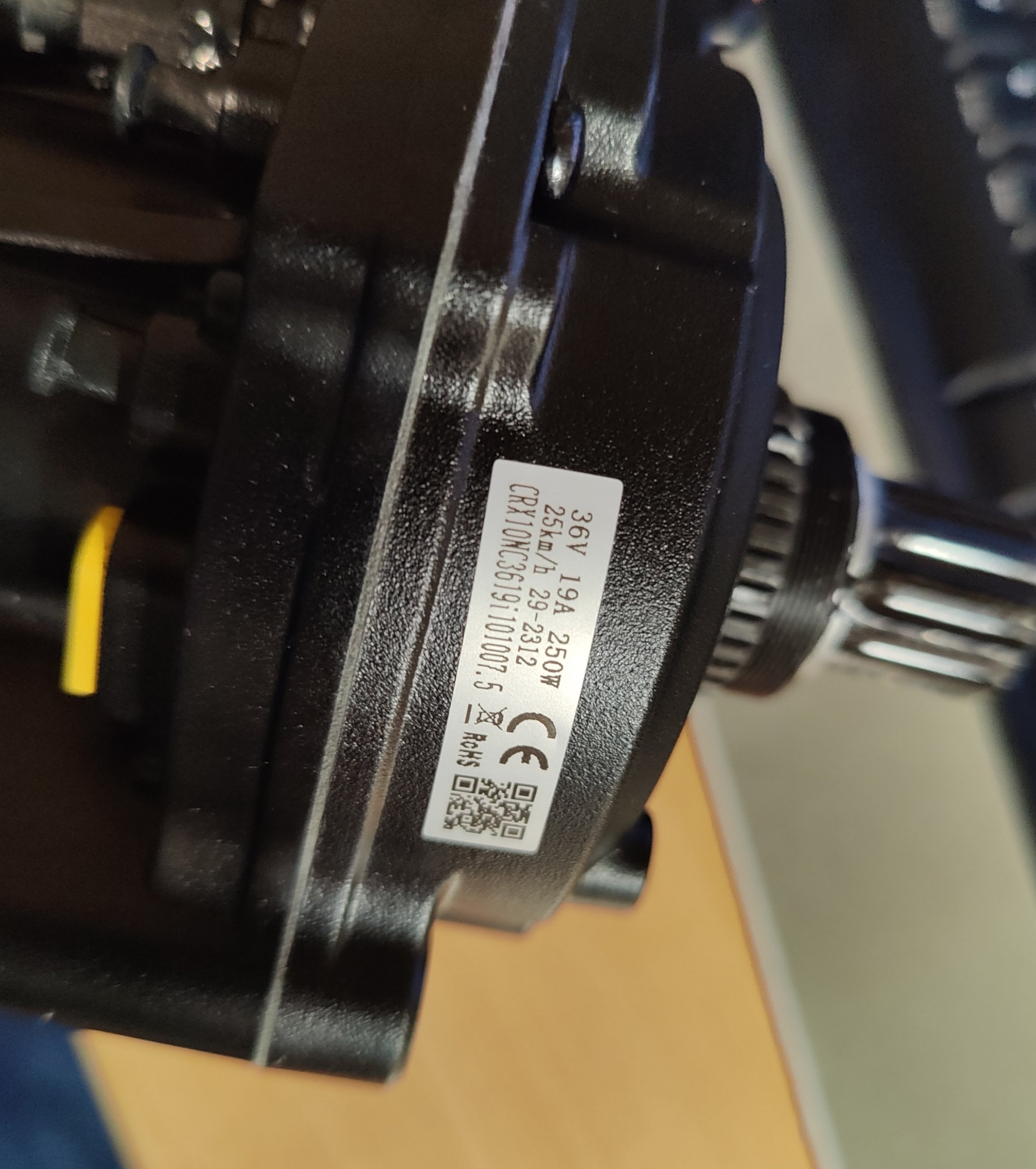

Hello guys. Just got M510 motor.

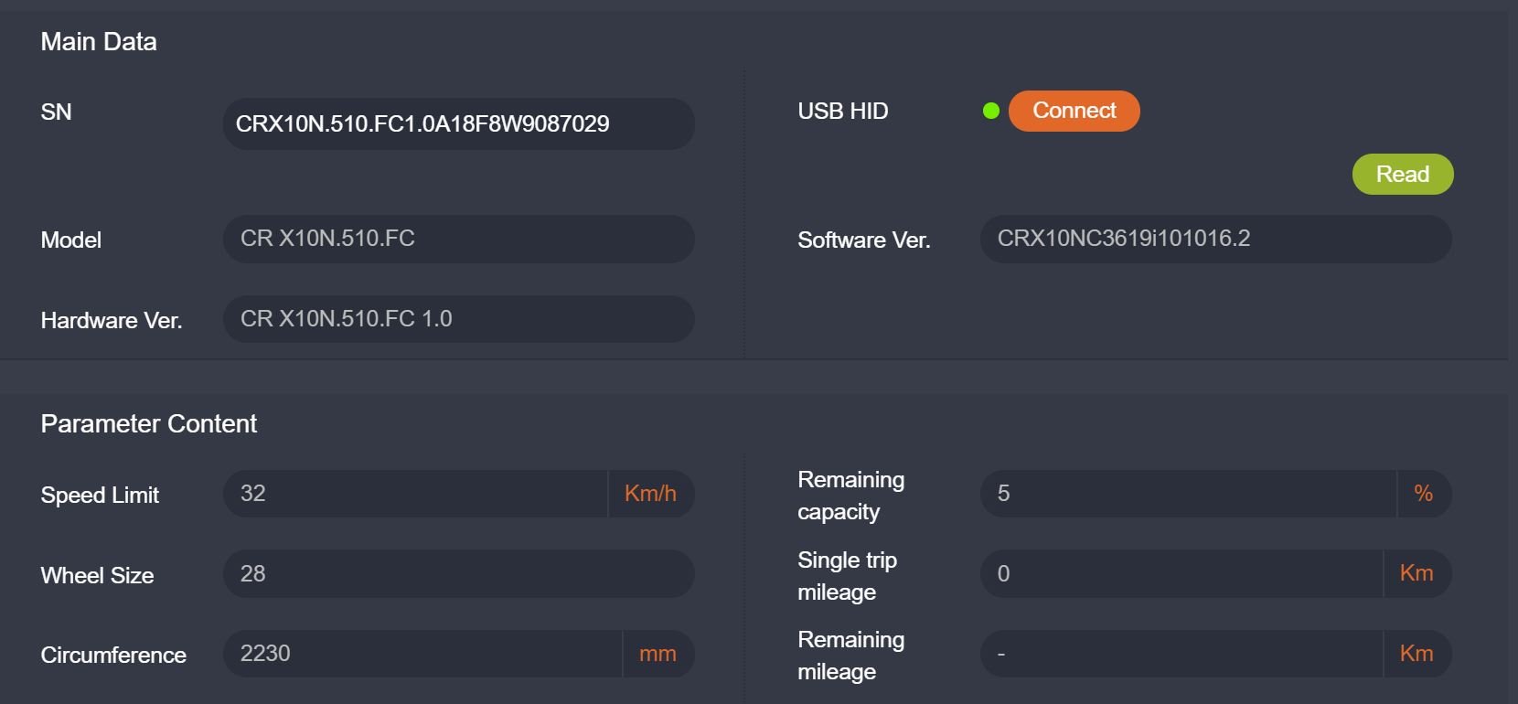

They have a good mess there, look at sticker and FW version readed:
Will flash to 48V.
Anyway if somebody has some new firmware for M510 36V (v16.2) would be good to share. Thanks.
Dont have now 36V battery, but will test with regulated power suply, what is cut off with this last version. Will update.
But I suppose power limiting just from 10% on this new firmware.
