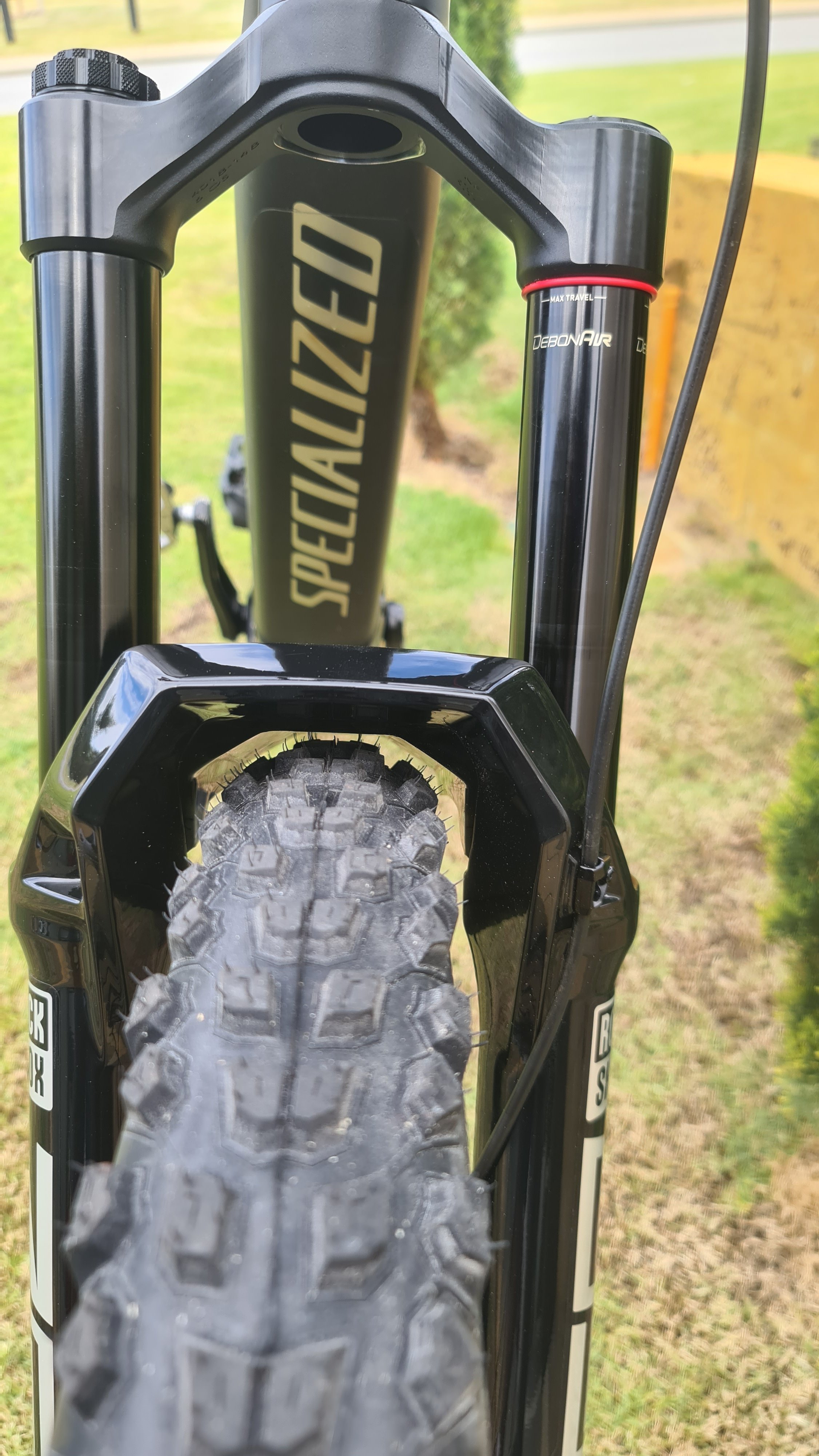

Let's hope you won't have any mud or pebble stones that stick to your tires. 🫣
Only get rain in winter and it doesn't stick like your conditions you have in UK.
We have pea gravel and Rocky terrain and super hoy and dry conditions in Perth All summer.

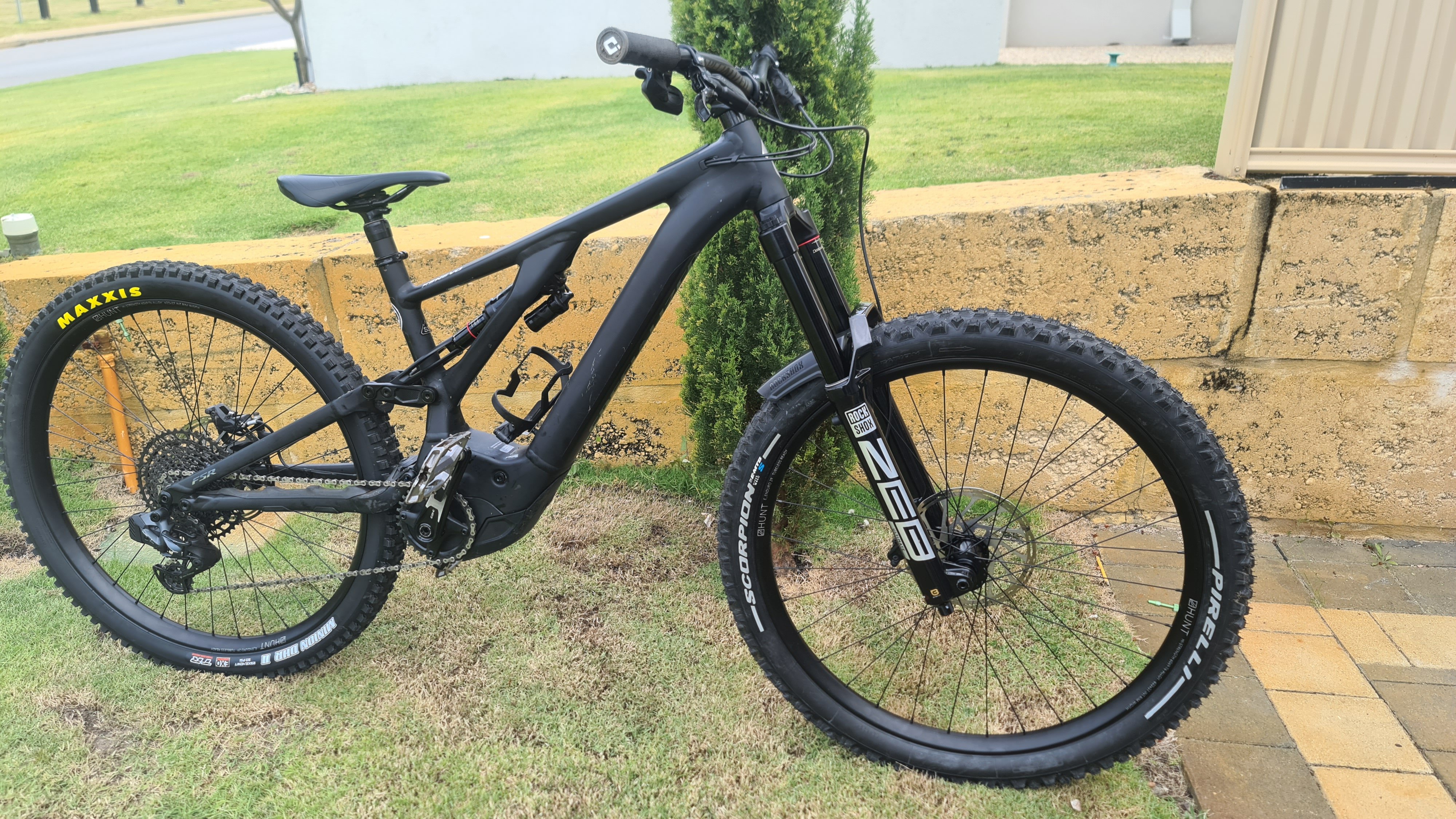

Got a mate who's running these and they are bullet proof. He hasn't had any issues with his.

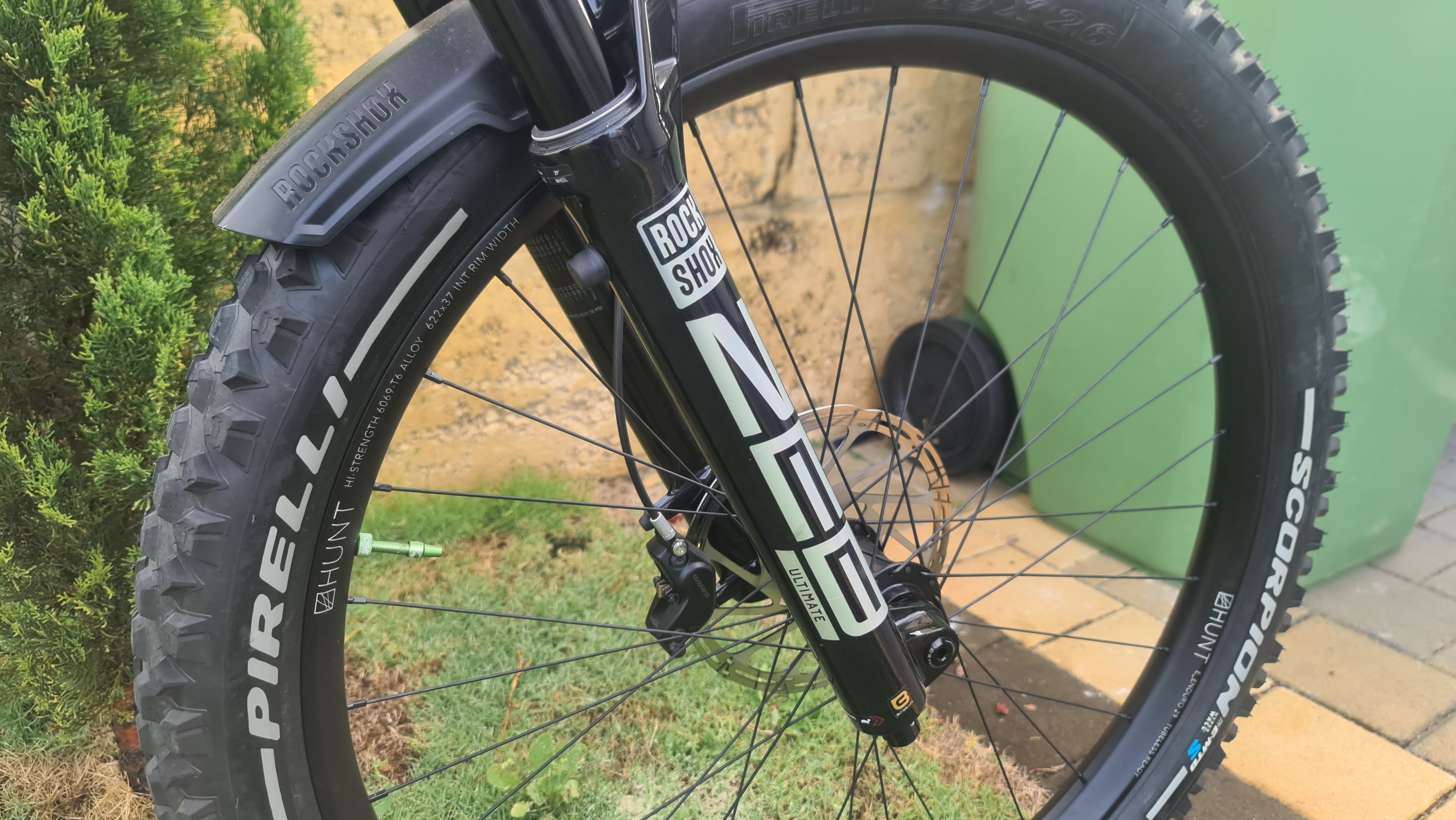

They definitely don't look like a 29" fork based on that clearance, unless you have a 3"+ front tyre fitted.
Unless the mudguard is hanging down low, it's difficult to tell now I've taken another look.
Maybe the angle is misleading, but it looks really tight in the front, i.e. the rubber "strings" (how do you call them in English?) almost touching the fork arch.
I've just installed a 29x2.4 Conti Argotal in a Yari 29" fork, and there's about 20mm space between the tire tread and the fork. On your picture it seems more like around 7mm?
They are mate , look at the bottom at the axle mounts . 27.5 angle up slightly vs 29 are level !
Indeed, I didn't know that.

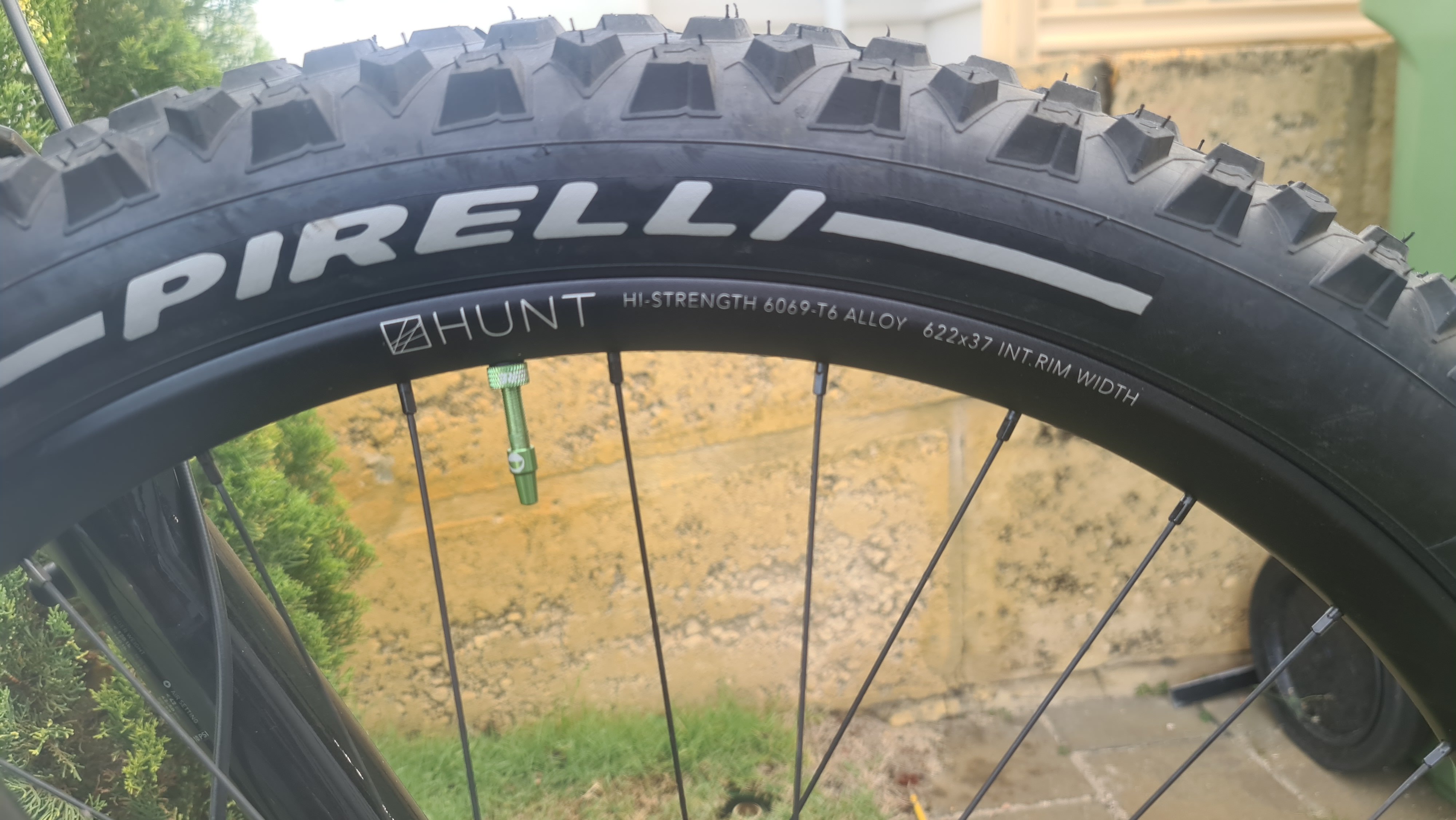

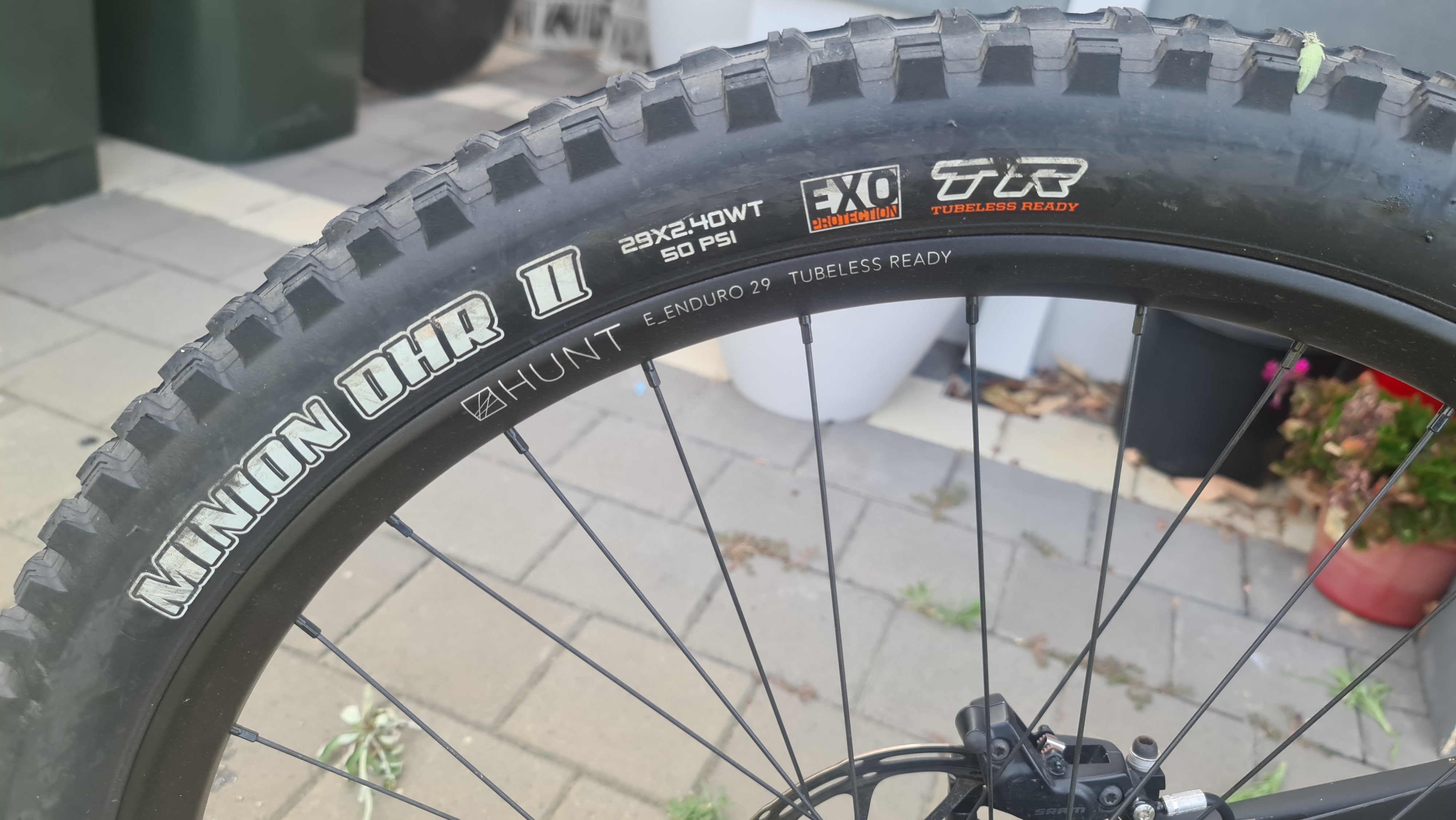

The internal of rim is 37mm and tire is 29 x2.6
Definitely 29ner got serial number checked all good. These rims are beefy and turf plus these Pireli tires are chunky.

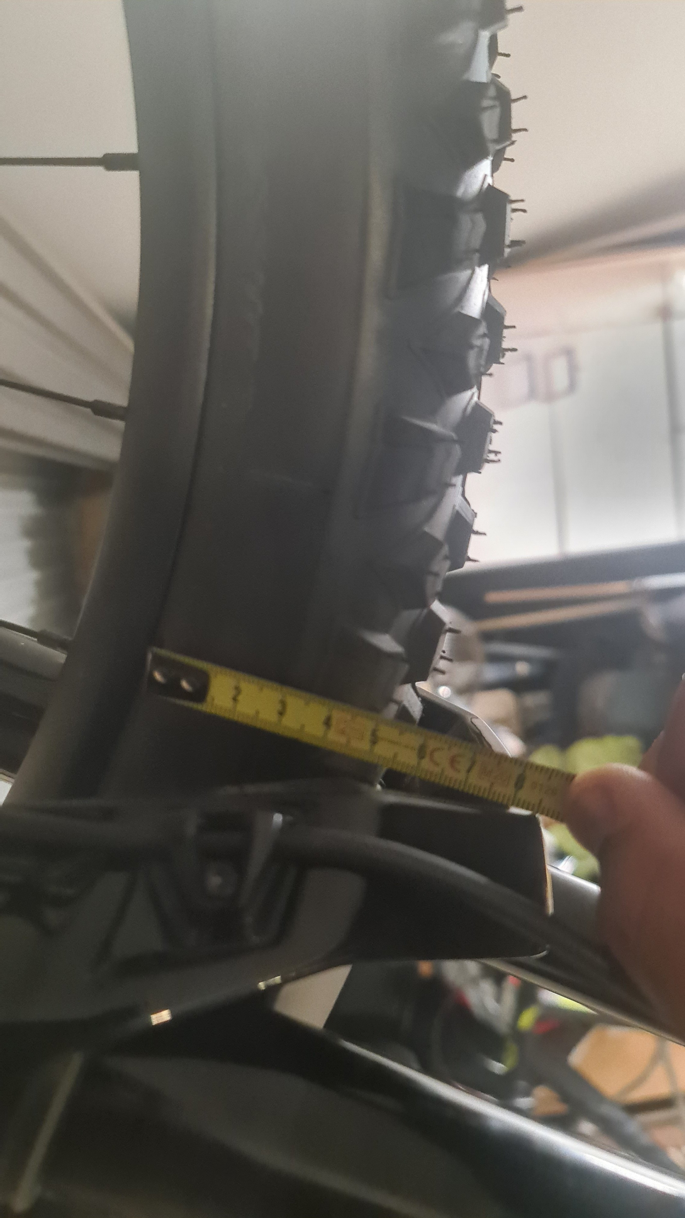

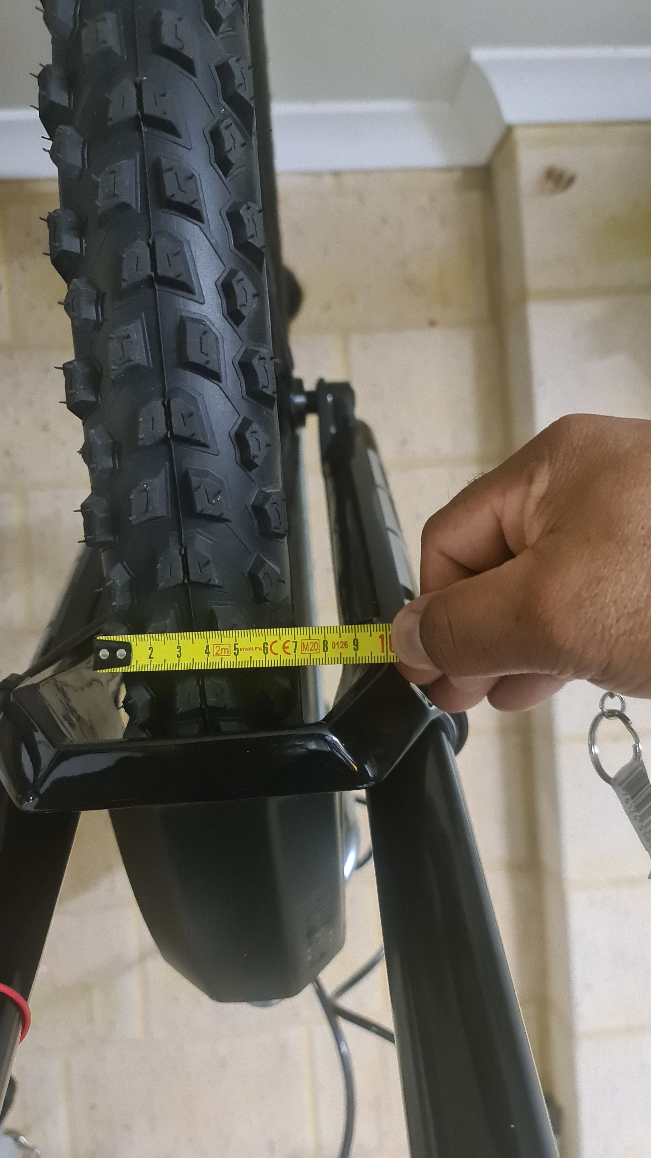

Out of interest, can put a sliding caliper on the tire and measure the casing width, tread width and height of the tire? Haven't seen much info on the Pirelli tires at all so far.
Also, wider rims normally make the tire wider as well and therefore reduce its height. So the 37mm internal width rim should actually work in your favor here.
It's weird because these rims came from UK and you've Neva heard of them
The rim outside diameter is 41mm
Tire height from rim is 63mm and width is 70mm. I'm also running cush core both front and back

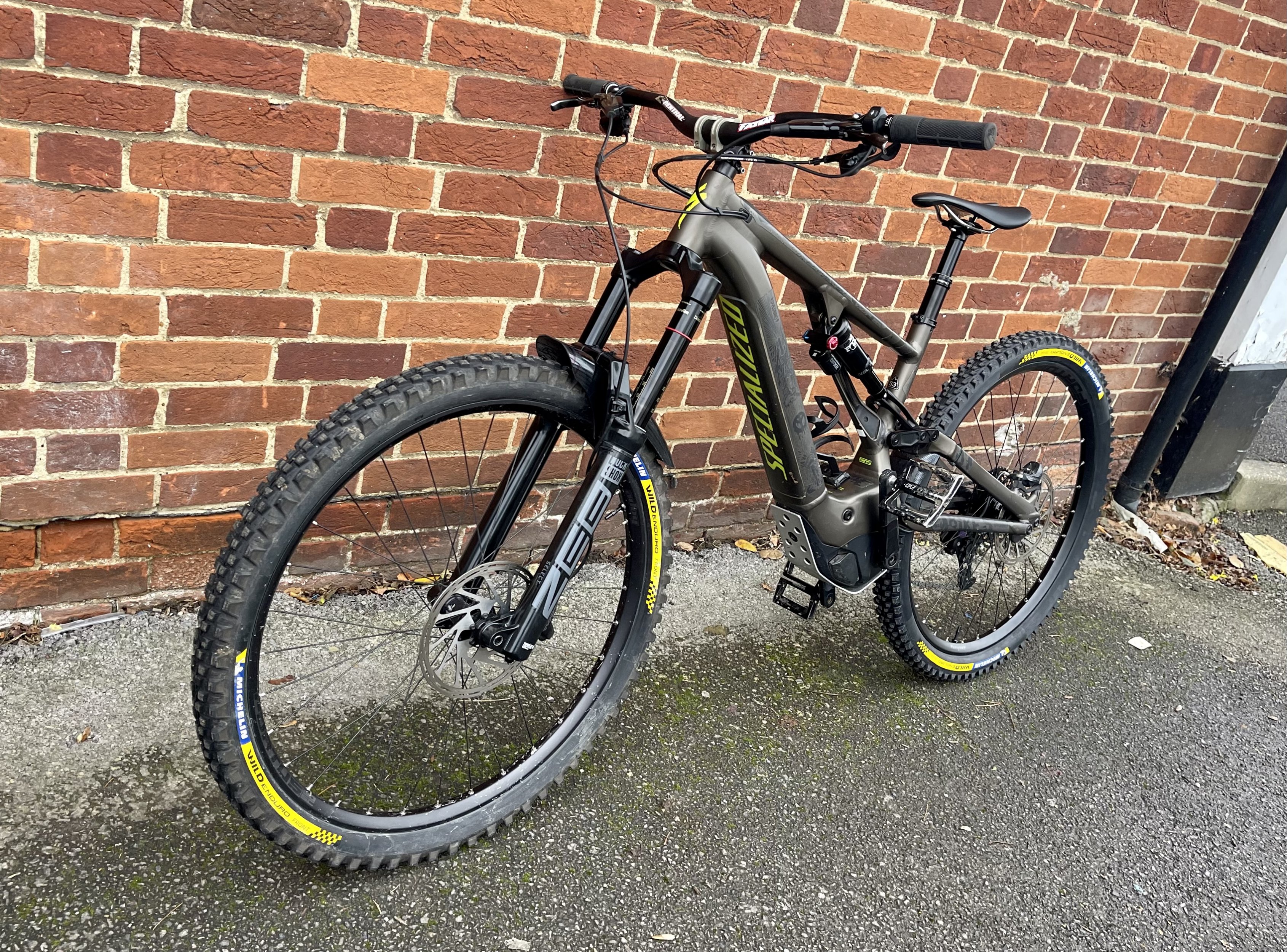

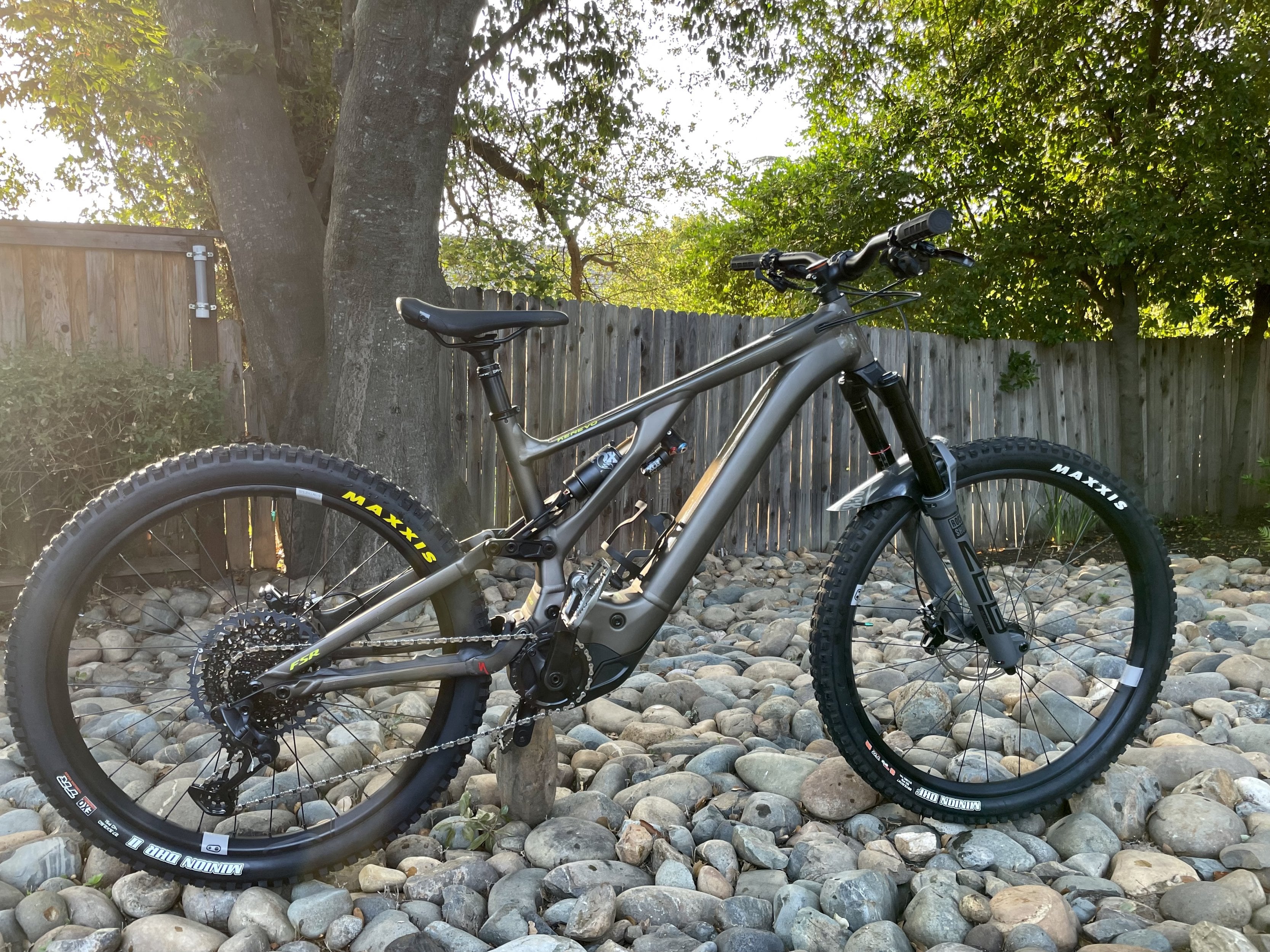

2021 Kenevo S4, I am 6 feet tall (183)
I did the 29er And mullet, went back to 27.5
neither were preferred
Mullet: My Kenevo front end wondered all over the enduro trails in the high or low setting, while climbing the front end lifted very easy.
29er: My Kenevo was ”OK” in low, bad in high setting, felt like my Kenevo was a S5 and wheelbase was extended I believe around 40 or so millimeters (The Titanic)
I do feel the boxxer is the better option when putting a 29 wheel on the front of a bike it wasn't designed for as the axle to crown is approx 15mm less than a single crown fork of the same travel.
Boxxer 180mm a2c in 29" is 582mm.
Zeb 180mm a2c in 27.5" is 577mm.
Zeb 180mm a2c in 29" is 596mm

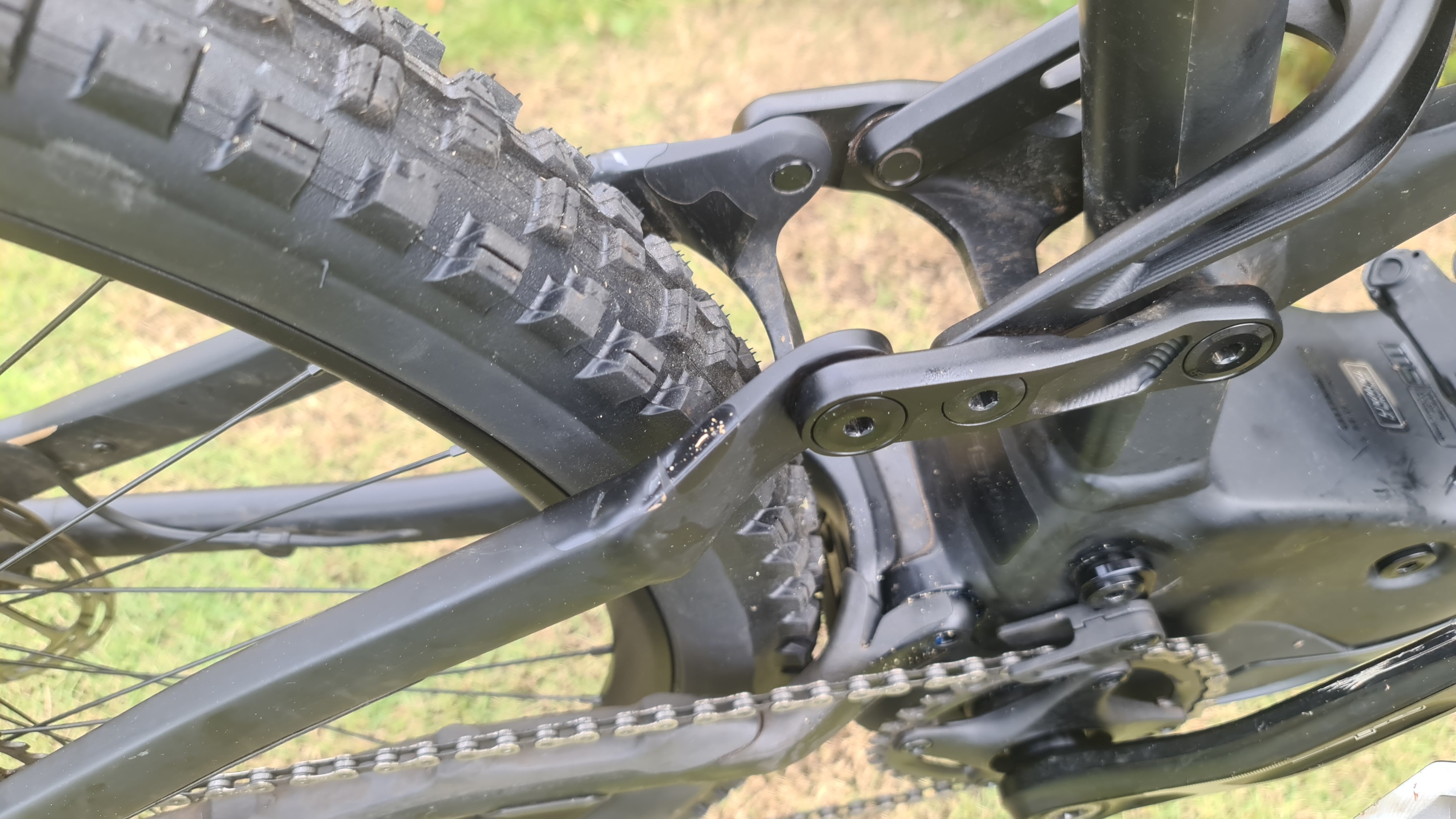

On the front it should be fine. The down tube doesn't come closer to the tire than the fork crown with a Yari/Lyrik 29" 170mm under full compression, there's still about 25mm distance to the down tube. It might interfere a bit with my longer winter front mud guard though, this I haven't been able to test yet (currently out with a broken collarbone).
On the rear, I'm not entirely sure. Switching the rear wheel to a 29er seemed to be ok when I removed the air of my shock in regards of clearance with the saddle and seat stays, but I could only test with a front wheel and its 15mm hub in combination with the 12mm rear axle, so it wasn't aligned as it would be with proper rear wheel. I don't have a 29" rear wheel that I could test with yet, but I should have one this year.
It might even be 1.5mm better than it appeared with that proper rear wheel (as I suspect the 12mm axle pushed the wheel up a bit inside the 15mm hub), but I'm not sure I'm actually going to run a 29" wheel in the back. It will be a really tight fit with the rear mud guard, but maybe I can rearrange it a bit or find another way to protect the motor & bearings.

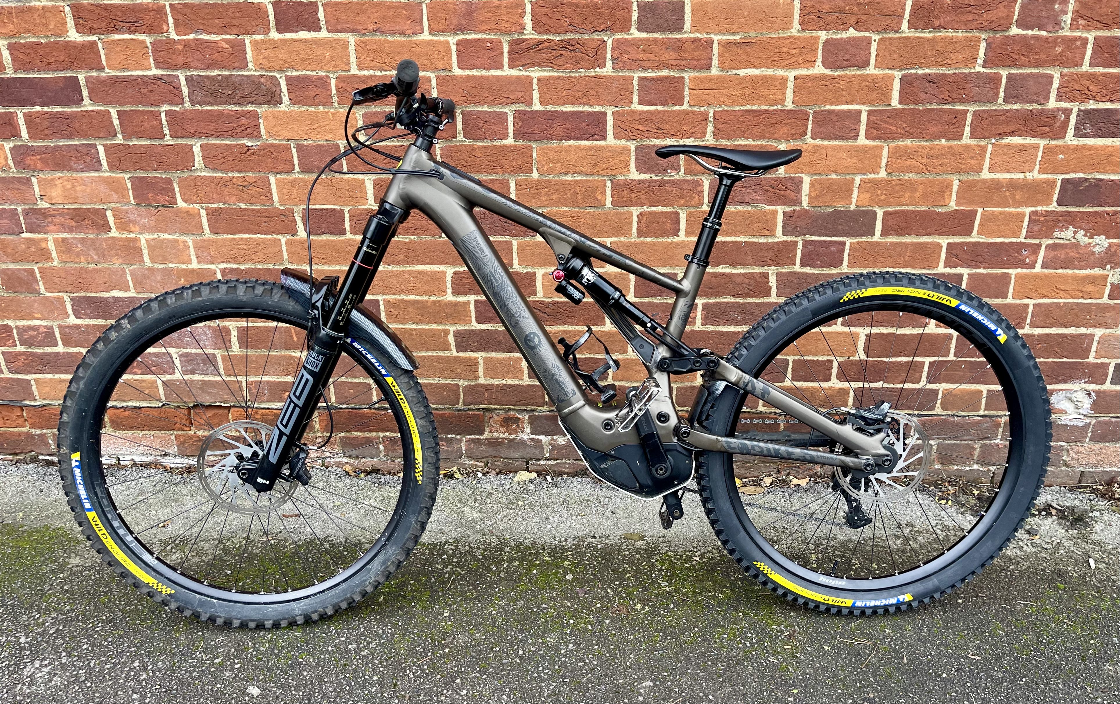

Finally got my 29er built , hope fortus single fr/triple r with pro 4 hubs and finished with a pair of the new mich enduro 2.4’s . Plenty of room at the back on a medium frame . Put the forks back to 180mm and keep the flipchip low .
I’ve smashed my Strava coms 1st ride 😂 only joking , ain’t rode it in anger yet cos of the knee but out this Sunday with young Jimmyvillas & James so gotta try and hold back 🤘

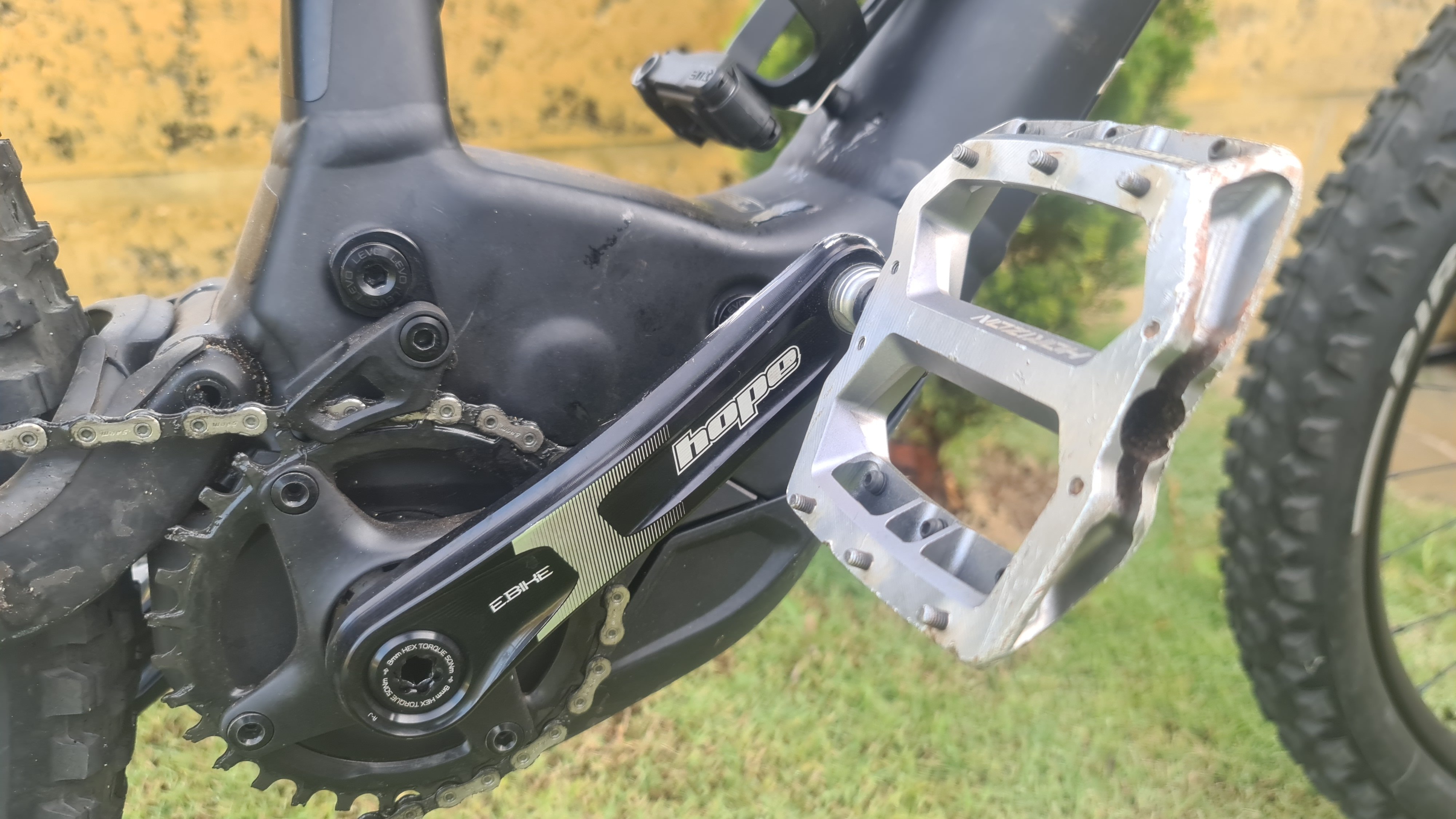

Hi Rob,
Everything else stock bar the Zeb Ultimate rc2, Hunt wheelset, 2.6 pirelli scorpion on front, minion Dhr 11 on rear with cush core inserts, GX AXS 12 SPEED, 155MM HOPE Cranks.
Cheers Astan
