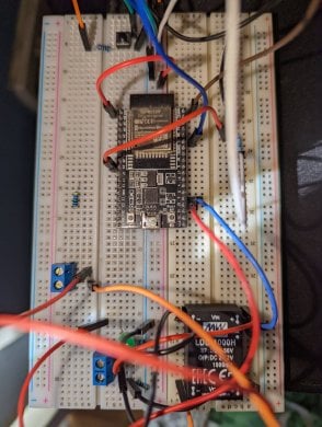

- I'm also in the process of rebuilding an Exposure Flex e-bike Light I fried by by dumping 12V at 5A (from a big buck converter) into it without current limiting (oops), this is kind of relevant as, the remote driver board I'm designing will have an ESP32 to generate a PWM signal to dim the lights via the new current limited DC/DC run off the bike battery. It might make sense if I can use the CAN bus connection to get the speed sensor data to detect movement rather than the accelerometer that I was originally planning on using. I've actually got a usable breadboarded circuit for this project, but there are a few outstanding issues (powering the microprocessor for one), I haven't added CAN bus to this one yet though as it's just a standard ESP32.
So basically I'm working on 3 different things at once and some are closer than others, I'm thinking I need to start putting it all on my github now or it's going to get out of control. Not sure how I version control PCB designs though other than just dumping the KICAD project files into the repo though!
