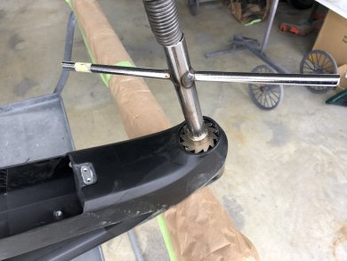

Is it possible to install a Cane Creek Angleset? Is the headset delivered with the frame semi integrated (ZS) or fully integrated (IS)? Are there cups that need to be pressed into the frame?
I have installed an adjustable headset on my E10, but you have to edit the head tube a bit.
As far as I know headset is not delivered but there has nothing to be pressed in the frame as it is set up.already
