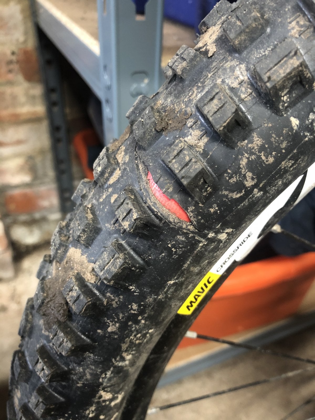

Madmatt75
Nov 22, 2018
43
58
London
Thanks Tannus. If I was using just tubes or tubeless, I would have been walking home. Proof they do work.
