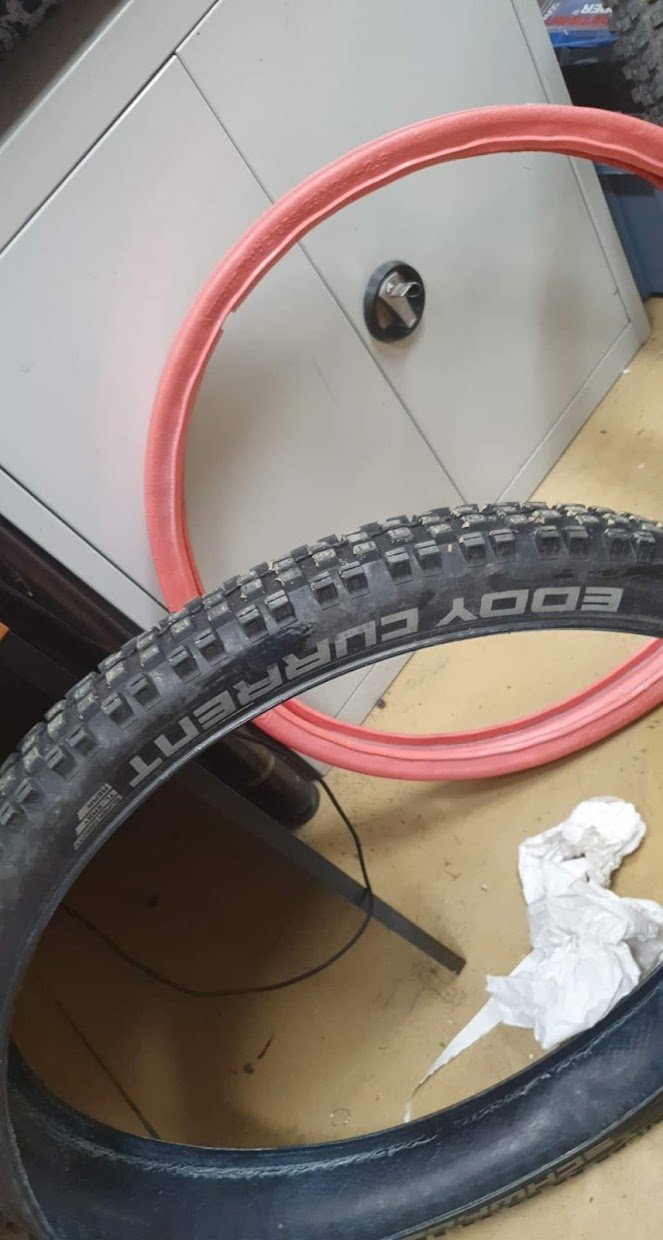

Tannus Armour Finally Failed

1st puncture in the rear after 1300 miles

I really can't fault it, I use it with tubes. As an experiment I went tubeless in the front and Tannus Armour in the rear. I've now done a little over 1300 miles and have had 3 front punctures and now 1 in the rear. to be fair most of my cycling is commuting to work and back so most of my punctures are from broken glass which tubeless isn't really designed for

Thats a serious puncture!
I'm on 900 miles without a puncture with the Tannus, wouldn't be without it in both tyres.
To be fair, nothing would have stopped that!
What tyre is that btw?

the tyres are what came with the bike Schwalbe Smart Sam, Active, 2.60

Make a warranty claim with photos!
Although perhaps check first - did the tube have an impact pinch flat or a real puncture?
More importantly, what was it like riding home with just the tannus ?

It was unridable. infact its the closest I've come to having a blow out on a bike
