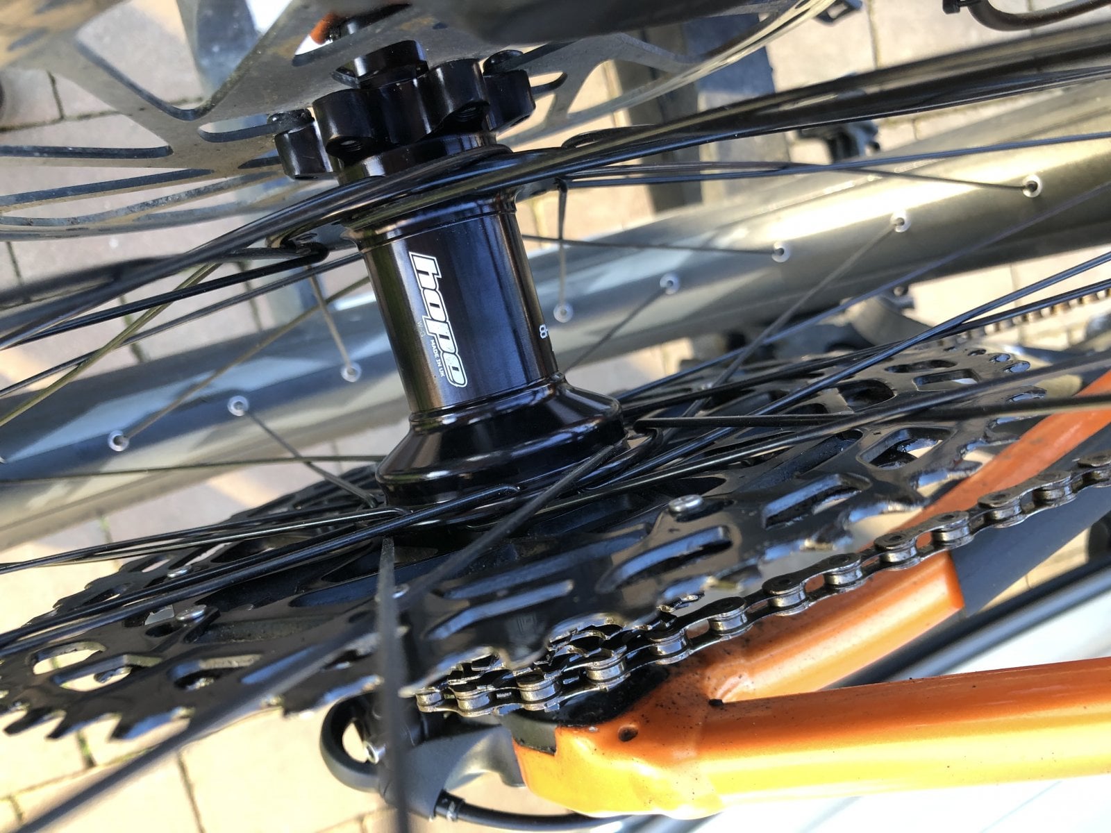

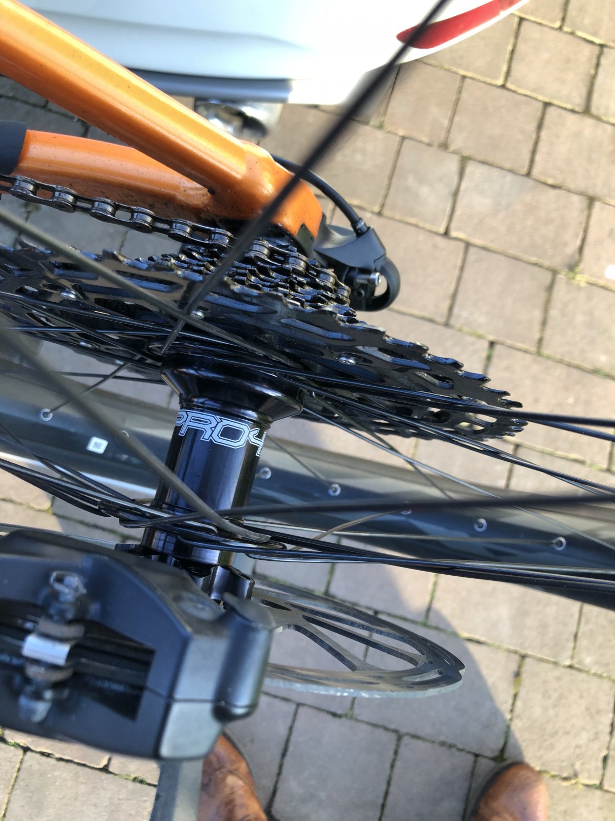

I’ve just had my bike returned and first I must say how professional Giant Newcastle have been, identified problem listened to all my issues and fixed the problem.
They contacted Giant and told them there was an issue with the free hub and they didn’t want a like for like replacement, Giant then instructed them to source a upgraded hub, they did and fitted it all within a week,
Haven’t bean on it yet not going on it till Sunday but fingers crossed that’s the problem sorted!

Sorry, not mechanically inclined...
From the photos it seems the entire axle was replaced - not just the freehub. Is that right?
So the wheels had to be re-spoked?

Could you use the same spokes and rim for the Hope hub rebuild Minty?

depends on which hub you buy, if its a straight pull hub then no. but most hubs out there have 2 styles so you should find what your after. seems a lot of people are going for the hope hubs

i was told by giant that they replace all spokes for new ones on the rebuild, every thing working as it should and loads of rides in since the replacement!
