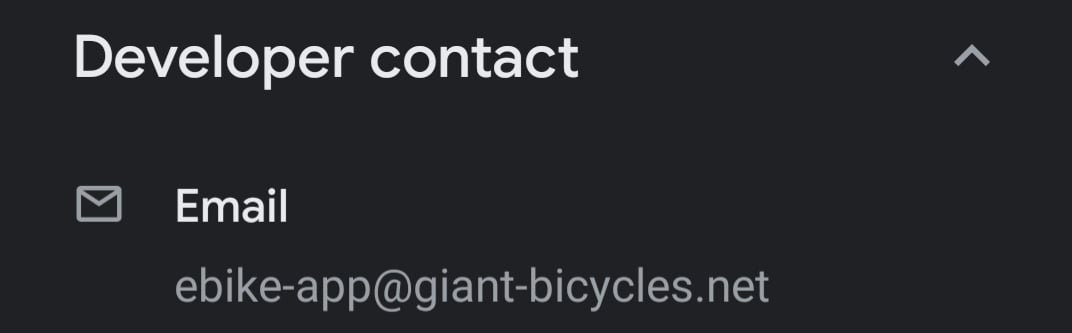

Try sending a message via app developers through Playstore or wherever you download the app, usually has a developer contact email address.
Have to be honest and say Giant have dropped the ball on software and app stuff compared to other brands, be ok if they gave an option to go back to old updates, maybe best to not connect ride control until you check reviews or you're stuck with a bad update.

Today I have sent the an email to [email protected], posted feedback on both their Google Playstore and the Apple App store and posted to Giant's NZ Facebook page. I have no doubt that this will be as effective as "a condom machine in the Vatican" but I feel better now I have vented.
