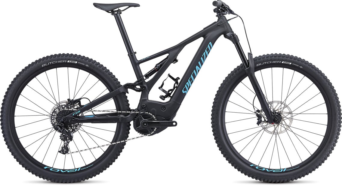

Hi,
Just ordered my very first Emtb - turbo levo fsr 2019 Size Large,
Looking to add a 34.9 diameter dropper seatpost to it, my LBS doesn't have this size so I would be looking to order it online, any specific recommendation?
Thanks for the help,
Yuval
