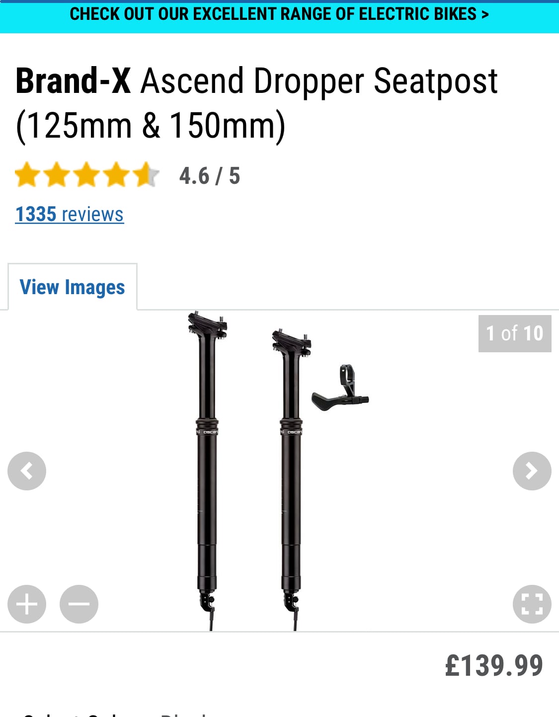

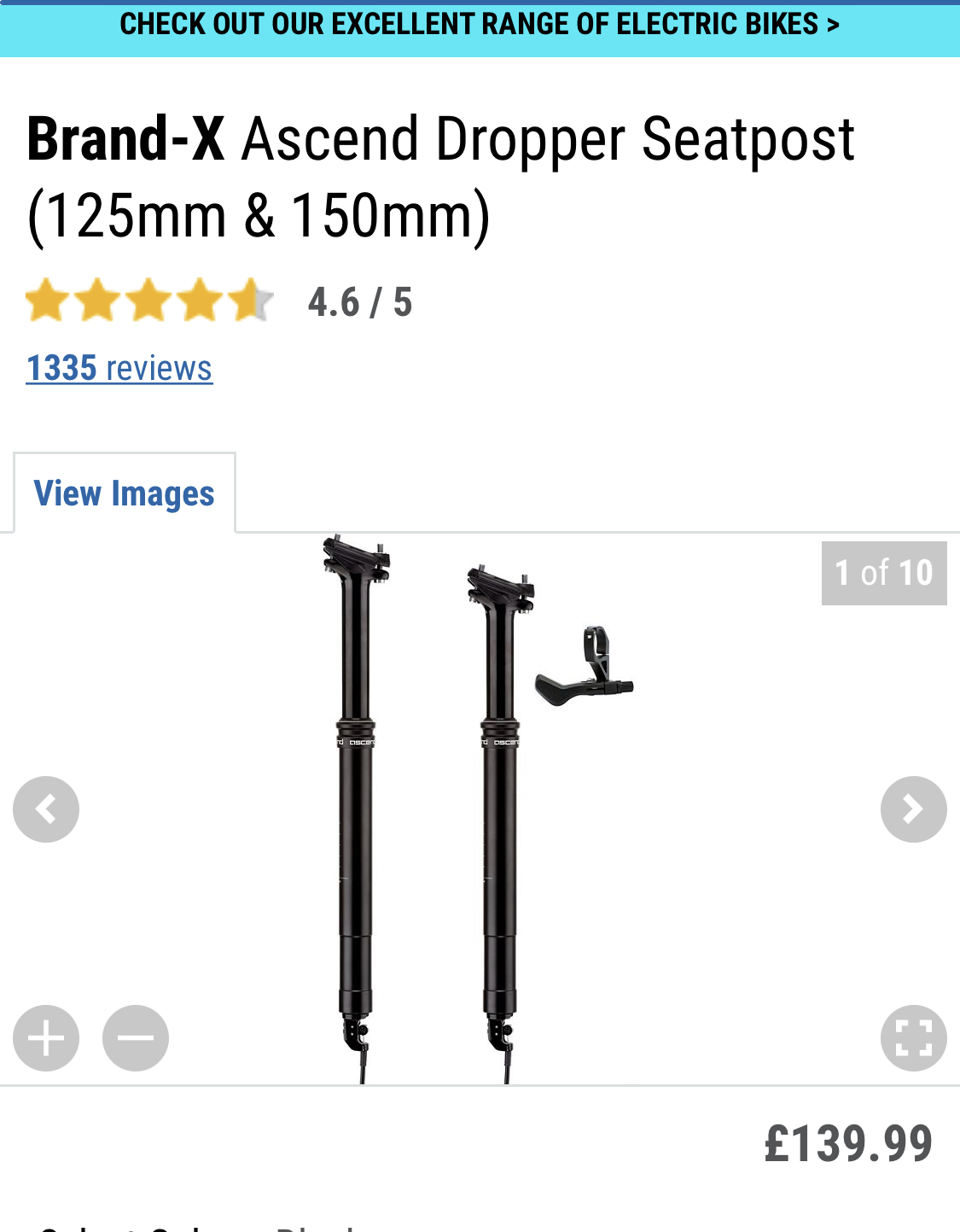

I have the base model and used a shim with the below dropper. Had zero issue and was relatively cheap but routing the cable down the seat tube was a pain, also wasn’t helped by me cutting the outer cable too short and having to do it all again.
