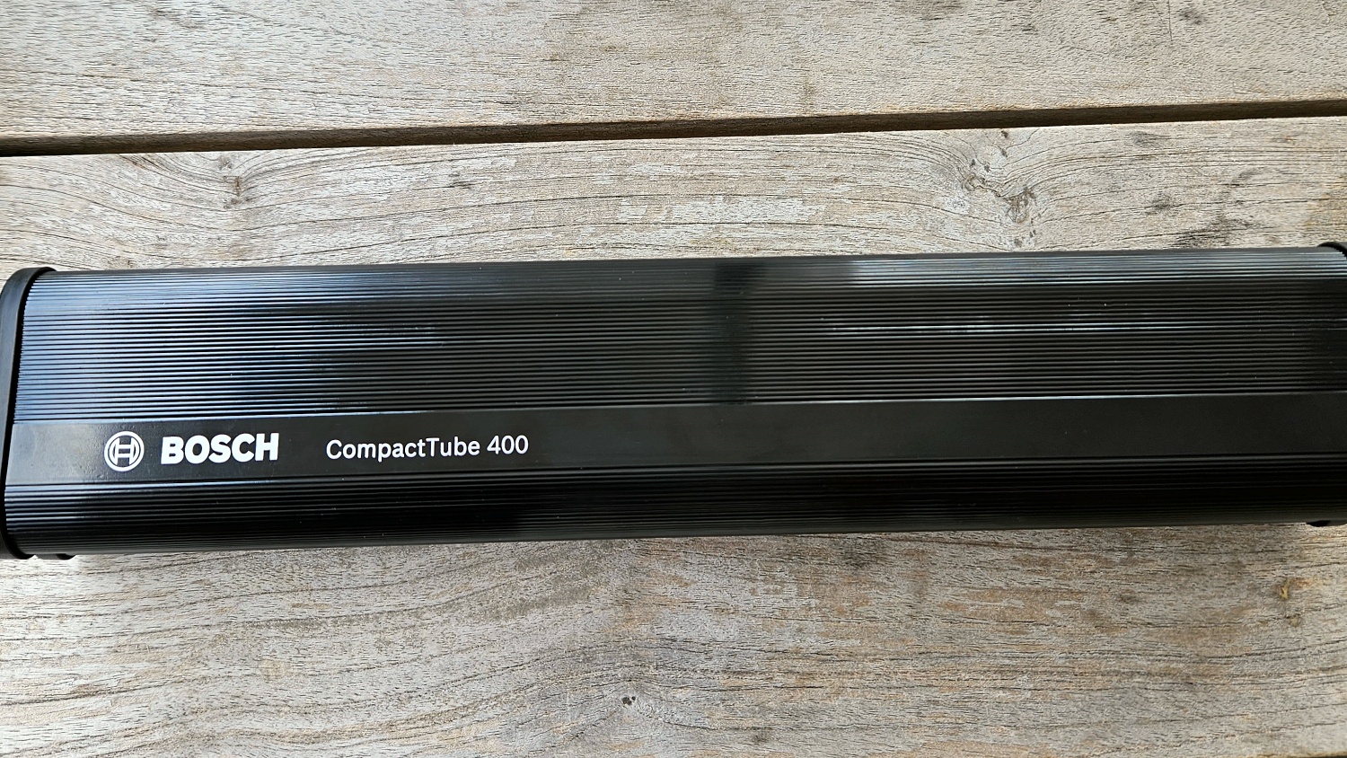

The CompactTube 400 battery​
Years ago, I asked, when will we stop seeing bigger batteries? When will progress in battery tech result in more lightweight bikes, not constantly increased range? The lightweight emtbs are the answer to my questions. Bosch made a new and properly lightweight 400 Wh battery. It’s got the same number of cells that the usual 360 Wh batteries, but the battery cells are ever so slightly larger.
The result is just over 10% improved capacity and a minor weight increase. It weighs just 2 kg, the 360 Wh batteries usually are between 1.8 and 2 kg. And equally as important, the battery is more powerful, allowing it to deliver more current to the motor.

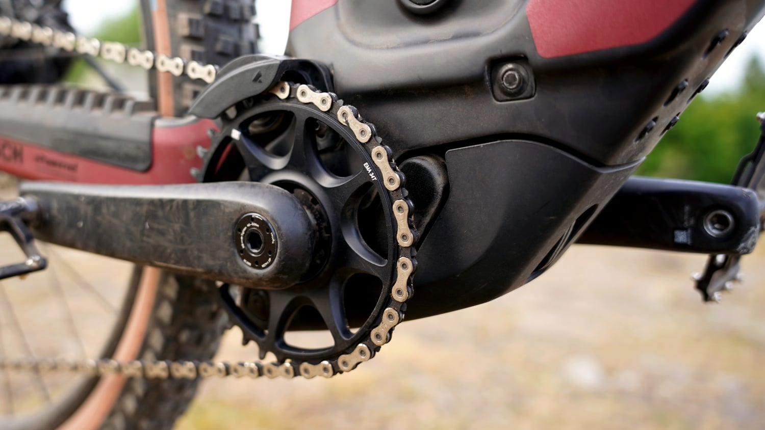

And the motor knows how to take advantage of the increased current capacity. 55 Nm motor torque isn’t extraordinary. But combine that with a high pedaling frequency and you still get lots of power. Bosch rate the Performance SX at 600 watts max, available when pedaling at above 100 rpm.
This 2 kg motor is more compact than the Performance CX, making it easier designing sleek looking frames. The motor isn’t as compact as some other mild emtb motors though. While some can be hidden completely inside the frame, the SX will likely be visible on the upcoming bikes.

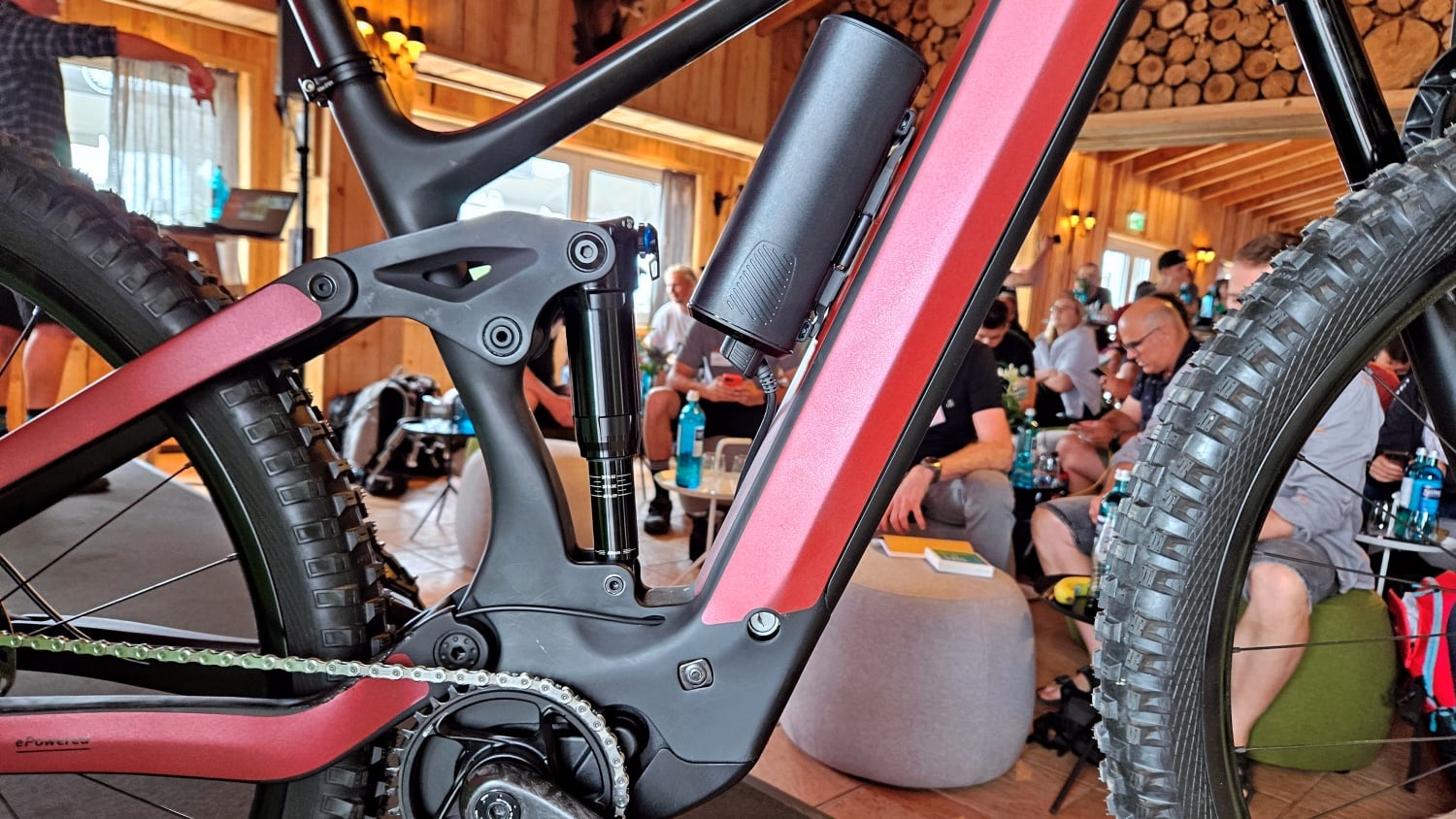

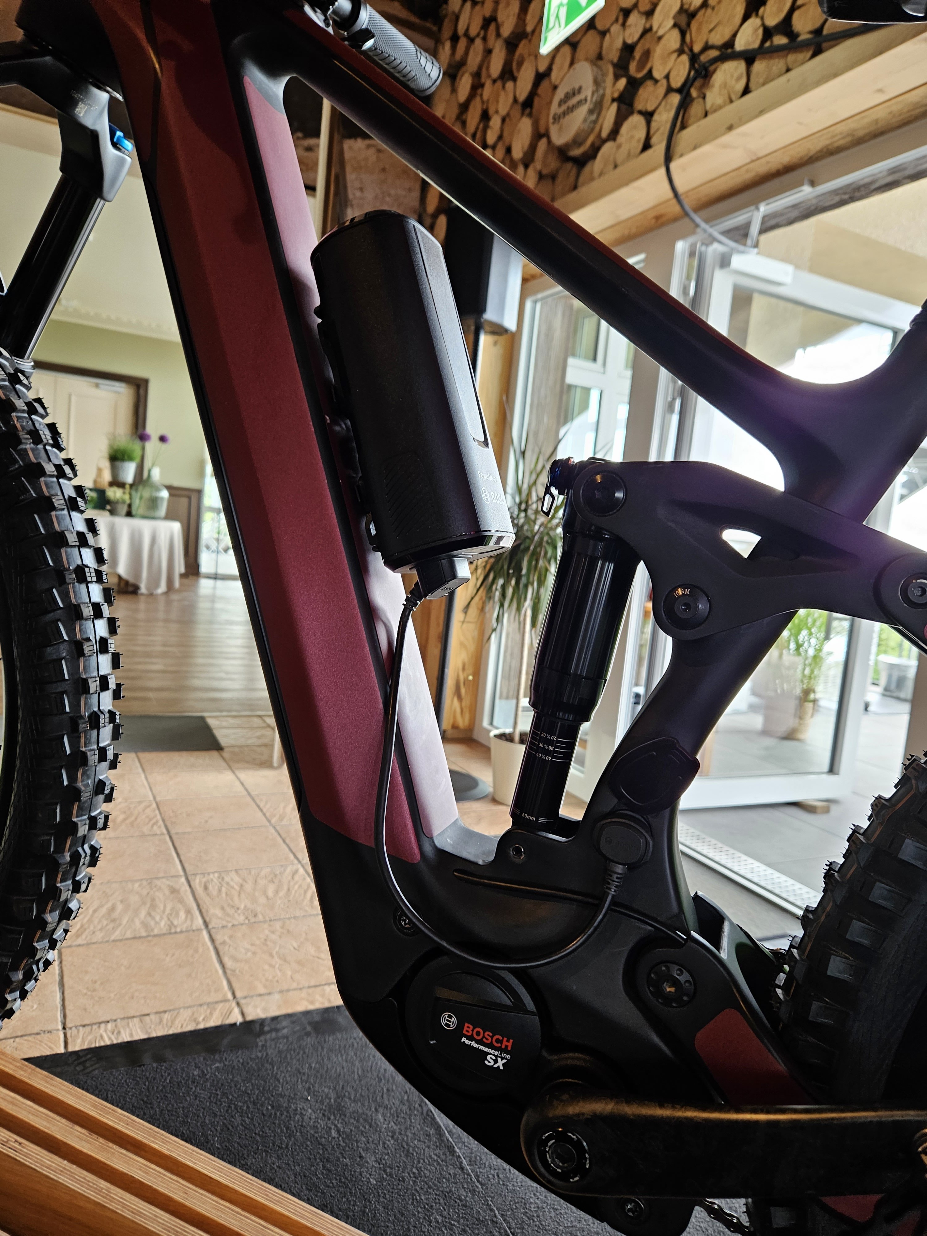

PowerMore 250 range extender​
A 600 W motor can of course be “thirsty”. Adding the new 1.6 kg range extender brings capacity up from 400 to 650 Wh, that should go a long way on a lightweight emtb. The motor will draw power from both batteries simultaneously, which is a good idea. That way, the batteries share the load, resulting in lower heat loss and improved efficiency.
The Paramore, I mean PowerMore 250

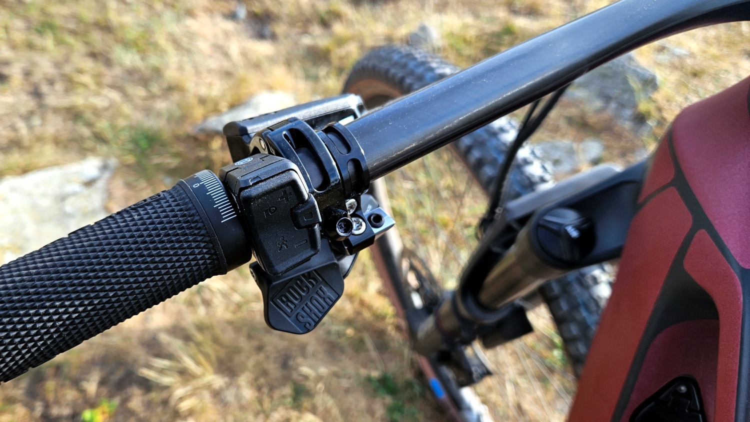

On this particular bike, the handlebar remote was a bit too close to the dropper, making me accidentally drop motor assistance.

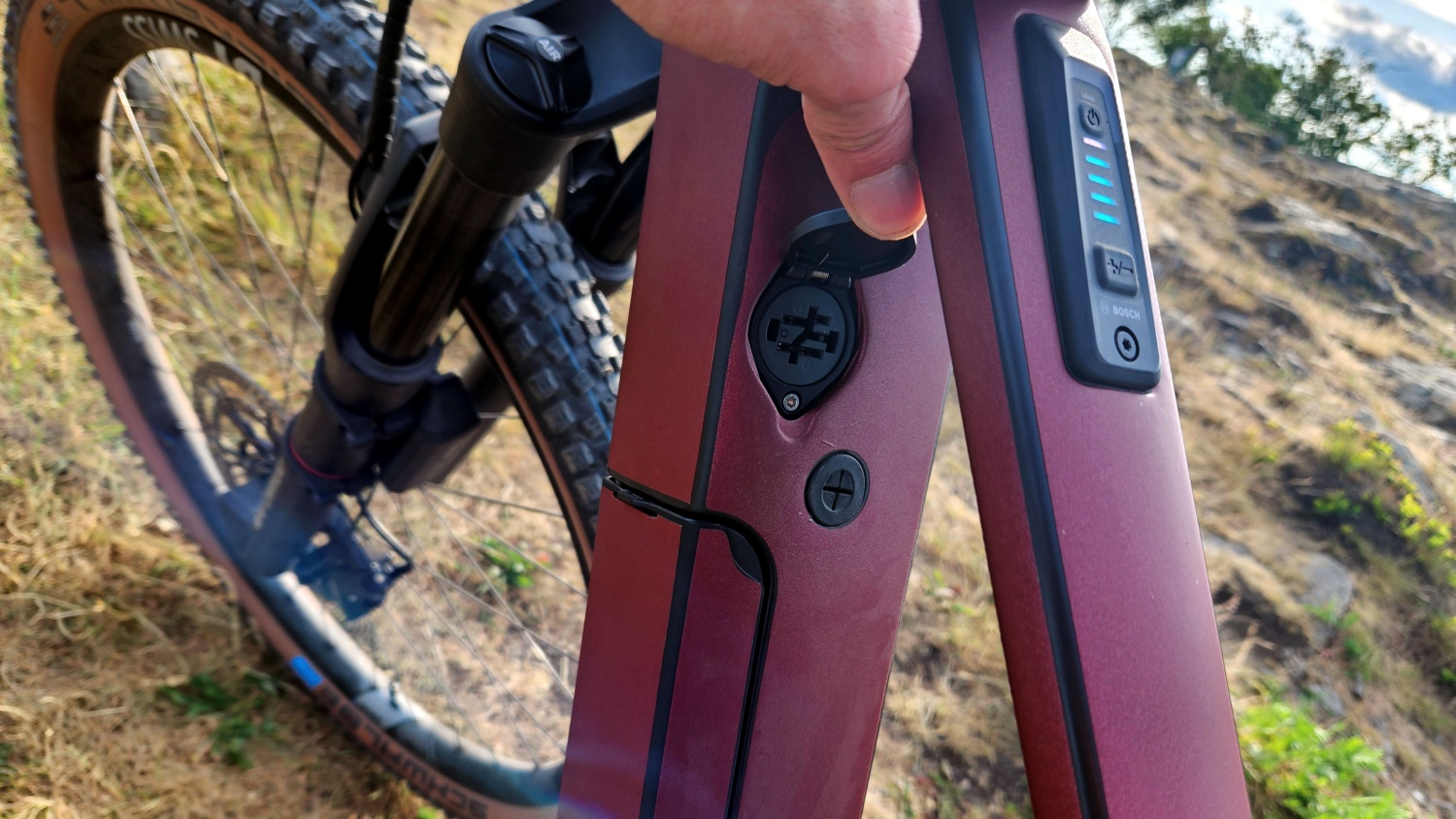

How does the range extender plug in? Through the charging port? Just wondering how it would connect to existing Bosch Smart System full fat bikes.
Yeah, on this bike there's a port on the side of the seattube. They said these are new "building blocks" for the Smart System, so I'd assume it works with the Performance CX Smart System too. Haven't tested though.

On paper this motor is promising, though not as discrete as TQ, Fazua and SL.
The extender though... Too bulky, overall shape is poorly designed. Integration was not a priority it seems.
One would think that the lower top of the RE would be slanted to allow more room for a piggy back shock.
