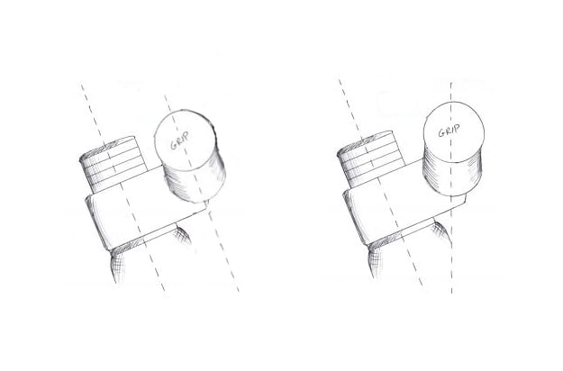

Loads of great info there guys thanks (y)
Re the bar angle, I watched a video that made some sense but I'm going to experiment a bit I think.
The video suggested that a good starting point for the bar rotation is inline with the fork angle. It feels neutral on flat ground and helps keep your weight centred when on steep descents when the bike is tipped forwards.
It went on to say if the bars are rotated to far forward it can push your weight to far over the bars on descents.
I guess with lower rise bars the effect is less obvious but with high rise bars it becomes a lot more apparent?
This is a diagram of how my bars are at the moment on the left, and Mikerb's on the right.

I know what you are pointing out with the diagrams............but it is misleading to go by eyeline. Use a plumline with the weight on the floor directly below the bars and then rotate the bars until you get the highest point on the plumline (at the point on the bars where the diameter just reduces to the smallest). You will then maximise the rise of the bars. Any rotation forward or back will reduce the rise. Rotation back will also reduce reach, rotation forward will increase reach.
More important however are the changes you make to the upsweep and back sweep if you rotate the bars and that will effect the angle of you hands in relation to your forearms.

Thanks for the replies all 👍
The explanation makes sense Mike, cheers. Going to have a play with the bars, I suspect they do need shortening a bit and I'll experiment with the angle.

I've had a play with the bar rotation today, Angled them straight up instead of inline with the forks.
Also trimmed them down by 20mm.
Only had the chance for a quick ride but first impressions seem positive. Although I've shortened the bars it does feel like the reach has increased slightly, I should get used to that. Wrist angle feels a lot better, though I need to have a proper day out to tell for sure.
I'm pretty happy with level positions, grips (ergon GA3) and the seat was one thing I spent a while getting right so I think that's okay. Tilt angle on the seat made a massive difference to how much pressure was on my wrists.
I'm thinking because these are higher rise bars (50mm) I had them angled back too much and it was putting my wrists at a bad angle. Hopefully with the rotation change and shortening the bars I'm on the right tracks (y)
