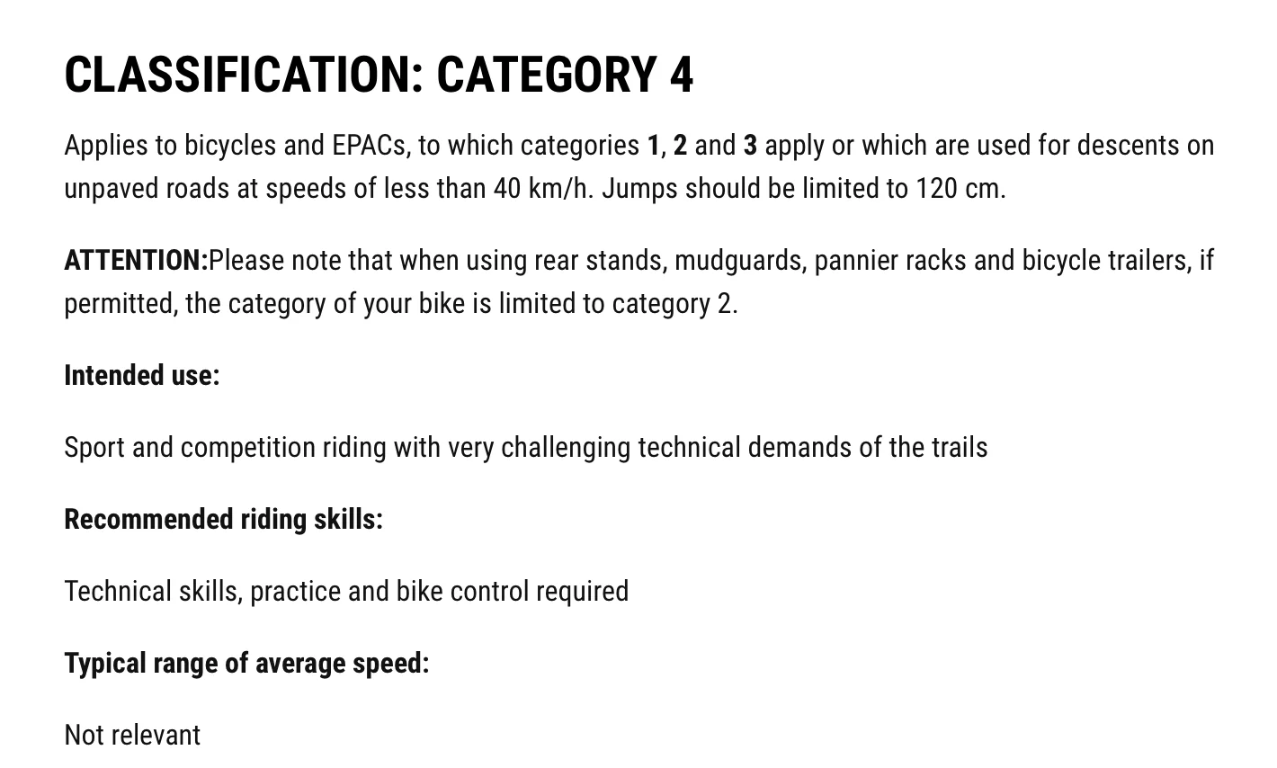

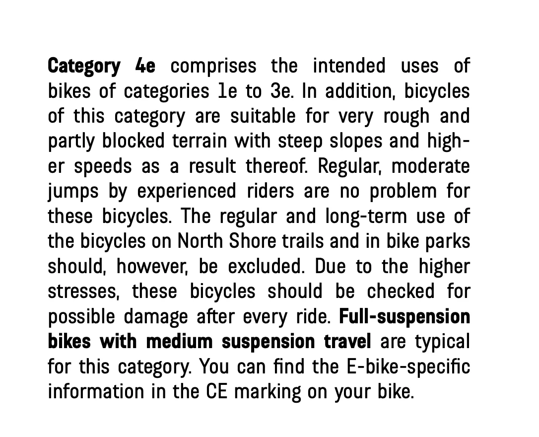

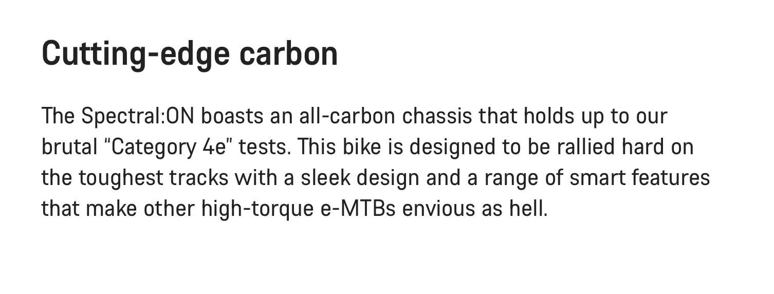

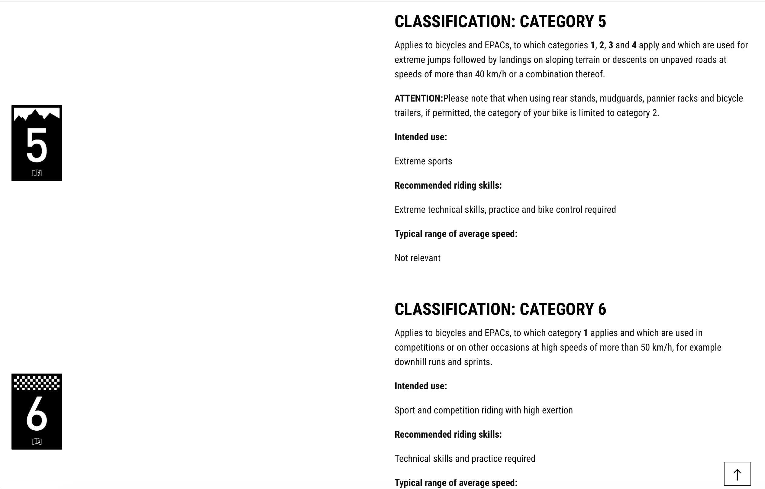

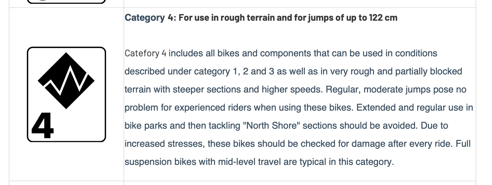

Also, it seems there are multiple Category ratings - I can see ASTM (American Standard), but when it comes to european standard, does anyone know what it is?
From what I can see, europe doesnt seem to have one single universal official Cat 1 / 2 / 3 / 4 / 5 standard that everybody uses - seems some brands use their own interpretation of it?
In fact the more I read the brands category ratings, the more I see that its just the brands making up their own intepretations of it. Here's Cube's, Propains and Canyons:
CUBE (they actually go upto Cat 6!!)

CANYON:
PROPAIN:
