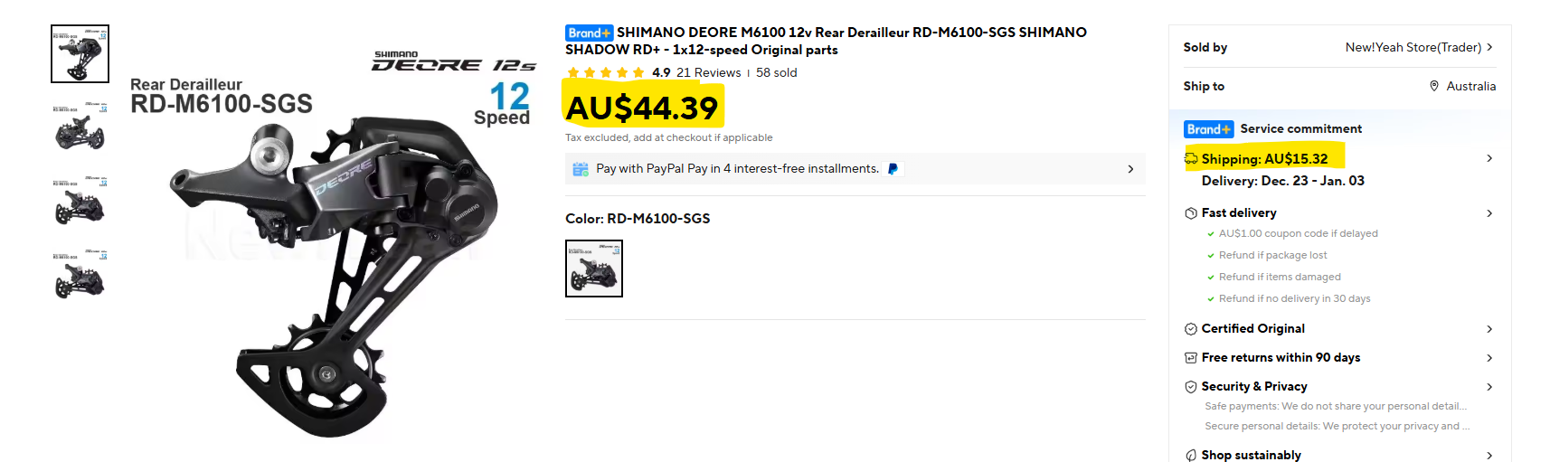

2 things.
1) That's a mechanical derailleur and Jase was asking about Di2. The Di2 derailleur is not $167NZD.
2) If we are talking mechanical derailleurs. The Deore RD-M6100-SGS 12 speed mechanical derailleur is $60AUD shipped, ($68NZD). The 12S Hyperglide+ cassette (CS-M6100-12), (10-51T) is also significantly cheaper than the linkglide (CS-LG400-11), (11-50T) cassette. Sure the Linkglide Cassettte is longer lasting. But I still just changed the Linkglide cassette every 3 chains. Same with the Hyperglide+ if you use the steel M6100 model.
The other thing. The performance difference between Hyperglide+ and Linkglide is definitely noticeable. End up in the wrong gear, and it's going to take much longer to pull the right gear with Linkglide. The shift ramps are much further apart. This is why I moved back to Hyperglide+.
Between derailleurs, chain and cassettes. I don't think there is really going to be a huge cost advantage with Linkglide over Hyperglide+. But there is certainly a performance advantage with Hyperglide+, IMO.
It really comes down to Durability over Performance. If Durability is your No.1 factor. Then sure. Go Linkglide. But if Performance is important. Having run both, I don't think the cost advantage of Linkglide stacks up over Hyperglide+.
