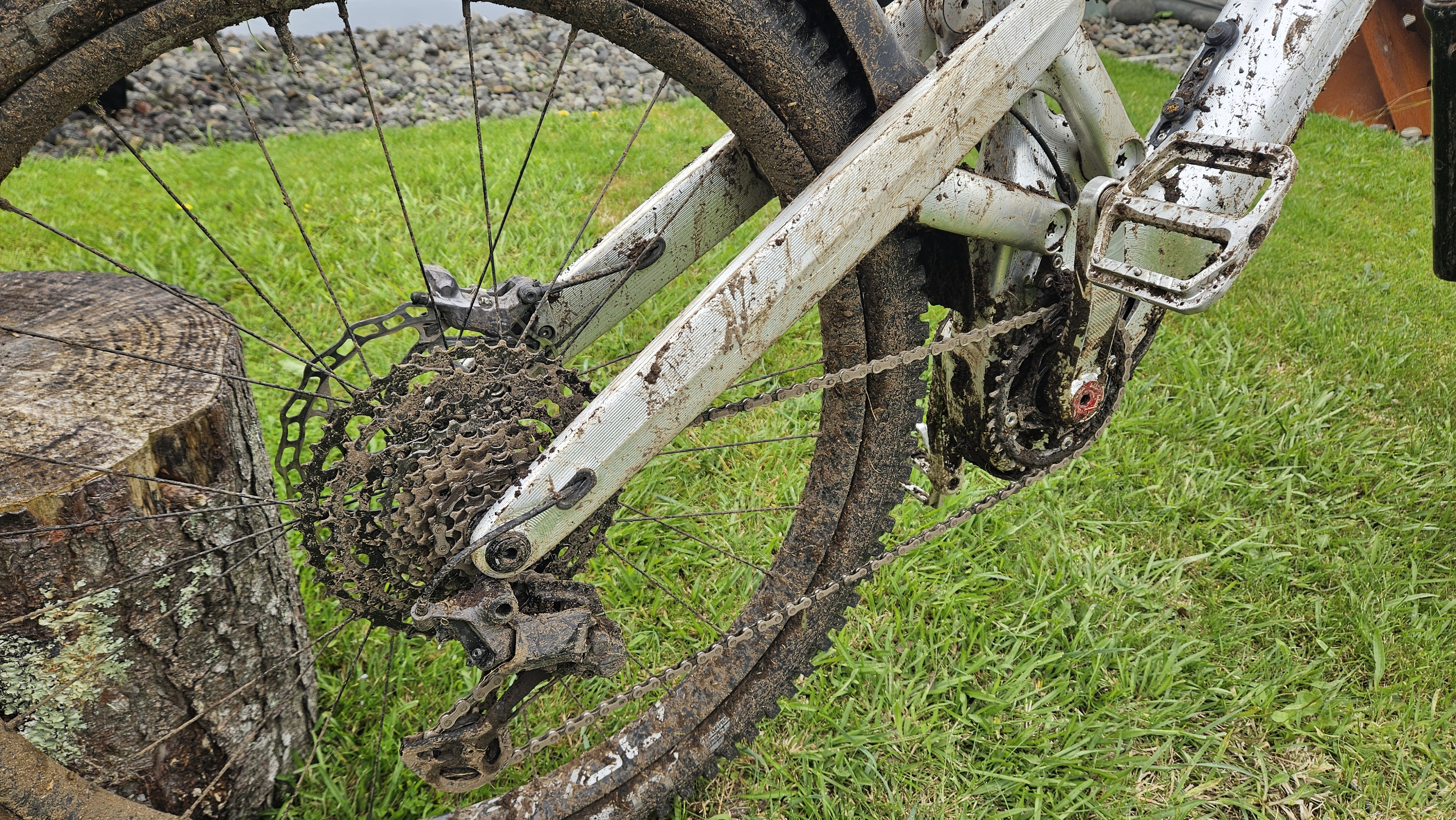

I just ripped off gx 12 speed ans replaced it with 11sp xt linkglide.
Gx lasted mw 1600km in the winter mud.
the full linkglide set up cost the same at a gx cassette and chain.
Linkglide shifts better and doesn't turn to shit in the mud.
I've got about 15 hours on the l8nk glide thus far.
