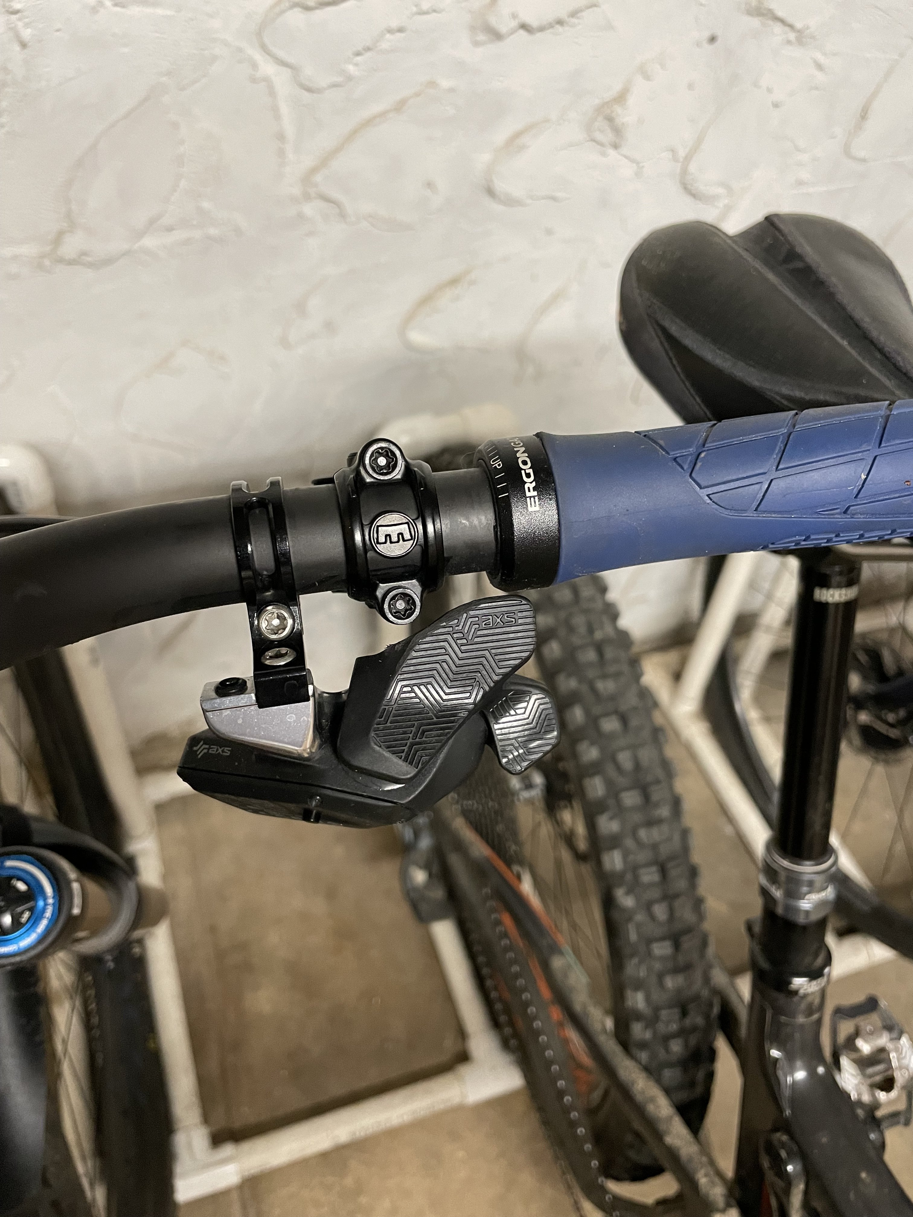

I found the old shifter fits better for me as well, the new bracket for the Pod I could not get in a good place with my Magura MT7
I'm having the same issue. If I put it to the right off the Magura, the POD is almost rubbing against my thumb... and on the left side of the Magura it's just that bit too far away. A bit of a stretch to press it. My brakes haven't moved for about 10 years, so I'm not wanting to move them now...
I wondered if the £60 "Bridge Clamp" would make it more adjustable when hanging it off the Magura matchmaker. I like the feel and the angle of the POD... but it's not much use if I can't get the distance correct!

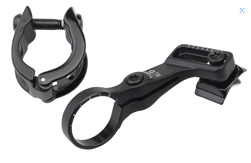

Throw away the matchmaker clamp. Immediately. Horrible ergonomics. Get the AXS-specific clamp with the proper offset, and the Magura clamp. Links below. You'll thank me later.
Not sure this would work as the Magura has the bolt pointing down and the looks like it needs to be putting towards the rider to work. This is the clamp you mentioned?

Not sure this would work as the Magura has the bolt pointing down and the looks like it needs to be putting towards the rider to work. This is the clamp you mentioned? View attachment 118892
Bridge is available for both left and right side.
The general consensus seems to be that the infinity clamp has much better ergonomics...

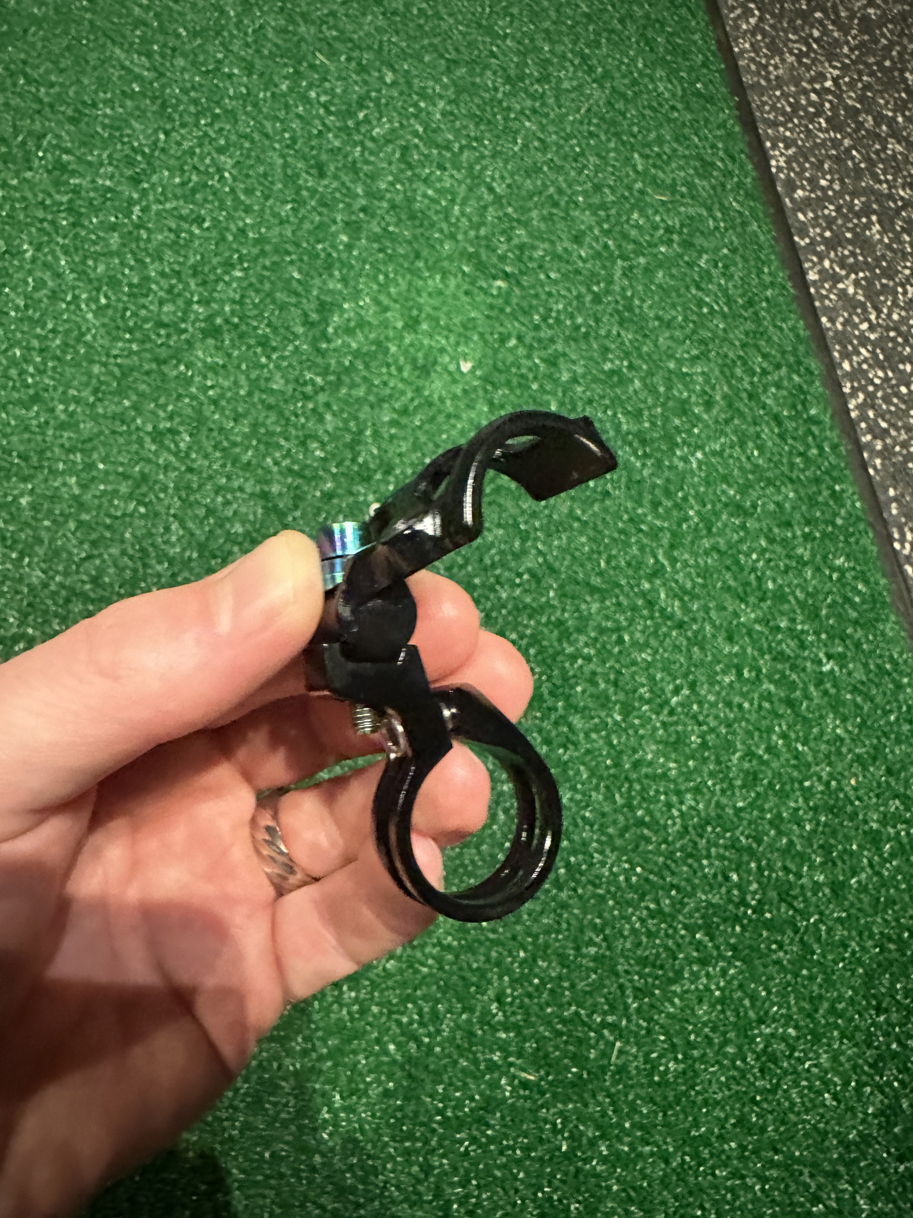

I wondered about that - but I’ve seen a few pictures with people with it going away from you and the POD set further back.
I want to make it work… just not sure how!!
Do you have a picture of it setup?
I have a spare AXS clamp, so I think might try this. Didn’t think about it until I saw above!

Agreed, the Infinity clamp works really well on the new POD's.
What brake levers do you have? I just can't get the infinity clamp into a suitable place with the Magura levers. It needs an adjustment in the middle so you can either bend it closer or further away.
I'm going to play about with it tonight and see if I can get a better option.
Do you like the pods? I tried them and returned them. The paddle version of the older AXS shifter just "feels" more natural to me.
I use SRAM Codes. Maybe I was just lucky as they fit perfectly on the inside of the brake clamp. I've used matchmaker mounts for years, always liked the clean looks and the placement of the shifter was fine with both mechanical and AXS shifter.
Like you I was disappointed that SRAM didn't include the bridge, there was no way I was going to drop £60 on on it so I used the infinity clamp. I now wouldn't go back...
I guess it doesn't work for you due to the distance you run your brake levers from the grips?
