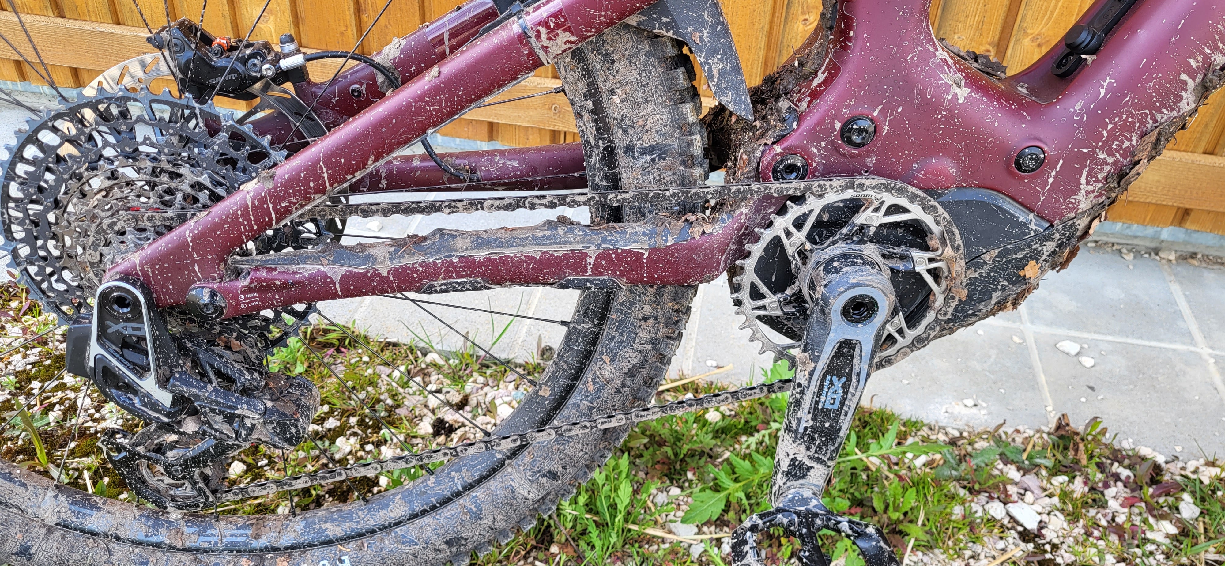

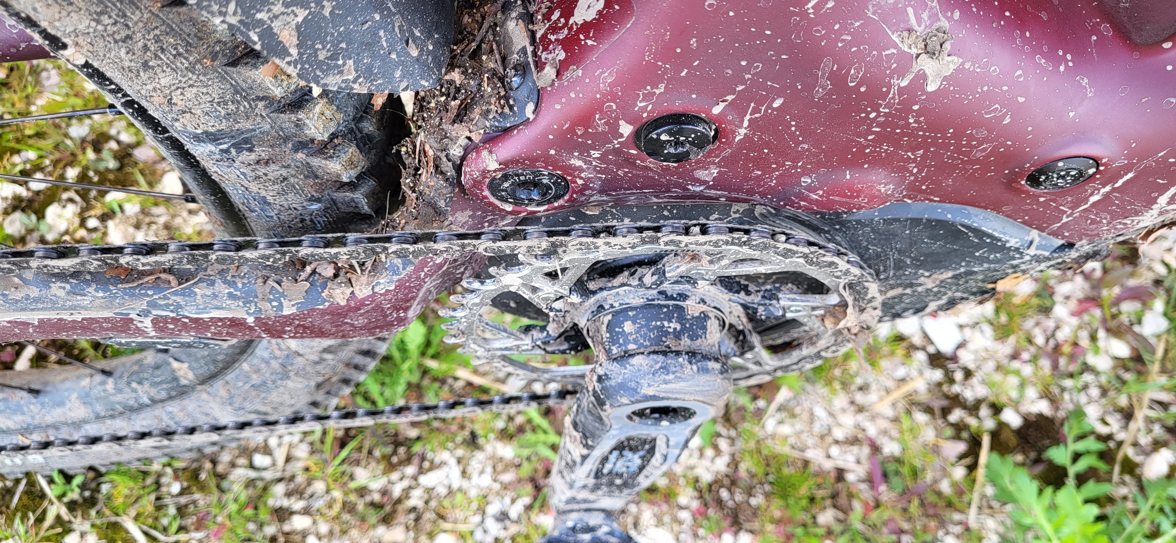

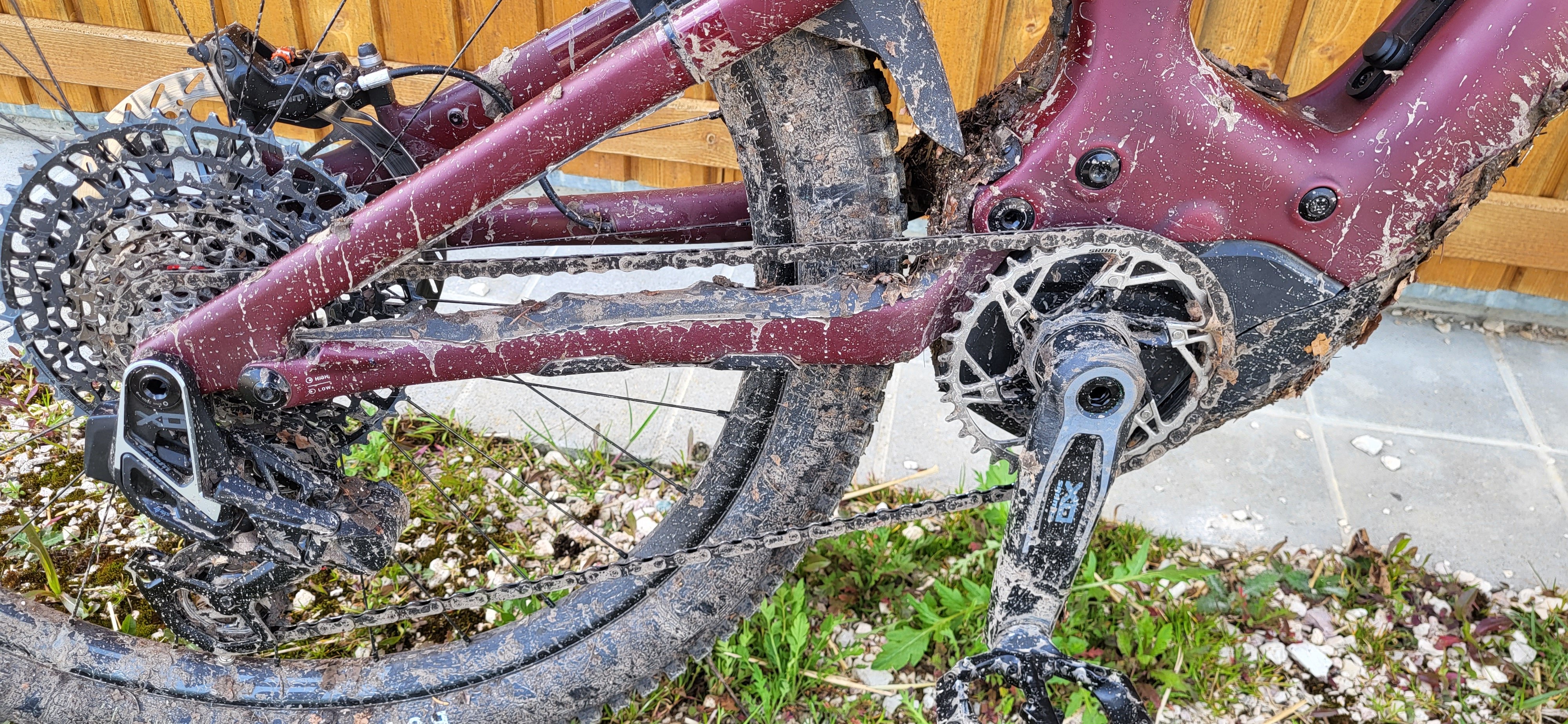

The XO cranks fit nicely no Problem whatsoever! See picture!
