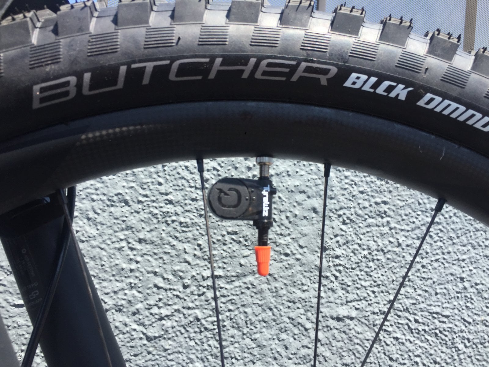

As much as im liking the 2.8 butchers in techy dh and old school trails, Im finding them sluggish to change direction/transition on machine built trails, fast linking hardback clay berms.
I keep thinking i just need more body english to push the bike around, though after getting back on my acoustic ride with 2.35 tyres and liking the way it handles better, and reading here about people riding ebikes on 2.3-2.6 tyres im interested to try something new.

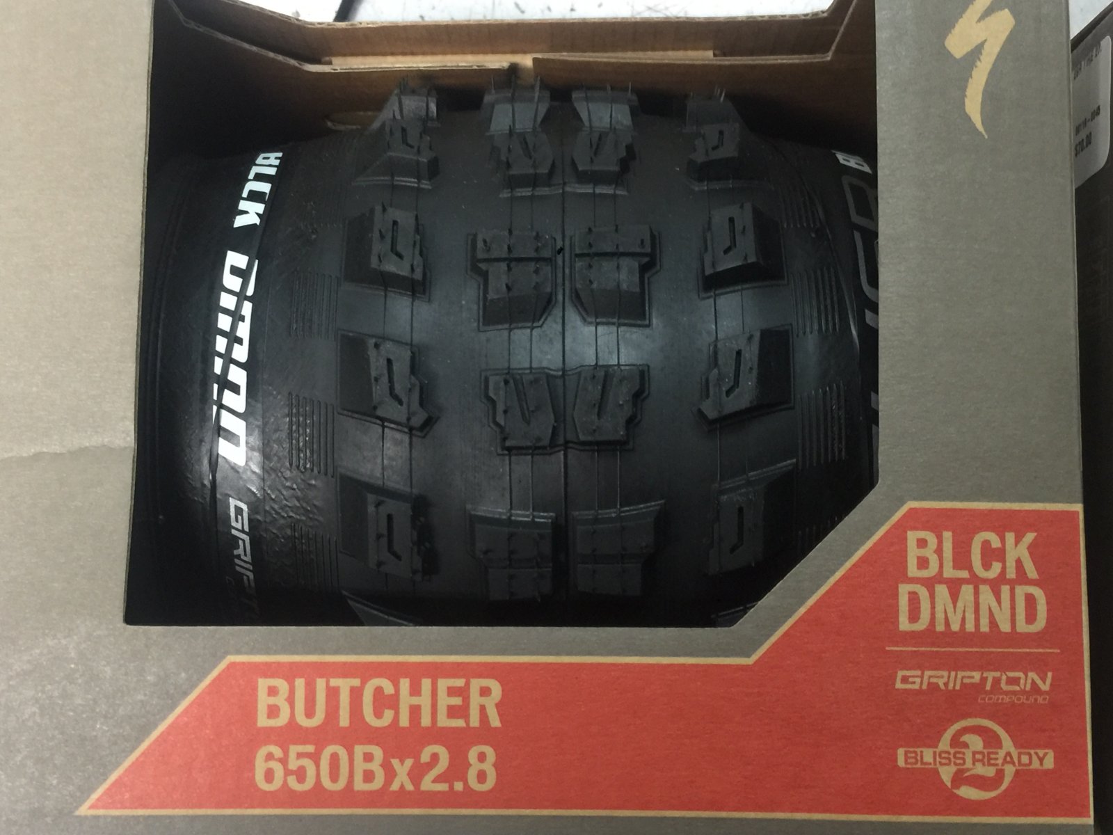

I found the butcher 27.5x2.8 grid casing to be very slow and unpredictable on most dry surfaces.
I took it off after about 60 miles. Replaced it with adex, 2.8 magic Mary, it didn’t roll any faster but sure was more predictable and works well on every type of dirt and mud
250g more then the butcher grid?
Well Butcher Grid seems to average 990g to 1050g per tire. The tire I took off was 1080g and the new one weighed 1230g. I don’t know if the compound is any different from the stand Butcher Grid. But it seemed way grippier doing parking lot cutties.
