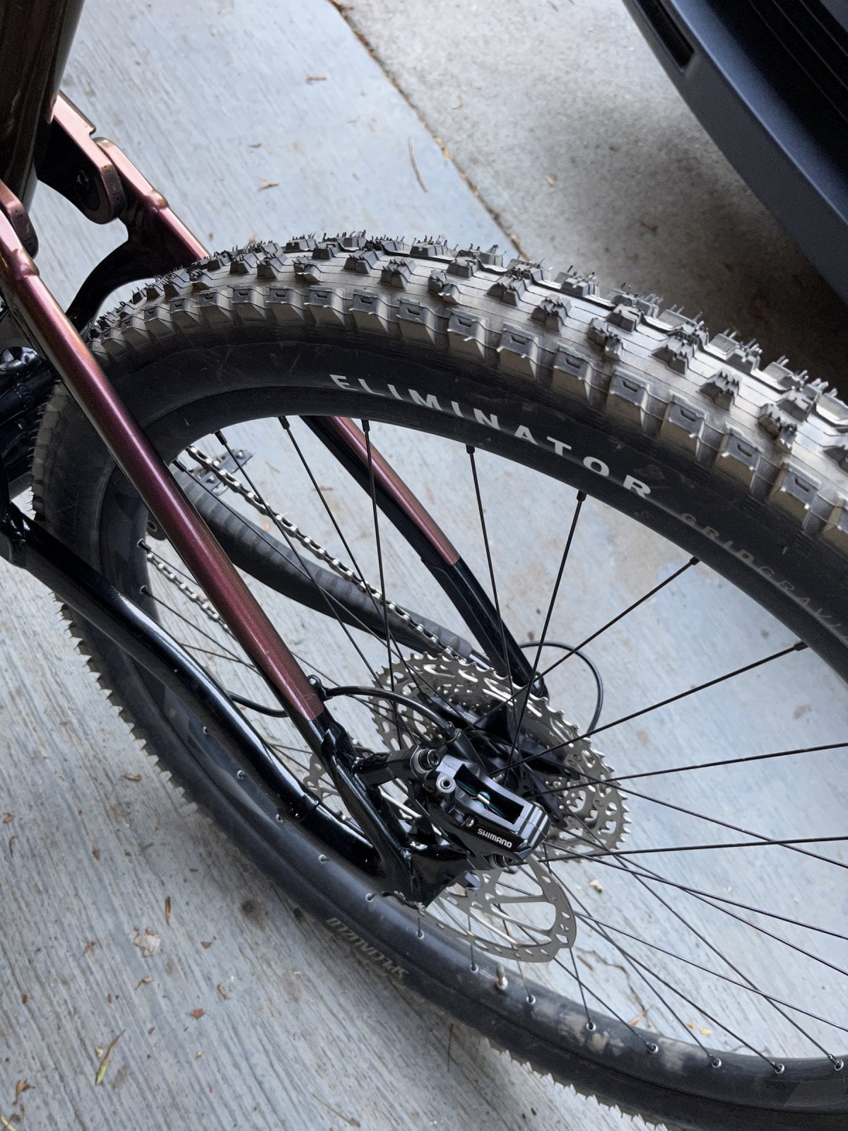

Hi, just swapped the rear tire and sharing some feedback for the Specialized Eliminator Grid Gravity T7/T9 29/2.6. My Giant Trance came with the Maxxis Dissector 29x2.6 EXO+ and it worked well but I wore it out pretty quickly. The Eliminator is MUCH more heavy-duty, thicker all around and weighs quite a bit more. I don't ride much on the pavement but there's noticeably more rolling resistance on the street. On my trails however it's great. Quite a bit more traction climbing and braking especially in dry, rocky loose climbs (typical in Northern California this time of year). Cornering performance is similar to the Dissector, maybe slightly better.
Overall I'm happy with the Eliminator, found it at a LBS on sale for $59. A bit more confidence knowing that it would take a really nasty impact to puncture this thing!

Aggressive looking tyres going by your photos. Would be good to get your opinions on them. Is that the rear specific version?
Yip rear specific, although I have noticed you cant get a front in 2.6 only 2.4.
Hopefully test them out tomorrow or Fri, if I get a chance

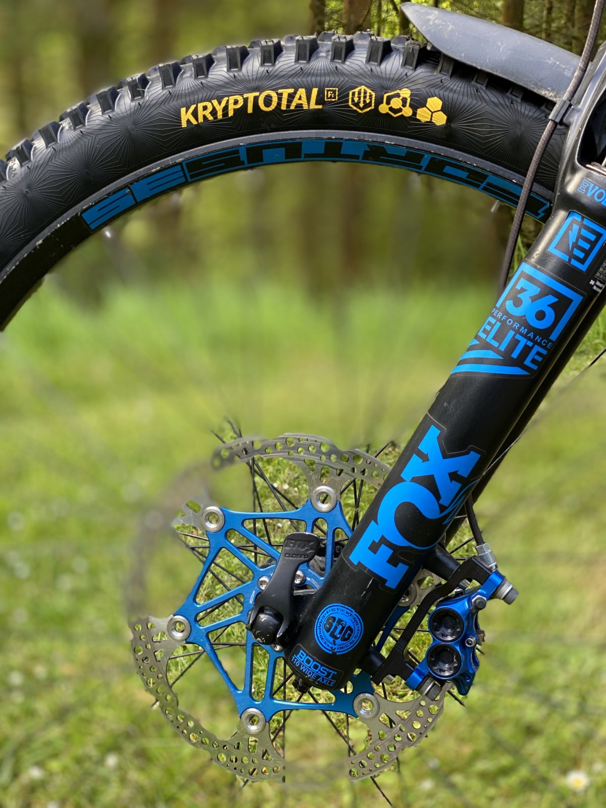

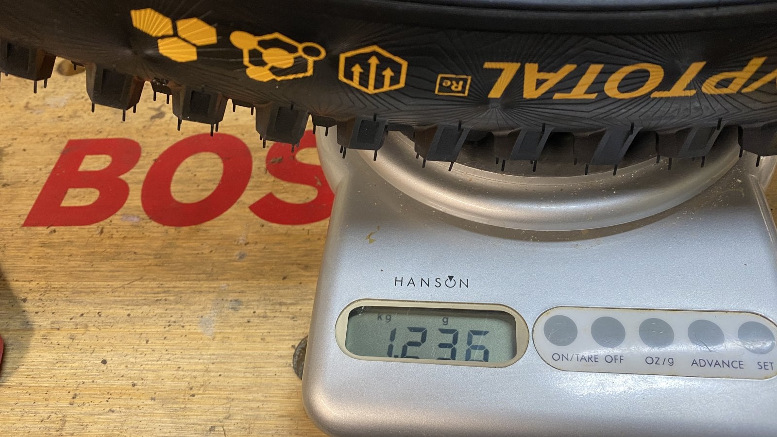

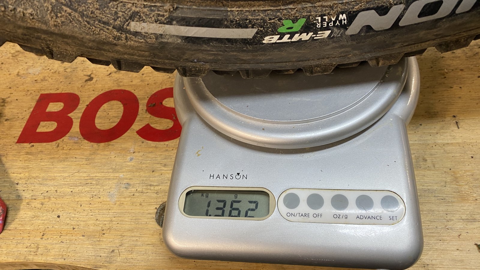

I have been running a MM soft front allied to the Pirelli Scorpion Rear. Never liked the rear, preferred my e-wilds, but I have had an itch to drop from 2.6 to 2.4 for ages so have just moved to the Conti Kryptotal DH Soft rear and super soft front.
I would have preferred soft and enduro casings all round but can’t find any in stock anywhere for weeks so just took the plunge as I want to get on with testing the 2.4s.
Took them straight to Whinlatter where it’s been dry and dusty and find them very confidence inspiring, and FAR more rear end grip than the Pirelli, but then, so did the wild and the eddy current before it.
rolling resistance, oddly, seems fine as I finished my usual 2x full, back to back laps within 5% of my normal power consumption. That surprised me a lot to be honest.
I use the Garmin Gear feature to track mileage of all my parts, chains, casettes, servicing and of course, tyres, so can gauge lifespan of these tyres compared to all my others no problem. Be interesting to see the trade off.
Interestingly, the Conti DH soft rear, is actually lighter brand new, than the Scorpion was worn out!
Importantly, I think they look fast too… 😆
More testing to follow…
