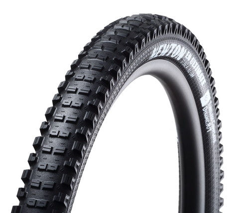

How about the good year newton. Kind of cool that they offer this tire in 3 weights and 2.4 or 2.6 and 29 or 27.5 in any of those options. Weight wise the 3 options weigh comparable to the exo+, dd and dh casings. Looks like a good pattern somewhere close to a dhr2 or dhf. Might have to get a set. Kind of ticks all the boxes. Wonder how their widths measure up? Anyone try them?

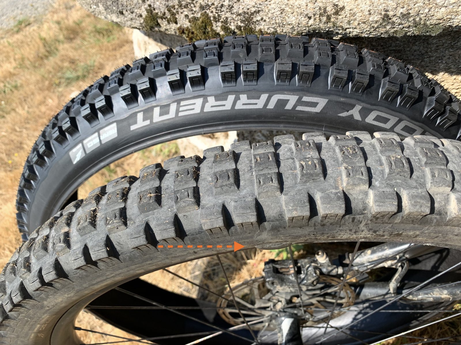

New Eddy Current to replace the old one. About 2000km all off road in all conditions, mainly rocky with occasional mud, grippier than a grippy thing:)
The old one has plenty of life left in it but has developed a blister on the sidewall, ill keep it on as long as possible, i'm
trying to resist the temptation to pop the blister.

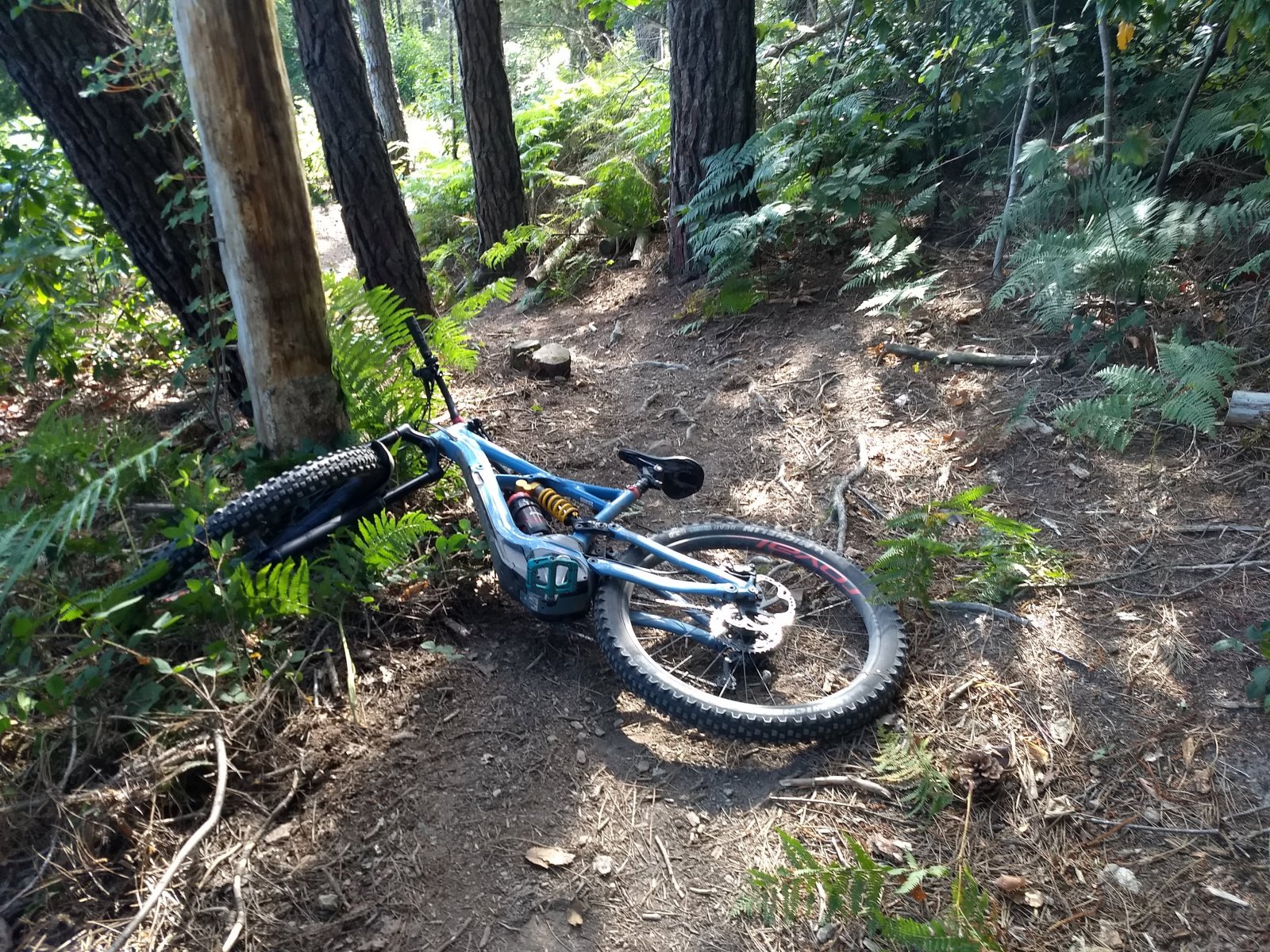

A question for all of you with experience or brains ... I've generally changed tyres (normally from incompetence) or bikes (uhm.. probably incompetence related too) well before the tyre has even lost it's shine.
After a reasonable period of slowly increasing riding ability coinciding with a huge decrease in number of crashes .. I cursed it just over a week ago with a nasty off. Bizarrely I took a photo of the front tyre just before hand for reference.
Still not sure what happened, I think I was taking it too easy came off line slightly, hit the loose and just went down so hard and fast there was no reacting. Ended up chest/ribs into the stump, flip bounce upside down backwards into tree and logs. Unconscious, broken finger, fractured ribs .. bla bla bla .. anyway .. enough off the topic waffle ..

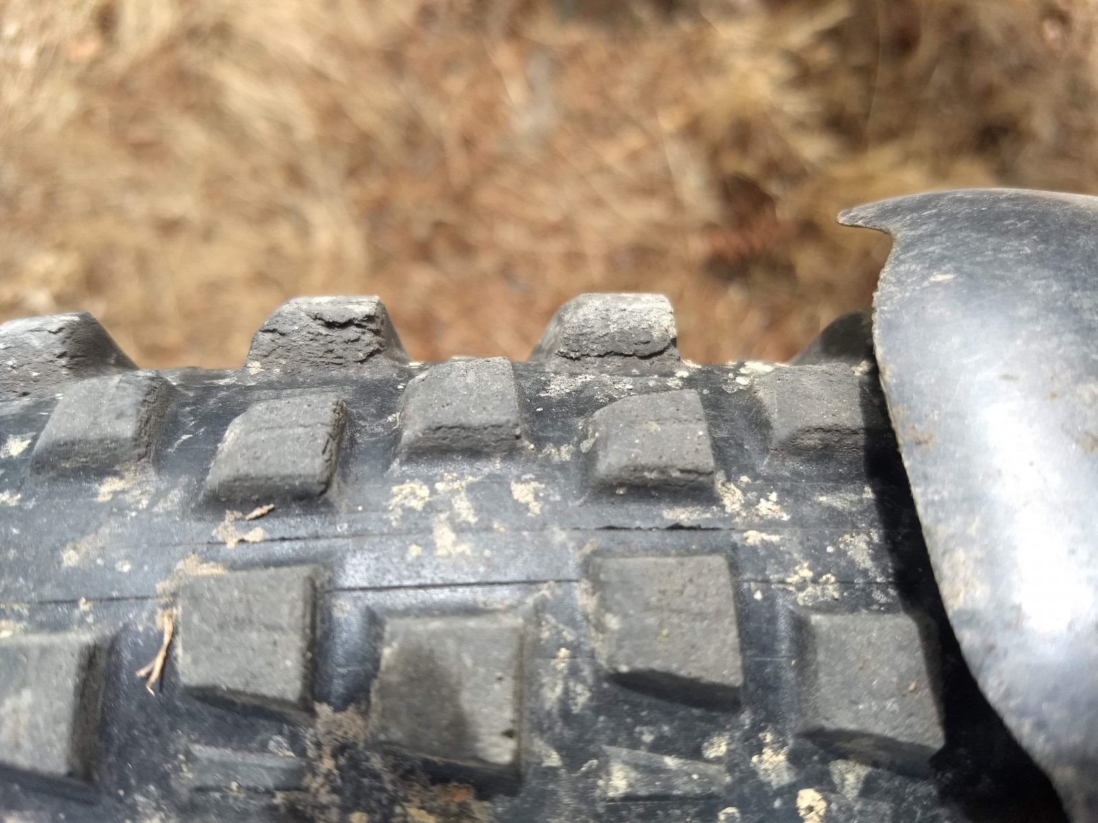

when is a tyre "worn" ??? .. does it loose some performance at a certain stage ? As the knobs get smaller, you'll have less mud grip and so on, but do the performance characteristics of the tyre also drop of with wear or
A tyre wears from every single ride.
the rubber durometer also hardens over time.
a well designed tyre looses performance as soon as the knobs loose their sharp edges.
your edges are fucked on the tyre in the pic above
can you run them down to 3mm and still expect reasonable dry weather performance ?
Depends MASSIVELY on what that dry surface is and what you consider "reasonable"

Those tires look trashed to me. The siping is gone, and the knobs are a mear shadow of their former selves.

All knobs are not created equal ;)
Siping is when a tyre knob has a slice through it allowing the rubber to bend further in one direction. [EDIT: Which isn't strictly what happens or how siping works on motorcar tyres as described in the above Wiki] The alternating square edge knob on a DHF is a great example of this.
Cupping is when a knob is designed to "cup" dirt in a certain direction. (like the L shaped knobs on the DHF that so many other manufacturers have tried to copy but often got soooo sooooo wrong). depending on the direction of the cup this can offer greater traction, braking or cornering stability.
Ramping is when a knob has an edge cut at an angle to allow the tyre to roll (or lean over or transition) better.
Ramping can also be used to create better braking performance.
The old one has plenty of life left in it but has developed a blister on the sidewall, ill keep it on as long as possible, i'm trying to resist the temptation to pop the blister.
I had a similar thing happen a few years ago - it was about a cm cut that started to bulge (using tubes). I used a single patch of cloth tape that covered the area keeping the bulge in the middle of the patch. No more bulge for the life of the tyre. I would have cleaned it pretty will, and probably even pre glued with contact adhesive - it's the sort of thing I do, but I can't remember.
