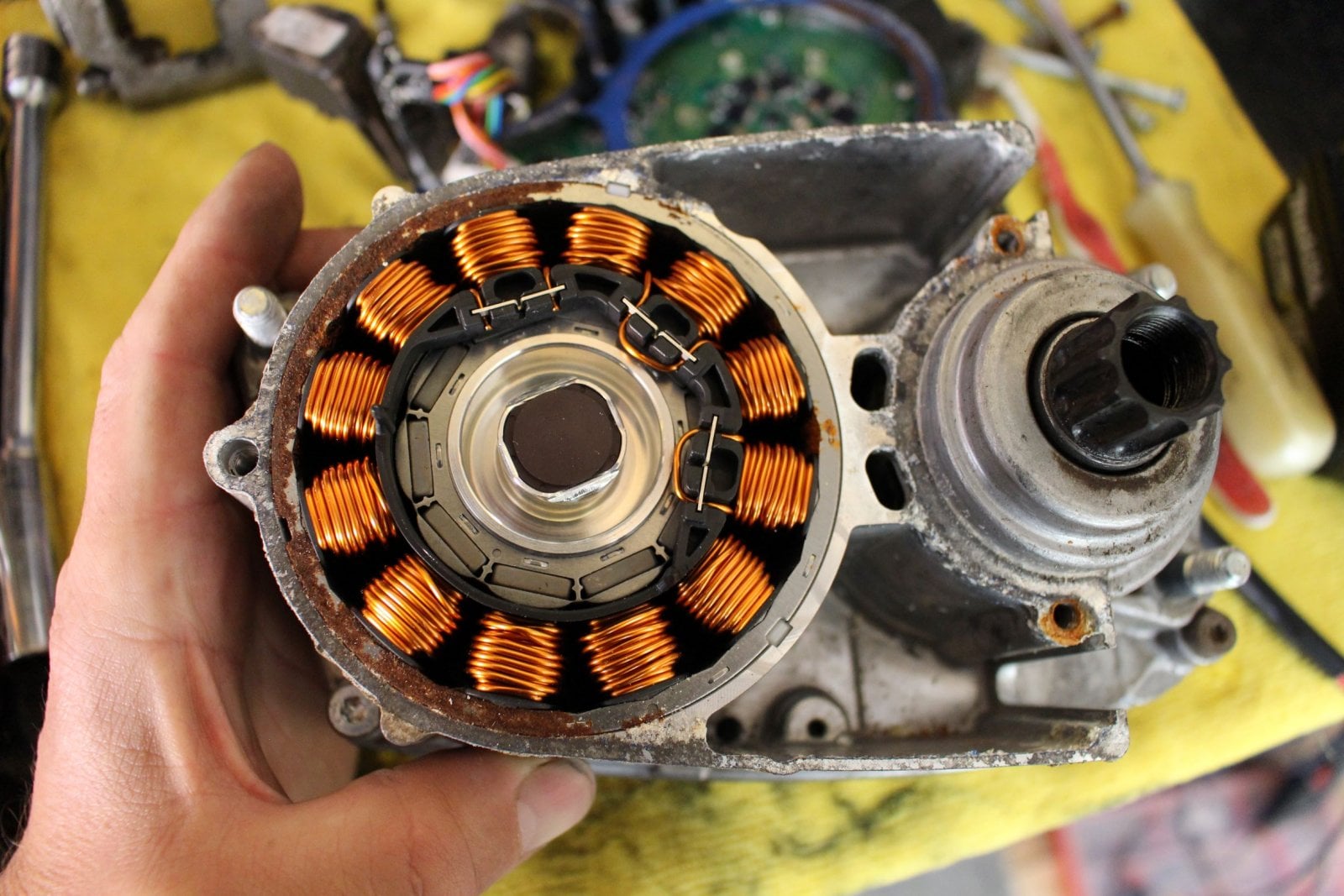

I thought I recognised that dainty hand! What I would like to add to Cheekychops excellent report and pictures is a little bit of clarity for Brose owners. The picture I took above shows several issues that may help hammer home what Cheekychops is saying.
You can see the damage to the gasket face and the rust around the steel motor surround. This is caused because the paper gasket material used by Brose is not water resistant! The water is drawn into the gasket and attacks the gasket face and anything metal it touches.
The screws that hold the ECU (brain) are not sealed around the head, if water comes through here it is free to enter the ECU itself. This part of the cover should have been solid down to the gasket but isn't.
This is more likely to happen if mud is packed around this part of the motor. If water enters the electrical plugs on the motor (it usually does this when the plugs have been fitted dry and the little red O-rings get pulled out of their correct position, or comes down the main power cable) the water in the plug travels up the electrical wire by capillary action and ends up in the wiring plugs of the ECU, and corrodes the pins.
The most important thing Cheekychops neglected to say was why the ACF 50, or the like, is so important on the Brose motor and no other. The aluminium Brose motors eat themselves due to the electrolysis created around the electrical motor plugs. This is why this end of the motor is always corroded and why the cadmium plated screws turn to lumps of rust.
Again, important to keep this area cleanish without water if possible.
Removing the motor and letting it "dry out" won't achieve that much unfortunately. Once water has entered the motor, it is trapped and no amount of warming will release the moisture, it will just turn your motor into a little sauna. Also if enough water is in your motor and it's sat in your bike, the water will stay around the crank area (this can be replaced) If you remove your motor and tip it the other way up, you may as well drop it in the bin or hold the garage door open with it.
