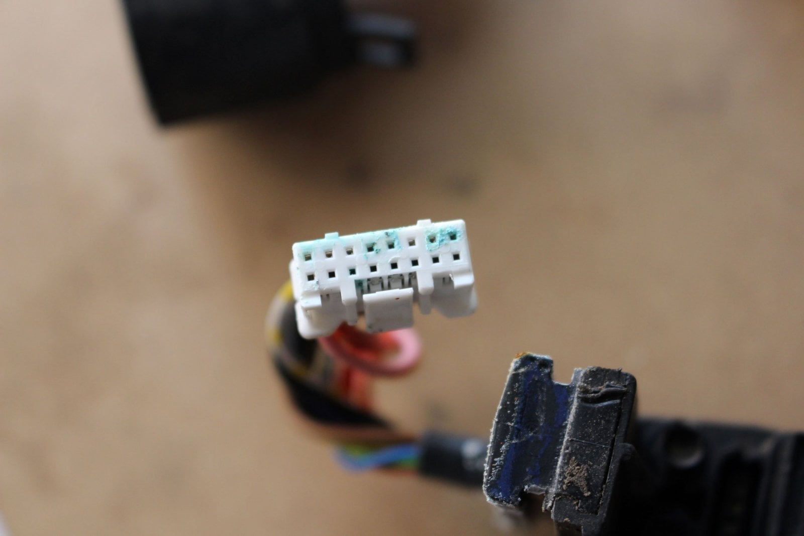

5. IMPORTANT - Remove the motor from your bike before you pedal it, I know it will be tempting to just jump on and ride, trust me on this one. Once the motor is removed spray and wipe the motor and electrical contacts with ACF 50, rust remover and waterproofer. You'll thank me for this......Water will get in your motor at some point, if you cover with ACF 50 then you will just minimize the damage.

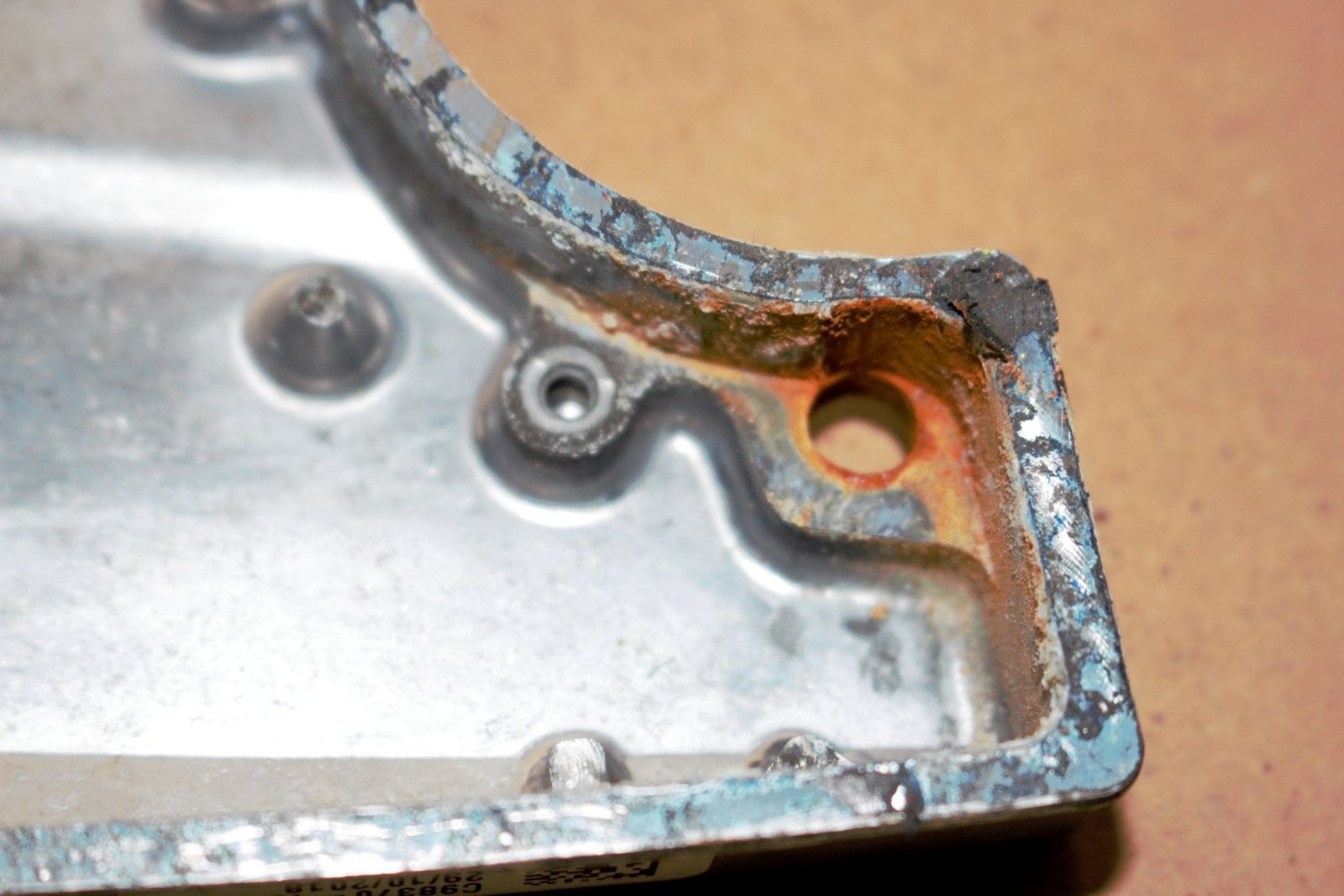

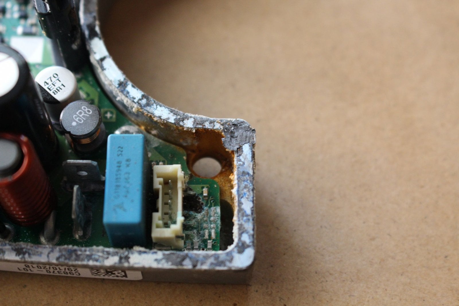

By not doing the above you will get this after 600 miles (scottish winter)
That motor looks like the sort of build quality that comes from China on the cheapo stuff . Unless it’s been ridden in salt water on the beach What make is it ?
Really No wonder specialised had such bad reliability problems , if a basic casing can’t seal out water then it really isn’t fit for purpose . If it was an engine it would leak oil and fail on day one with that sort of build quality .
