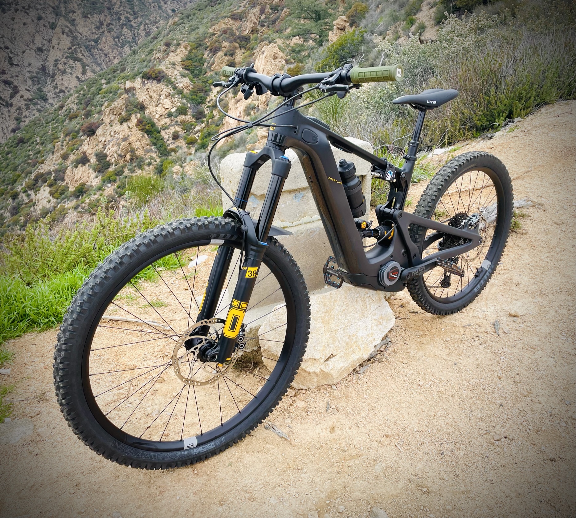

Best Ebike I’ve ever ridden.
The Cascade VPP is so dialed.
Loving Ohlins.
Bosch 750 wh race is 100% Legit.
I also have a Turbo Levo Gen 3.
I was pleasantly surprised how well the 7550 takes steep tight turns.

I really do like the look and spec of them. About the only thing I dont like I'd the leverage ratio. It uses a 230x65 for 175mm of travel. I like lower leverage ratios.
But that's a minor.
I'm really keen to here a more detailed report.

Bummer about the freight charges!
Ive been riding the bike in steep chunk.
it’s so fun.
It’s being ride wrapped this week.more to come
