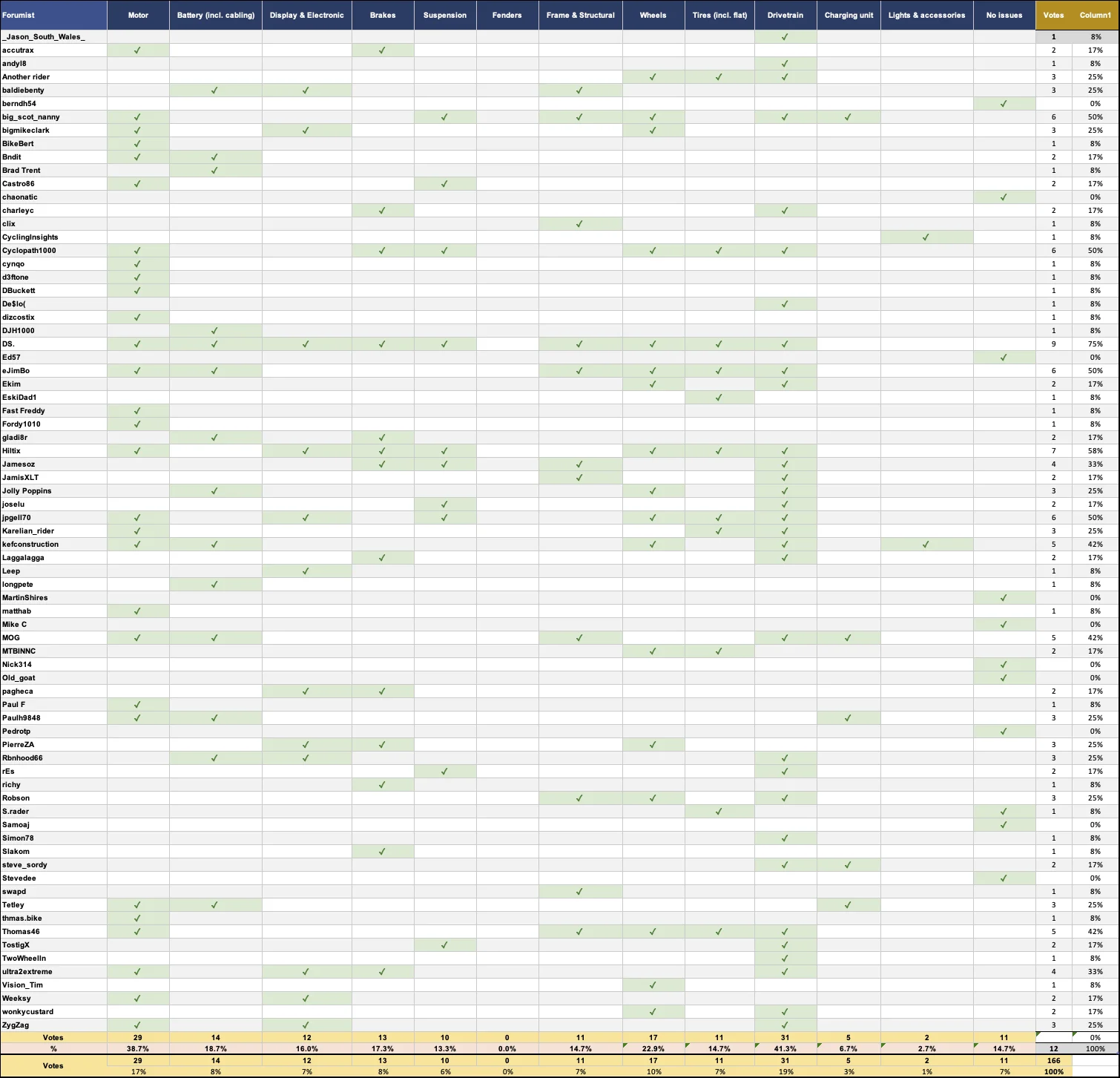

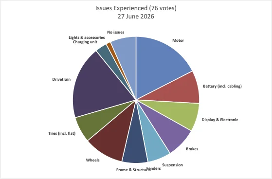

What issues have you experienced on your e-MTB?
What issues have you experienced on your e-MTB that required assistance?
  • Motor
  • Battery (including cabling)
  • Display and Electronic (mounting clip)
  • Brakes (including excessive noise, but not regular pad wear)
  • Suspension
  • Fenders
  • Frame & Structural
  • Wheels
  • Tires (including flat tires)
  • Drivetrain (derailleur, chain, chainring, cassette)
  • Charging unit
  • Lights and other accessories
  • No issues so far...
Results are only viewable after voting.
