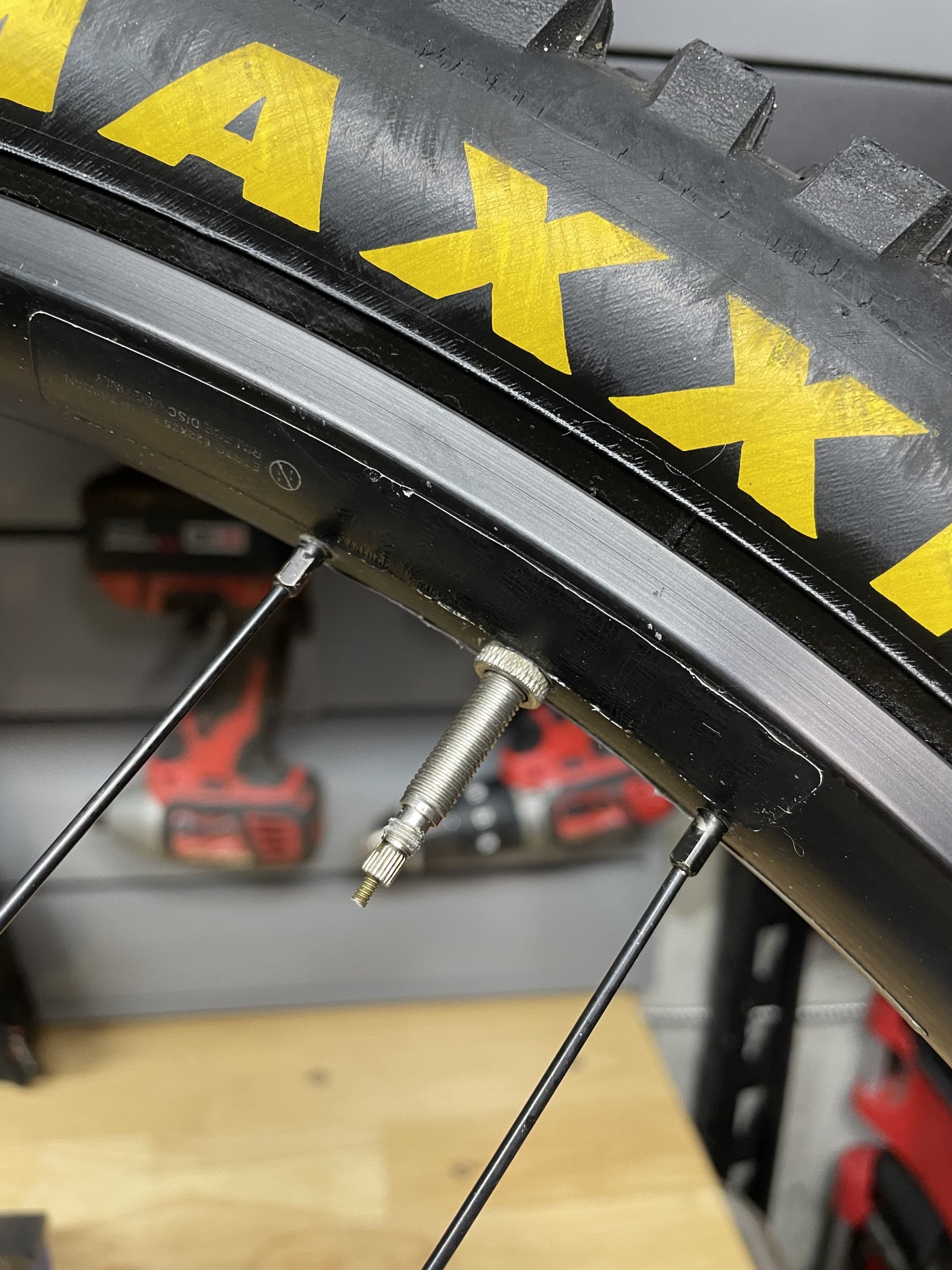

I’ve never had success with injecting some sealants through the Filmore valve. After 10-20ml it clogs up. Now I just pour 80-100ml of sealant directly into the tire (1 bead off).
I really thought it was a spring but I guess the psi keeps the plunger valve closed. 🤷‍♂️
Answer: Fillmore valve 1mm internal passage is self-evidently too small for a sealant with a larger particle size.
Being required to pour sealant directly into a bead-off tyre in order to get around a Fillmore valve design problem is taking the piss. Not for me, as said before it's back to Presta valves, at least the cores can be easily removed.
Sorry, missed this ^^^
There's a thread on the top of the Fillmore poppet valve and a matching thread inside the cap. When the cap is screwed on it pulls up the poppet valve thus closing it.
Stans easily injects through a Presta valve with the core removed. It's not gritty or has particles in it but if you want to reuse the syringe, wash it out after or the residue will dry to little rubber lumps & you'll be off to Ebay before you can say rim tape.

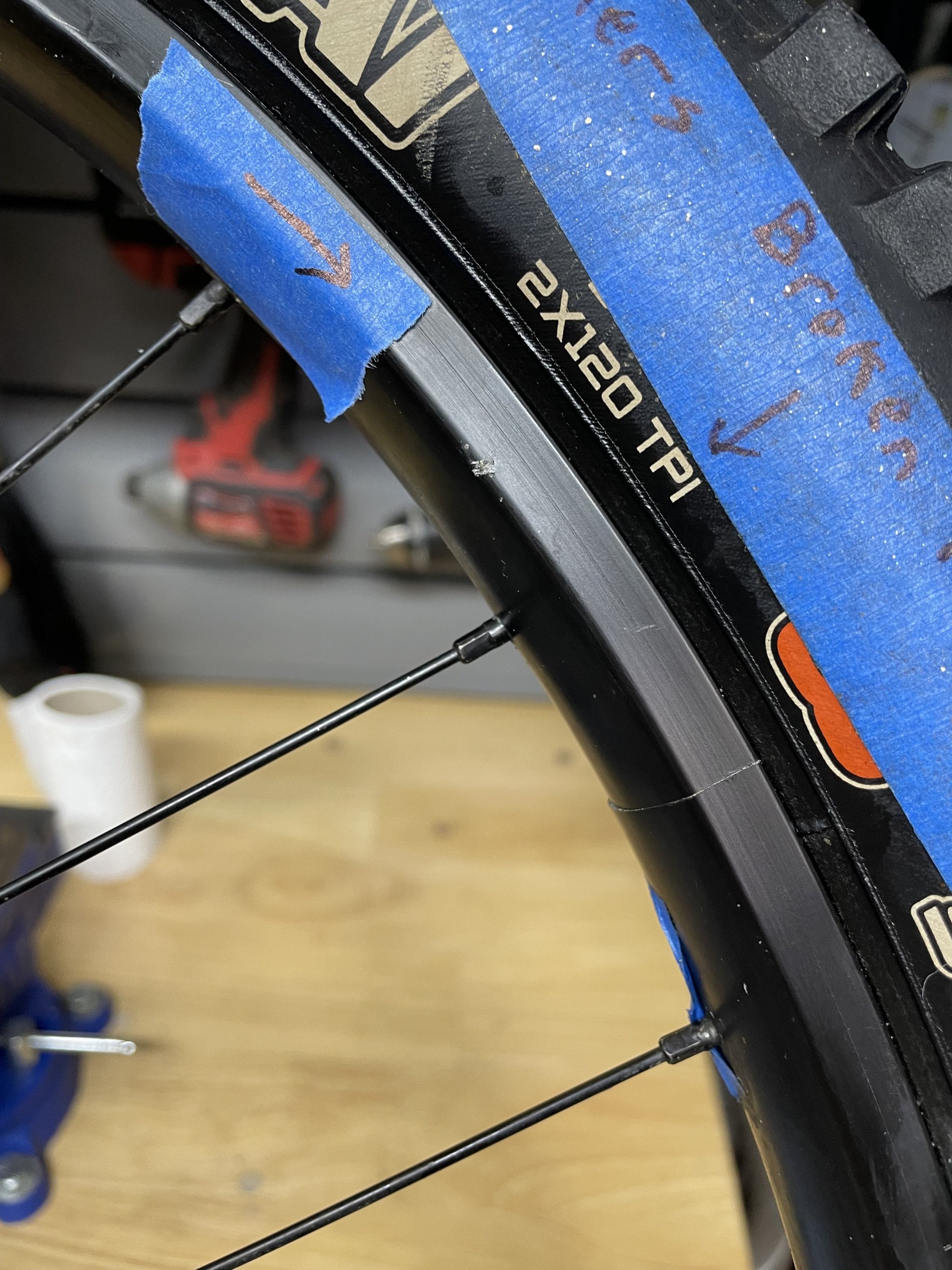

A tire I fixed wasn’t that bad but the Bontrager sealant had completely dried. This was the original Bontrager alloy rim on my nephews Trek. He bent the rim edge so it would no longer hold air. Of course he had a race in Whistler the next day 🙄. I lent him one of my spare wheels (complete) just to get him ready. I decided to try and fix his front wheel later that week.
It took a while but eventually I straightened the rim edge with some weird pliers. Reinstalled his tire, added some Bontrager sealant (150ml injected through the presta valve).
Inflated to 35psi, spun the wheel and started checking for leaks. Damm! Some air was escaping at the dent and the side joint of the rim edge. Spin the wheel some more and hope the sealant does its job. Success 🙏.
The joint on the rim is a concern and I would recommend replacing the rim. But it seems to work. He works now (plumber helper) so he can bare the cost of a new rim.
