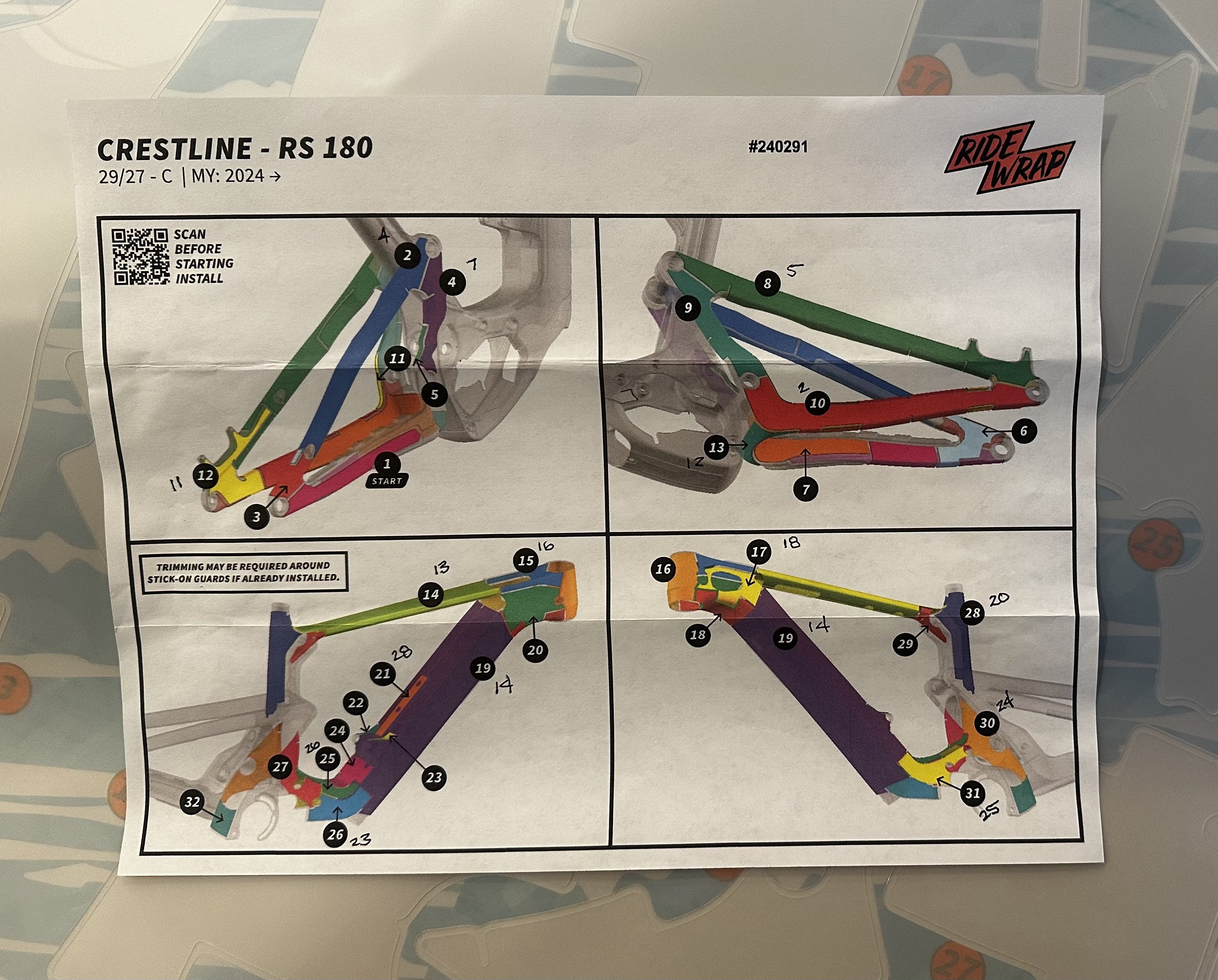

As the title says, the install diagram, for the custom fit version, that tells you which pieces, on the big ‘ole sheet, go where is totally wrong except for #1 😤😂😣
I will post a full renumbering once I figure out which little squiggly piece goes where.

Ok, so the big thing to know is that they combined piece 1 & 3 into a single piece but that didn’t just throw everything off by 1 number…oh no, it’s like they sniffed a bunch of model glue and went for a totally inconsistent numbering scheme.
Good thing I like puzzles because a lot of the shapes are so seemingly random that it became a process of elimination to figure out what went where for at least 3 of the 32 pieces. 🤦🏻‍♂️

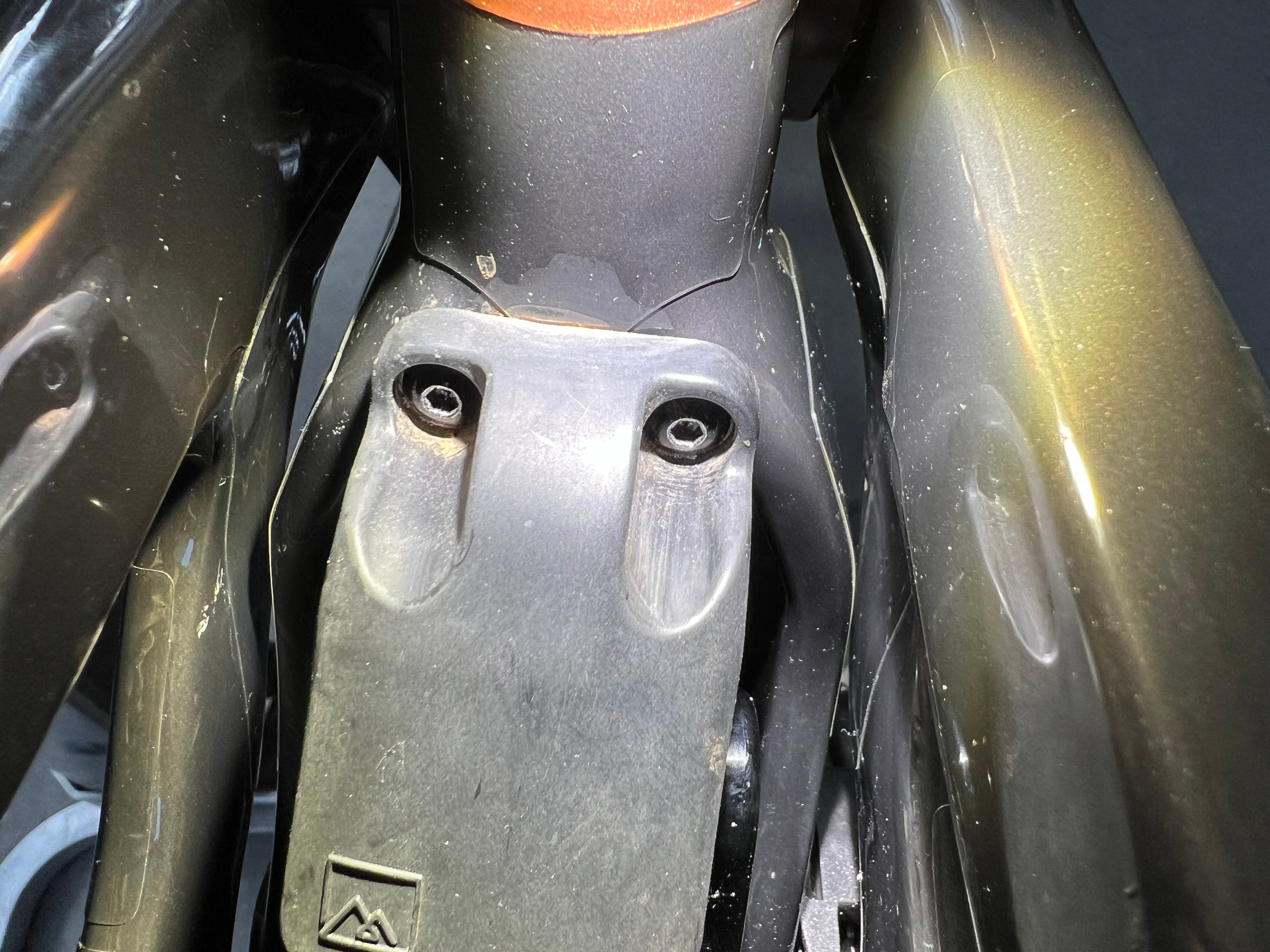

Quick question. Did you take off the chainstay protector and then put it back on once you had applied the ride wrap?
Does it stick back on ok? Any tips 😀
Arethustra
Apr 22, 2024
51
39
Bay Area, CA

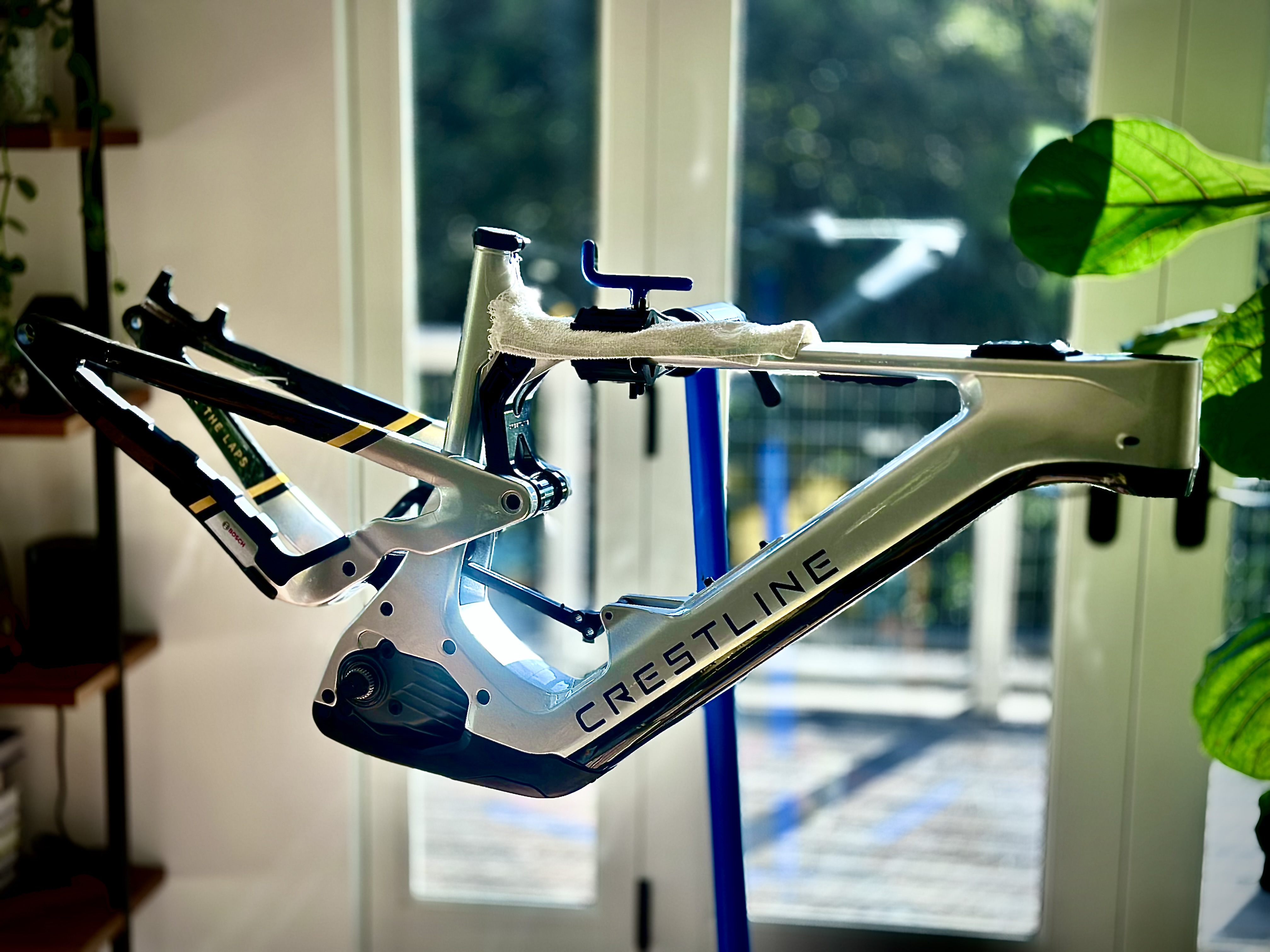

My bike has just arrrived! I see that the chainstay is not yet attached - yay :)
You don’t need to take off the chainstay armor; the film piece there fits perfectly in between the upper and lower portions.
Might actually be more annoying to try and get it in place without than with with the chainstay in place as you’ll need to guess where it will be.
Mine was already installed and I had no issues.
I was also going to say that I bought some additional frame protector film and have been adding in a few extra bits as they don't cover some of the places I always get branch hits like the very front of the upper pivot on the rear triangle (just above brake hole for the brake hose)...when you finish your install you'll probably see what I mean. Good luck with the wrap install! I have mine out baking in the sun so that I can dry up the bubbles that are filled with install solution (hate this part) and then deal with any air bubbles. Also decided to wrap my new Zeb since it's super high gloss and looks like it will be a scratch magnet...

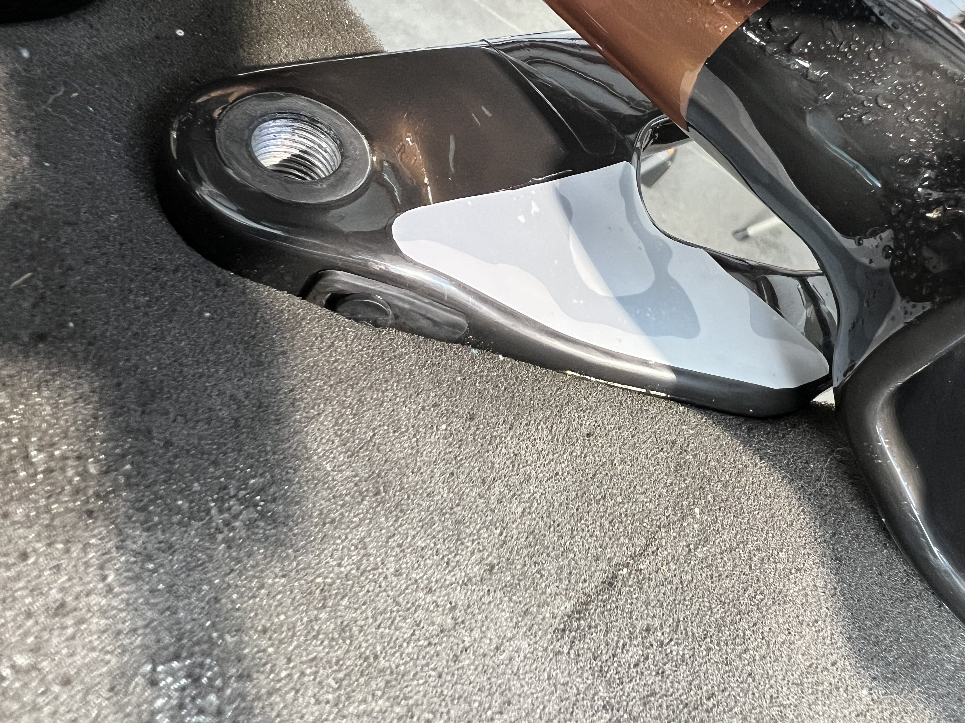

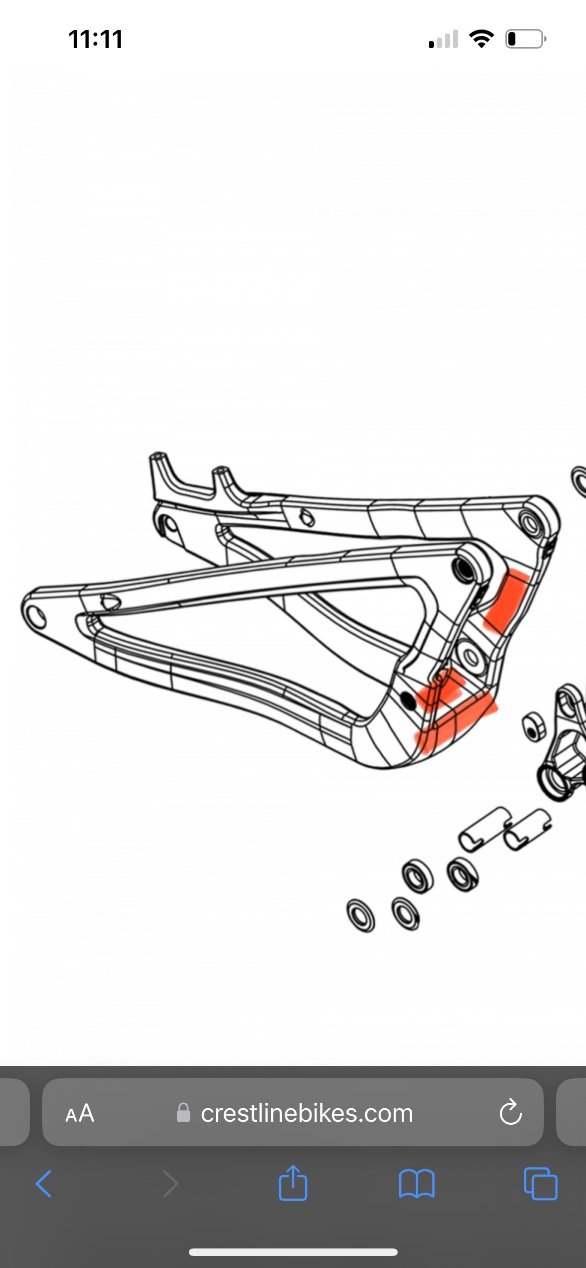

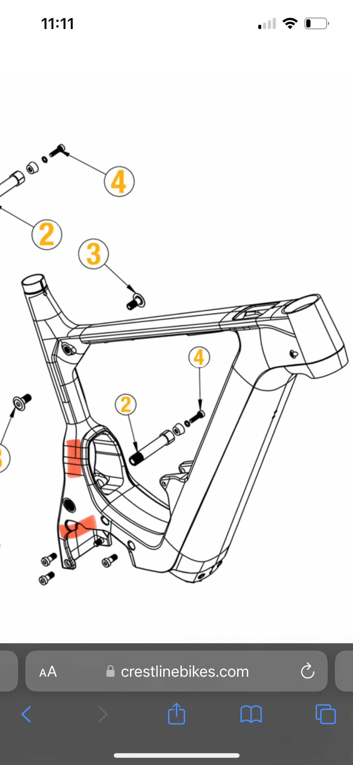

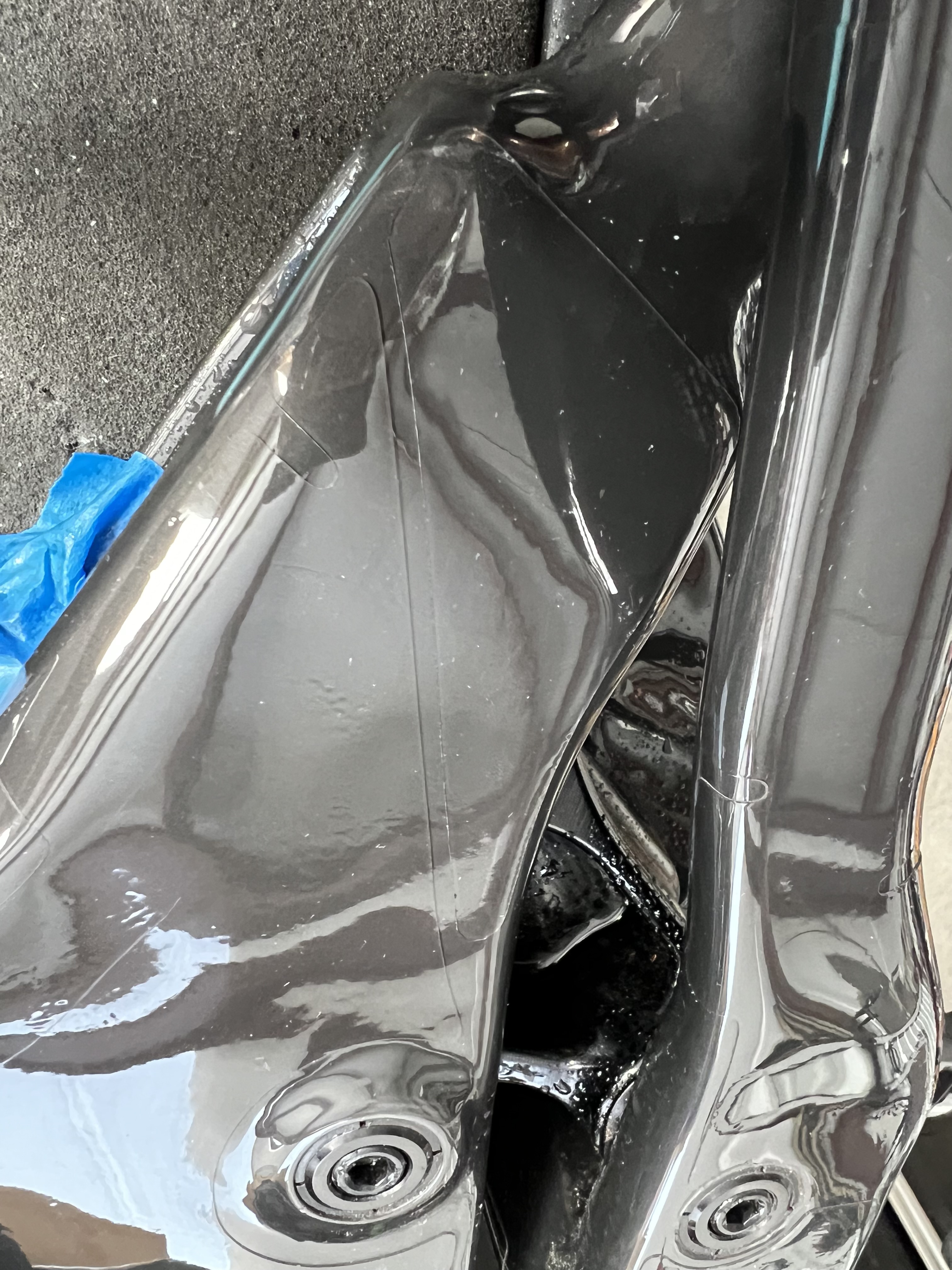

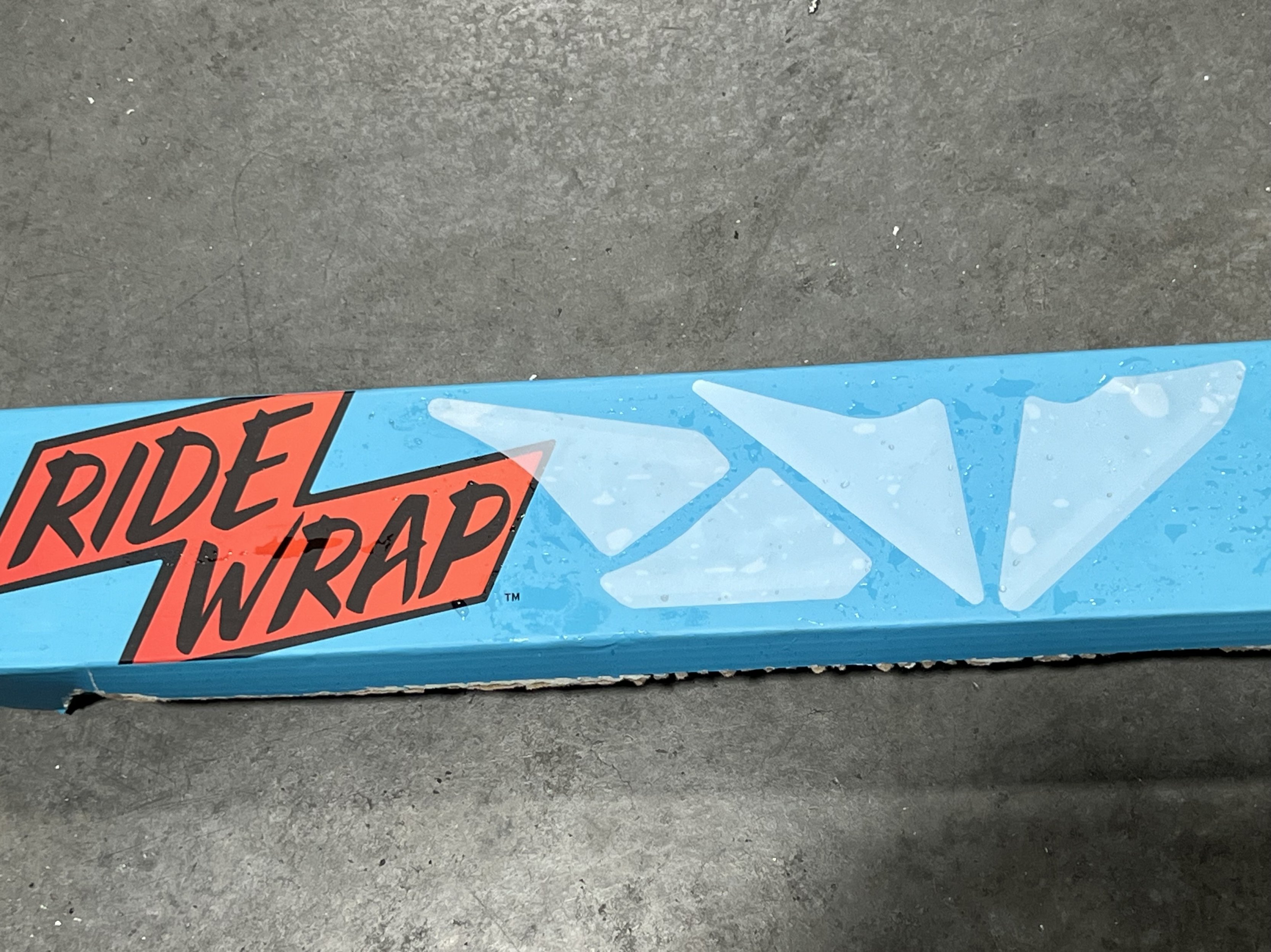

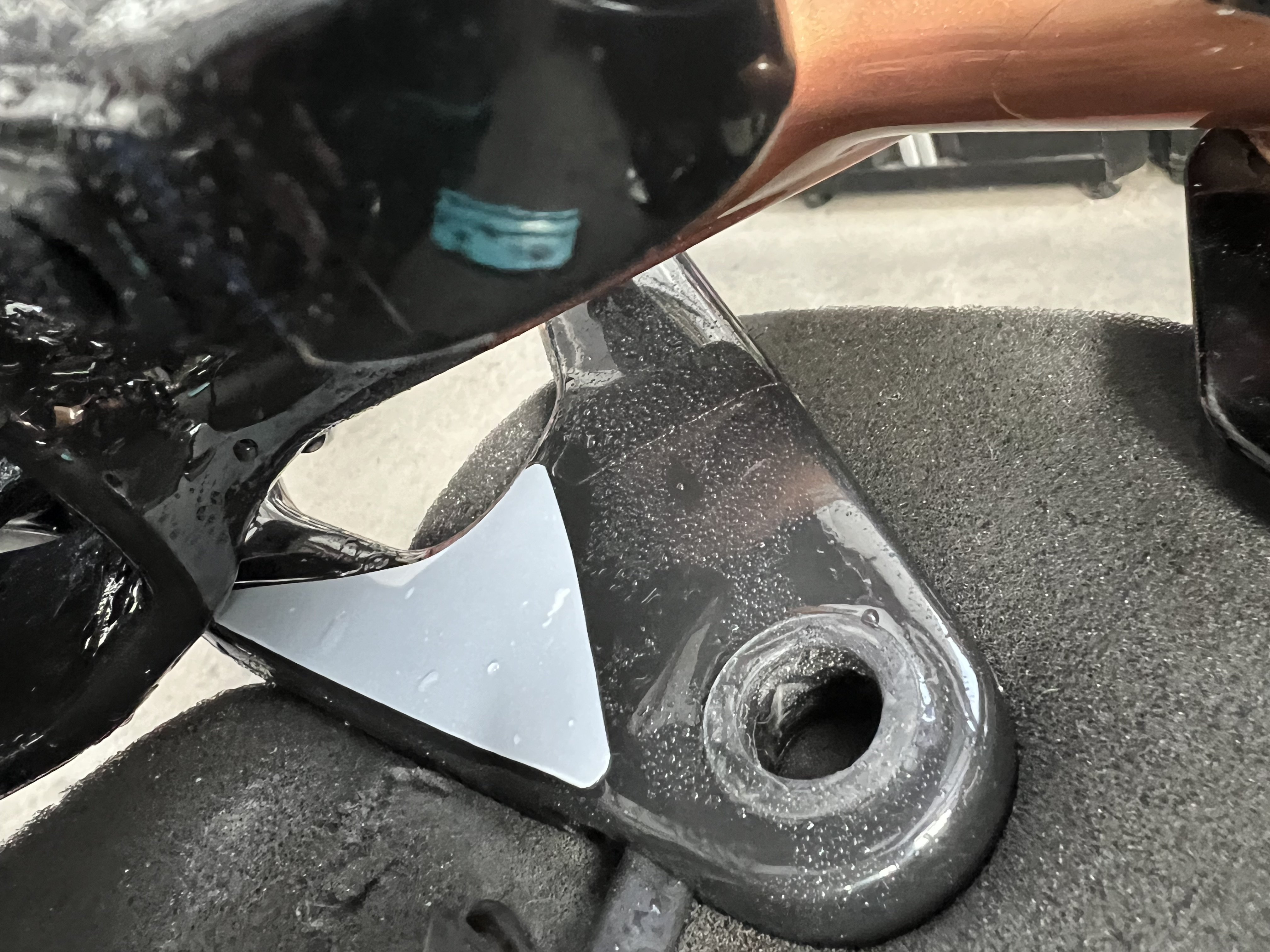

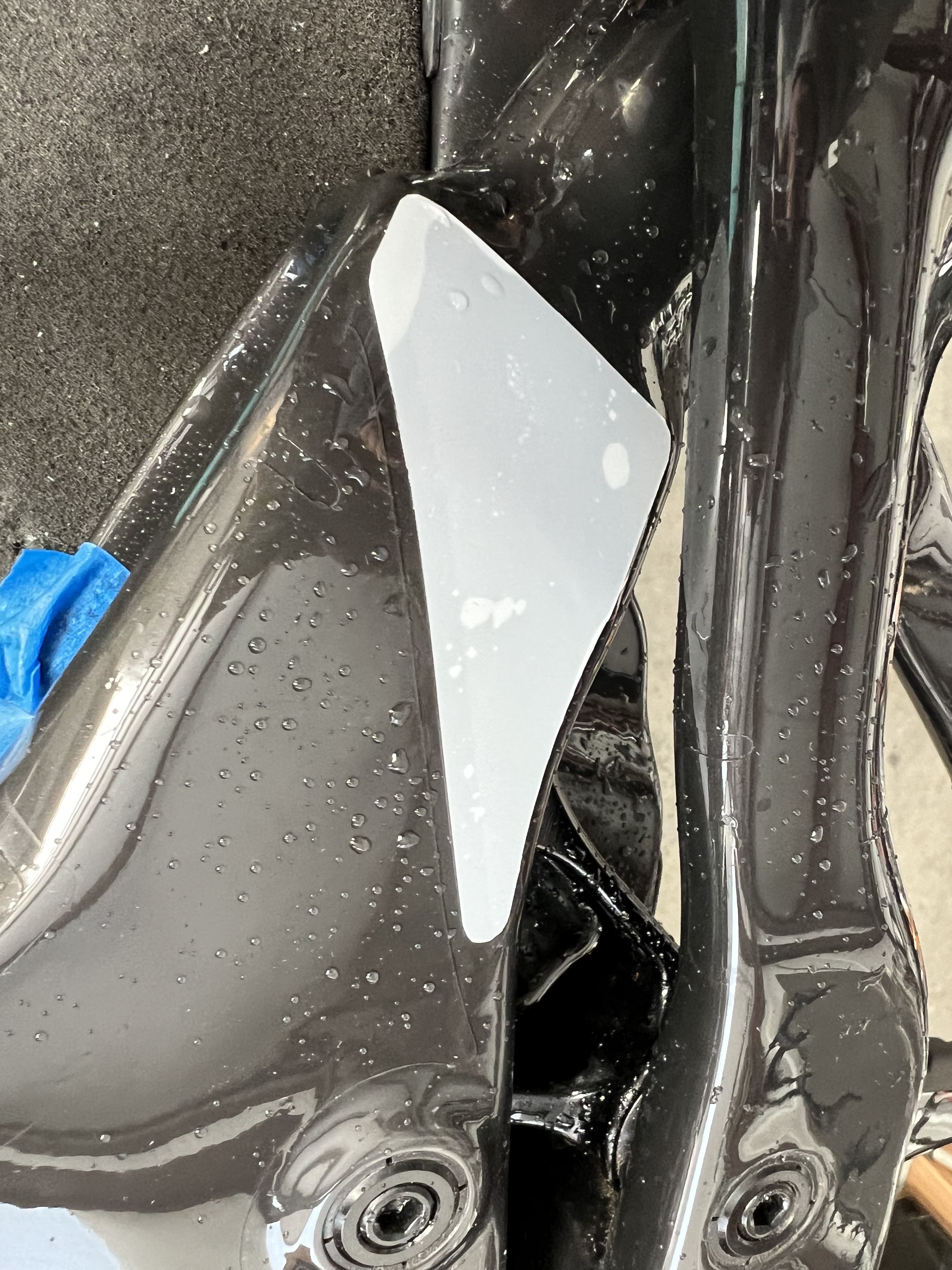

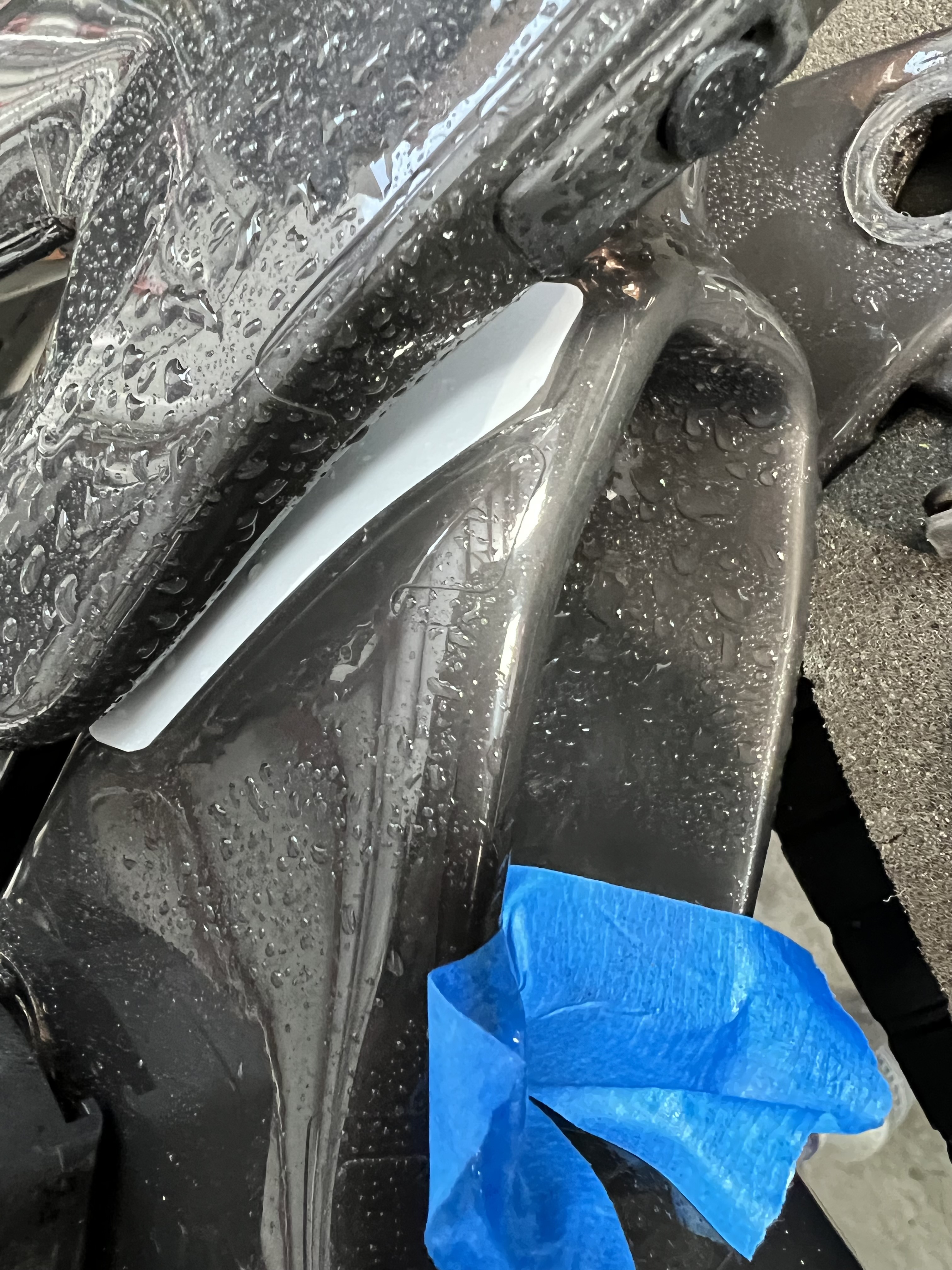

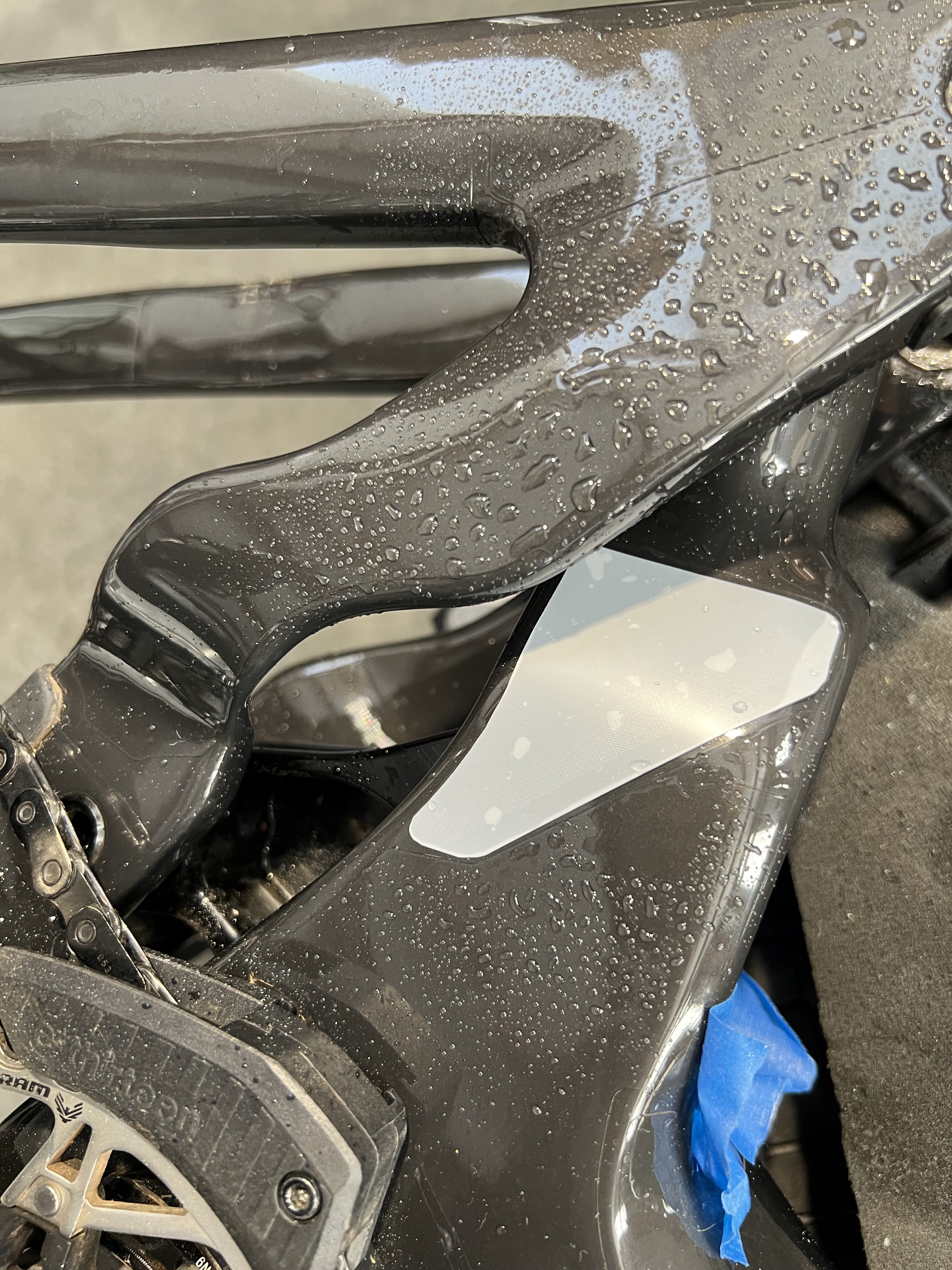

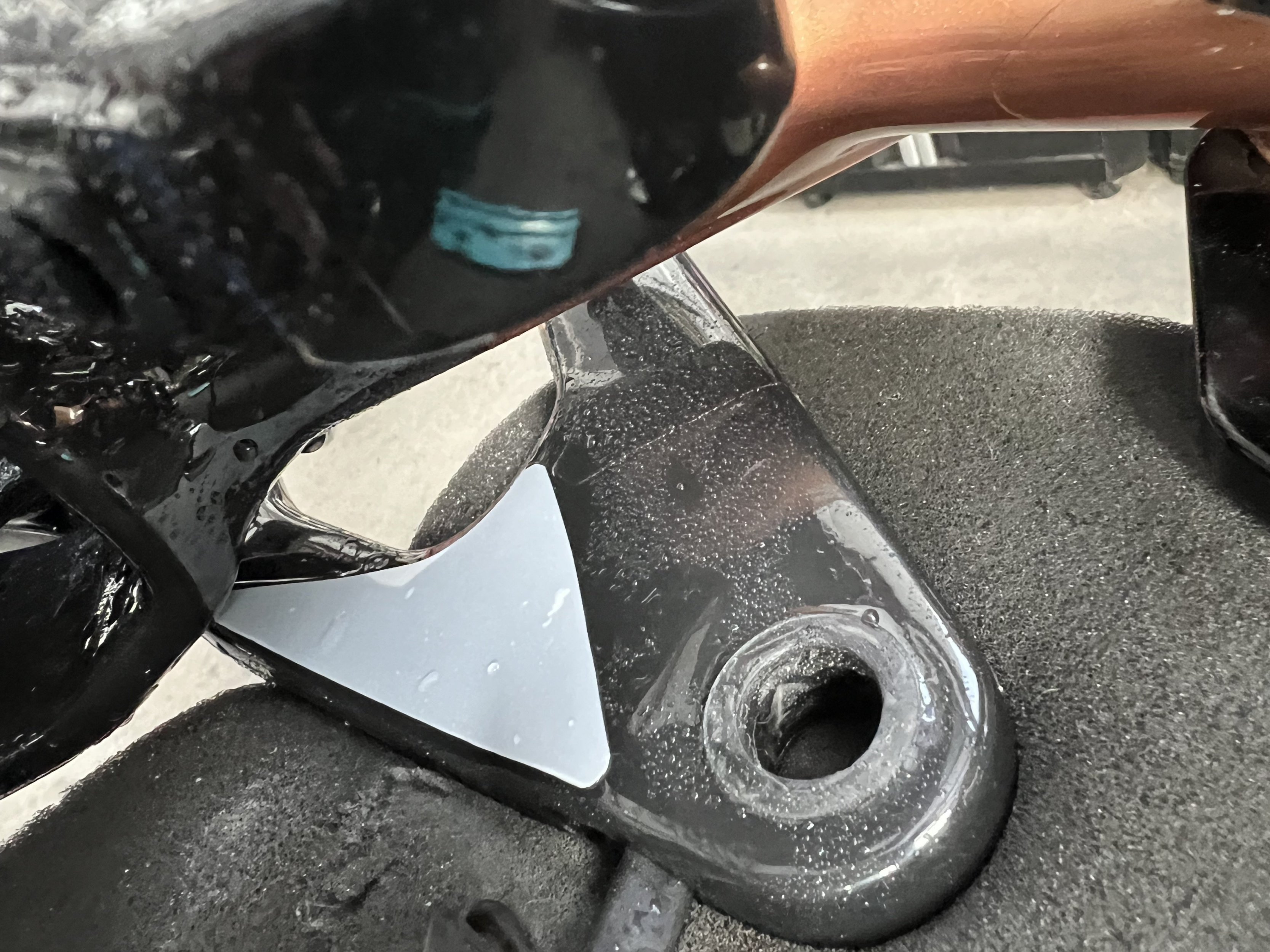

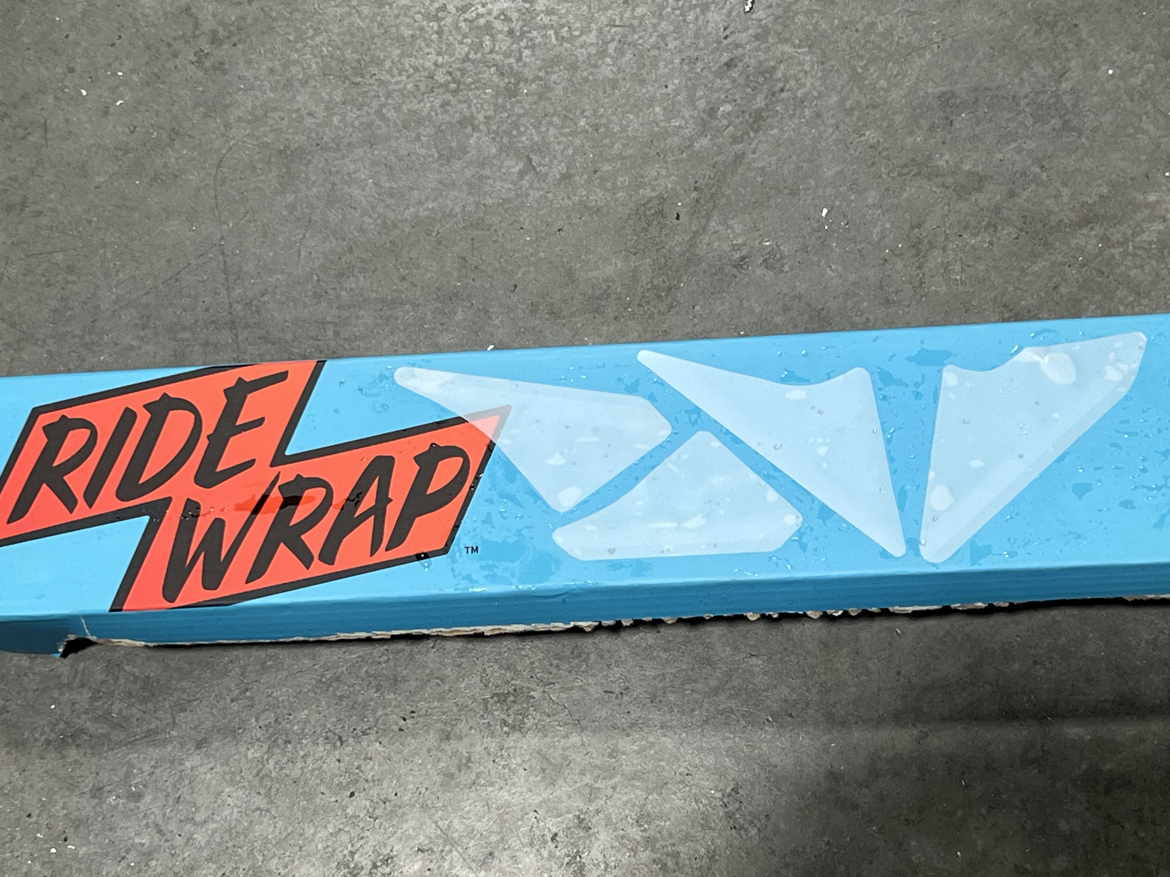

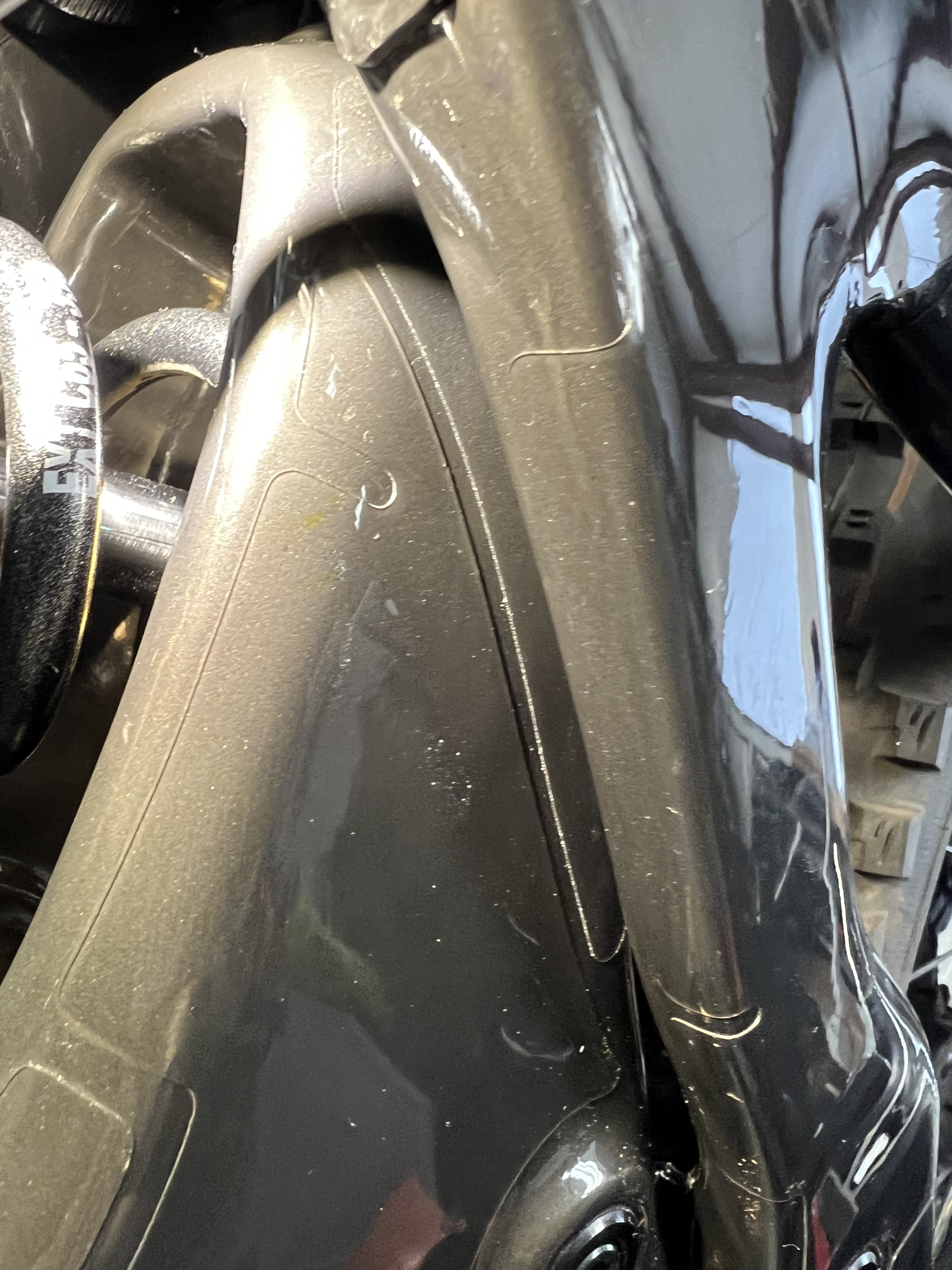

I recommend cutting some extra wrap pieces to be applied in between the swing arm and each side of the shock tunnel, as rocks get flung off the top of the rear tire into this tight clearanced area, getting stuck as the swing arm moves through the travel cycle. This required removing a pivot axle to gain access.
I also applied extra wrap to some other areas shown in red in the last two pics, which get hit with rocks from the rear tire. I did these areas while I was swapping out the 175mm link for the new 180mm link.
