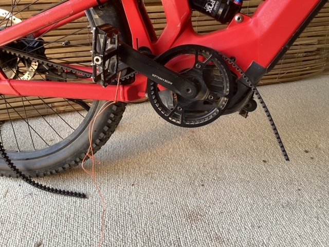

2000 miles on my Ries & Muller Delight Mountain Rollhof and Gates belt my belt snapped during a mild rock garden trail nothing dramatic but miles from anywhere fortunately mate rescued me but quite a walk with heavy bike .
In well over 4500 miles with chains and cassettes I never got stranded as one can usually make a repair on the trail.....With belts ...no chance unless you carry a spare.
No question about the ease of cleaning with belt and gearbox BUT I seriously in the event of a breakage you are stuffed .
Another major problem has been sourcing a replacement belt..... My dealer does not stock and the so called suppliers and dealers did not stock the right size.....Finally sourced from Gates main distributer in Germany .... EMTBs Gearbox YES Belt NO
I take it you put the belt back on there for the photo as it would have wound itself off the pulleys when you went to pedal ?
The tensioner is tied down to make the bike movable ? This wasn't a pre-breakage modification ?
I think the belts are generally accepted to be quite hardy, though you need to check the alignment, if it's not exact there will be a massive difference in life span. I guess you need to work out why it failed so you don't have the same issue again ?
I guess you're saying it's a good idea to have a spare belt in stock for your bike for whenever you do need one.

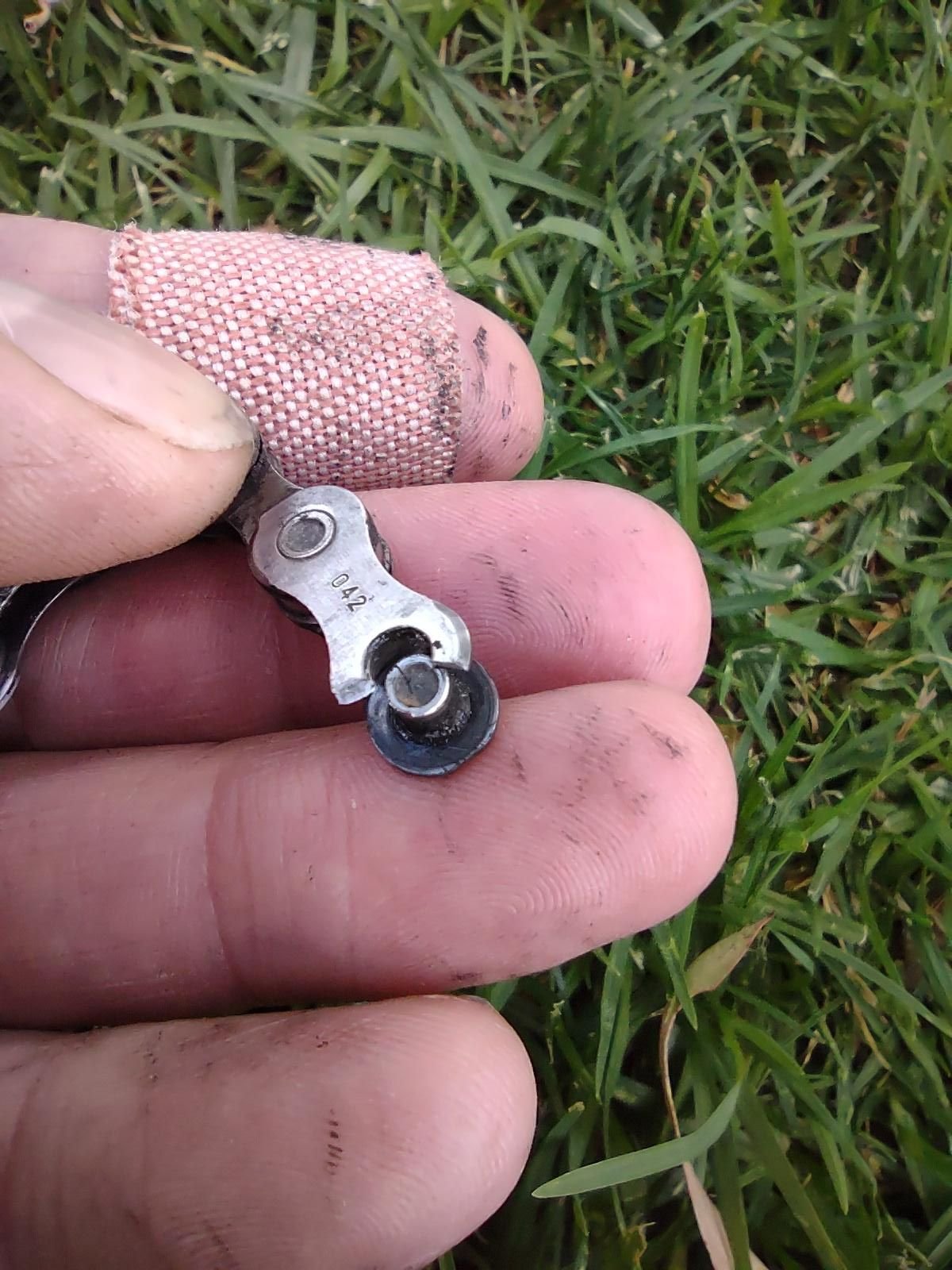

I managed to get 5100km with one X01 Eagle chain. It snapped from Powerlock. No 0.75 stretch yet though. 😁
EDIT:
but honestly i believe that the planets were in a favorable position in that time, an exceptional case.
I have new X01 now, interesting to see how long i can get with it this time.

The xt chain broke at 2000km 2 weeks ago, the pin broke out.
