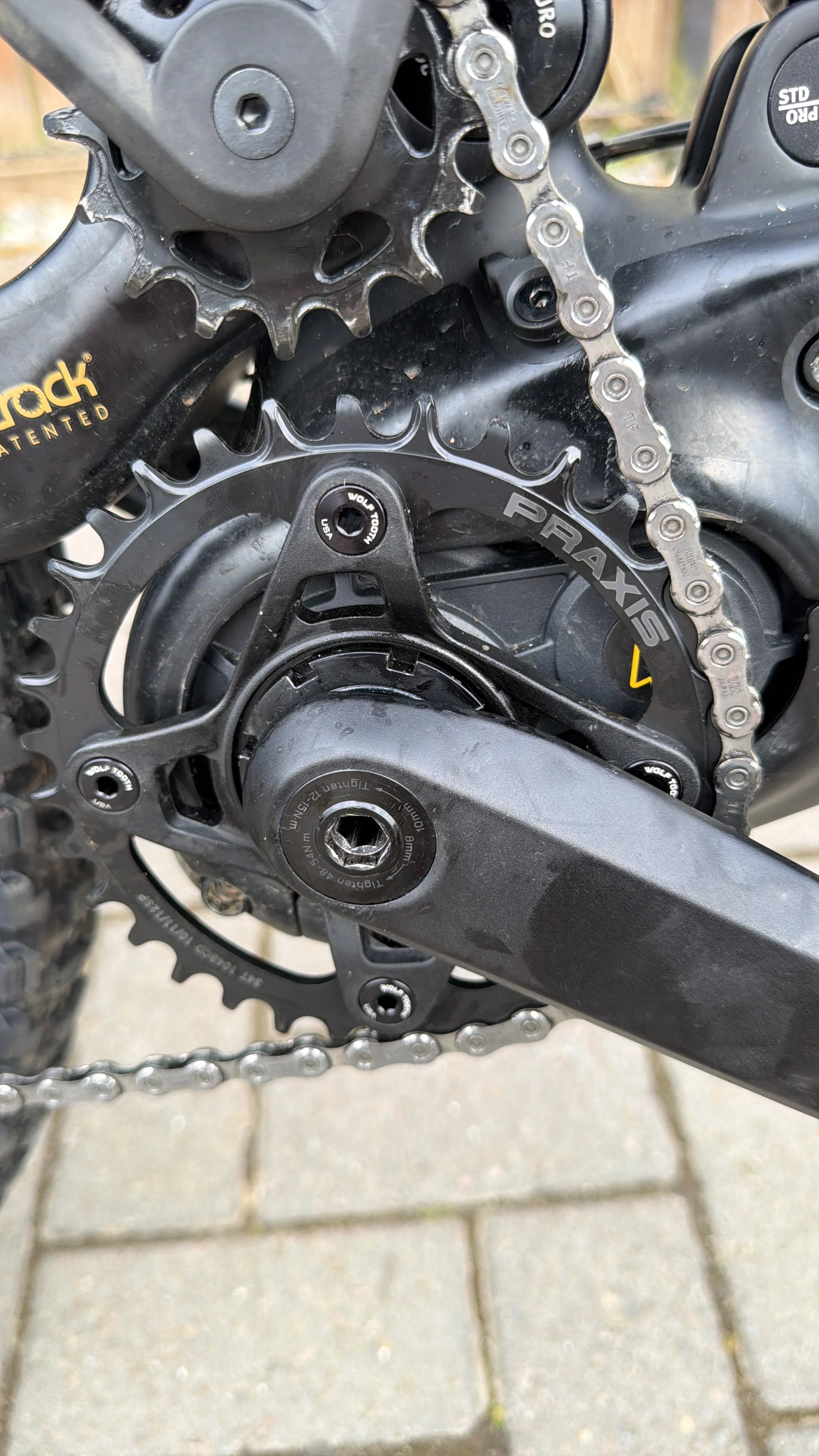

Try wax and see if it goes away... The idler is an extra piece of toothed metal introduced into the system over a conventional design. I've noticed as the wax wears off I get some noise when hard pedalling but once replied, it's gone
Update on this!
Was the rubbish DJI chainring. Swapped it out today noise gone. Using a 34T Praxis ring. Looking at the teeth on the DJI ring their profile is all over the place! This was effectively causing chain suck which then under load was forcing the chain harder on to the teeth and the noise was the vibration of the chain trying to release from the teeth at the bottom of the ring.

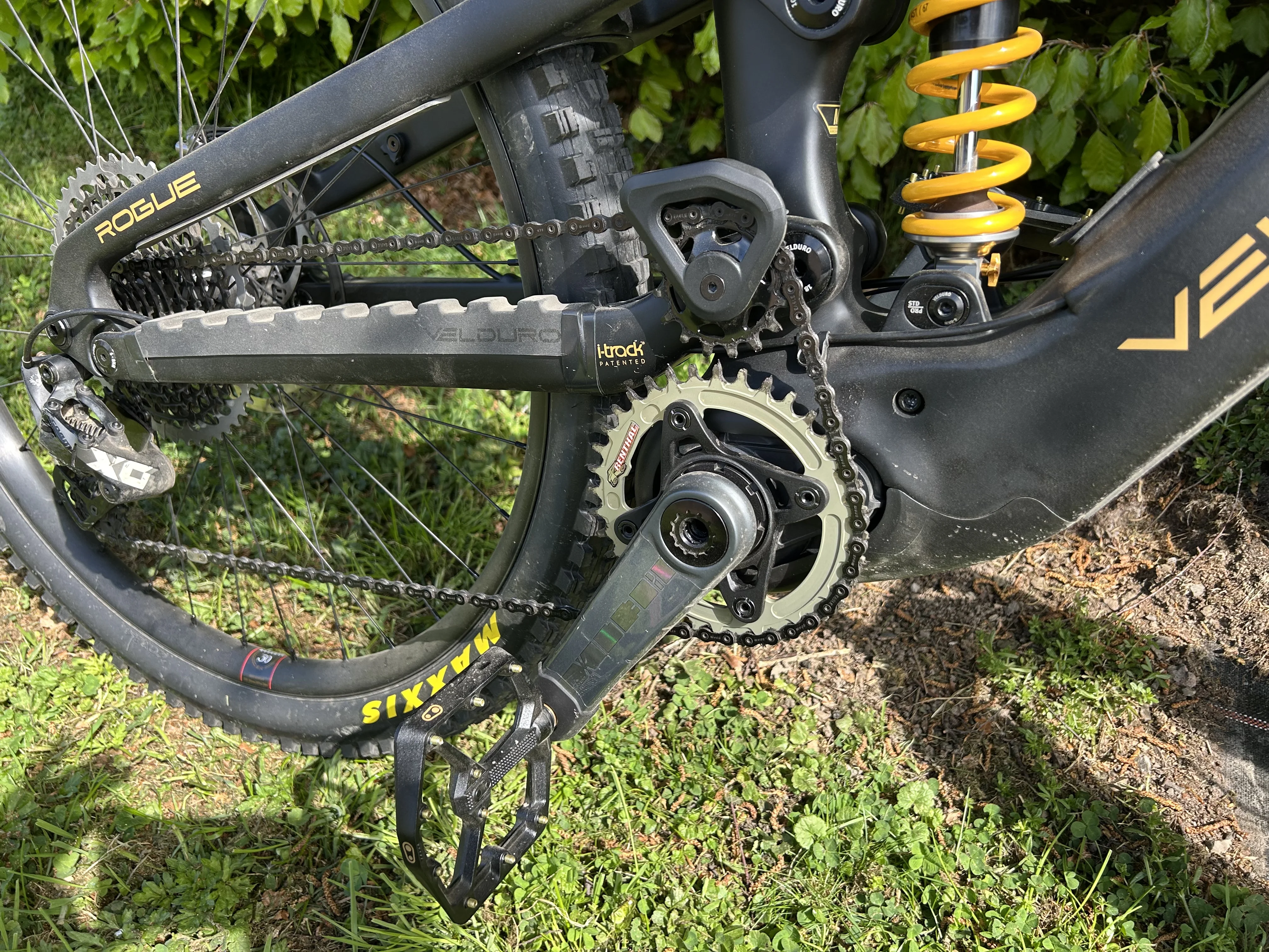

Any you lads running a 36 tooth chain ring, I know it's rated for 34 but thinking cassette life.
I'll get back to you - will be fitting one when I have time in the next few days.. it is sat waiting right next to the bike!
but if frame says max 34T, if you run anything larger won't potentially catch the chainstay?
Yip, it could catch the idler or the chain stay hence why I am asking if anyone else had tried it. Lots of people mod bikes out of guidelines without issue so just looking at what other people have tried and failed or been sucessful with.
I’ll be honest I’ve mod my bikes always but not outside of manufacturer sizing for things like chainrings, forks and shocks, if max fork is say 170mm I don’t then run a 180mm as an example.

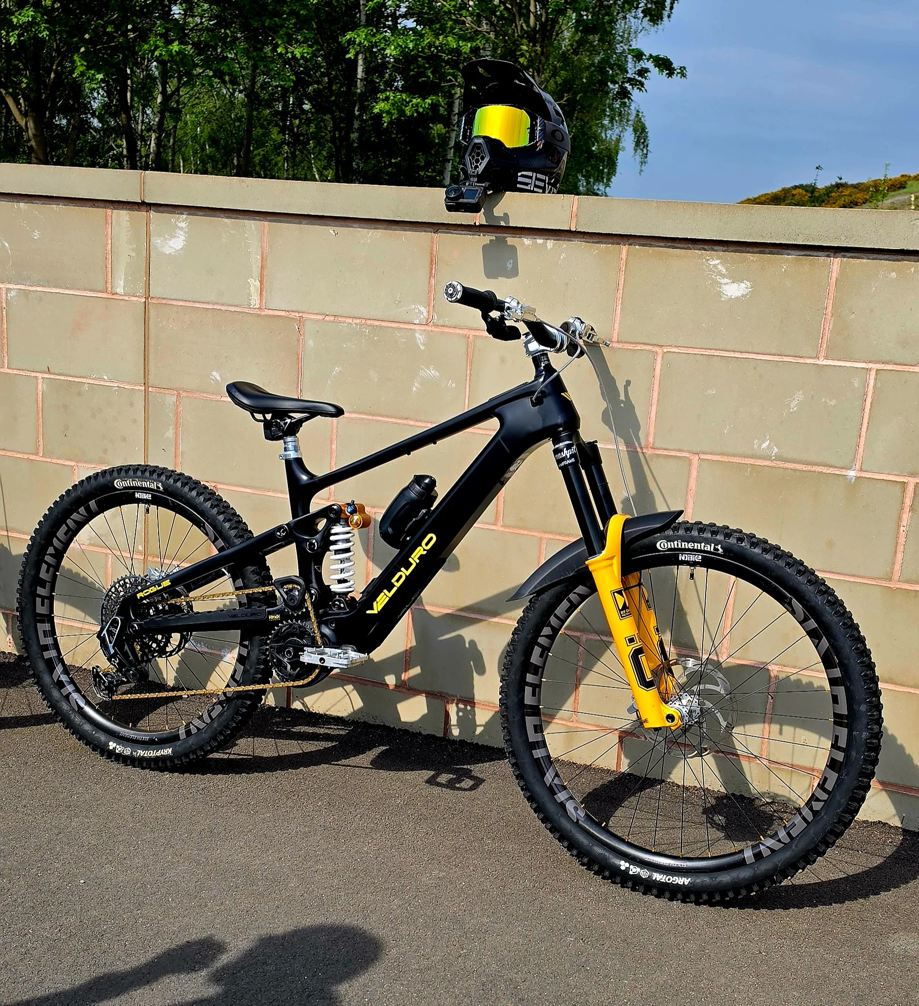

For anyone who's looking at getting a Rogue and stuck in the minefield of options on other bikes, here's my review as seen posted on Facebook
Also, this not a chatgpt or any other ai post. This is my opinion after 360 solid miles so far
Il start by saying I'm not been asked to say this, nor am I being paid. I'm just that stoked on the bike i wanna share my thoughts and hopefully may add the velduro to your list
Ordered as a frame set direct from Velduro UK and built using all my own preffered and tested components
Frame - size large set up mullet. 180f 170r travel
Seatstays in 27.5 and shock in progressive mode
If I were to describe my bike in one word I'd say Invisible (yes, it's a weird word to use but youl understand why) - there's no worries at all, no concerns whilst riding, no thoughts on whether the bike can take whats in front of it or what's that noise moments. Its tight, it's tough, you don't need to think about it, leaving me to concentrate on enjoying the ride in full confidence
For those that don't like the word invisible, here's a few other words to describe it and why
Fast - no matter how much I demand from the bike, it is happy to give more. It feels limitless. It loves to go hard and changes direction well no matter the speed. The faster you go, the more the bike gives you
Agile - corners are easy, it doesn't get held up anywhere, point the bike and goes exactly where you want it if set up right
Wheelpath - the rear moves out of the way of anything you throw in front of it, gives you a controlled magic carpet feel. Tech lines are turned into flow lines helping you go faster and brake less which in turn gives the suspension no restrictions enabling them to do their job
Grip - it struggles to let go, composed in off camber sections with the right tyres and suspension settings. The harder you ride and load the bike up the more it clings on to the terrain
Noise - it's near on silent when set up with wireless dropper and gears. The chain dampener eliminates chain slap, the frame does a good job of keeping cables still and with the m2s, the motor rattle is gone
Suspension - Ohlins rxf38 m2 fork with smashpot v2 coil kit and ttx22 m2 shock with cane creek progressive spring...
Bottomless feel from big hits to flat landings. The hydraulic bottom out from the smashpot v2 paired with the ohlins damper is just pure magic. The progressive spring in the rear twins to the ohlins shock like it was made for it. Ground hugging where you want it and support to push off when you need for hard riding and jumps
The brakes - Radic Kaha v3, the strongest and lightest feeling brakes I've had the pleasure of running. Cnc machined, precision parts and attention to detail is on par if not nicer than hope. I'm no racing snake, I'm 100kg of brute aggressive idiot and they stop me exactly when I tell them to. They don't fade, they are silent. They just work. Another invisible component to add to this amazing experience when riding
Motor and battery - Avinox speaks for itself I won't go into it tbh because it's not the standout feature of the bike. It is amazing and very well integrated. It's quiet and powerful but dial back the settings for a better experience of balancing power and range. There's many reviews out there so watch them
I ride anything from rooty, rocky trails, fast bikeparks to jumps, drops and everything in between. There's nothing this bike doesn't like. It's effortless to ride, such a joy and gives me nothing but big smiles all day long. Jumps are my go to and on paper this bike shouldn't jump that well, in reality it loves them. It's so stable in the air, easy to get off the ground and loves to be sideways (I'm still learning that bit)
The bike as a whole (using all the same components I've run on my last bike, my Orbea wild) is hands down night and day a better bike and the best bike I've owned to date. The last time I was this confident on a bike was my old Haibike tank. The drawback to that bike was its looks. The Velduro is beautiful, and sleek. Catches all the attention on the trails and starts conversations
The bike feels like a new generation of bike. I've owned many ebikes and they all felt somewhat the same, some like they were dated, wooden, limited by design and tech. The Velduro feels new, redesigned and fresh.
If I was to put the Orbea wild and the Velduro back to back I'd say the Velduro easily takes it. The Orbea is a fantastic bike but I always wondered every ride if it was going to break (4 frames in under 2 years). The Velduro I don't even think about it. It's solid, it's built well, It's compliant, it's perfect.
A solid 9.5/10 for me. The poor design for a charge port cover let's it down from a perfect 10, and that's OK for me.
I am one happy owner
If you're here for user experiences, or on the fence about buying one, I'd say do it, you only live once
Life's too short to ride mediocre bikes
Buy the frame and do a build with your favourite and trusted components. Or buy one of the full builds if youre not fussed what you run, either way..... You won't be disappointed....
If you're interested and made it this far down, have a look at my YouTube channel to see how the bike is doing and what it's been through. I understand we all have different tastes in ride choice, but here's mine
To the owners of the rogue, what's your thoughts? Are you having the same experience as me or a completely different one?
