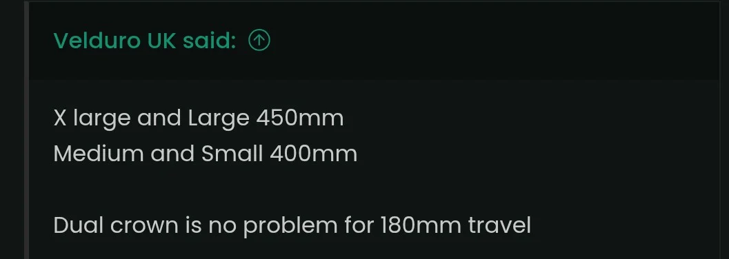

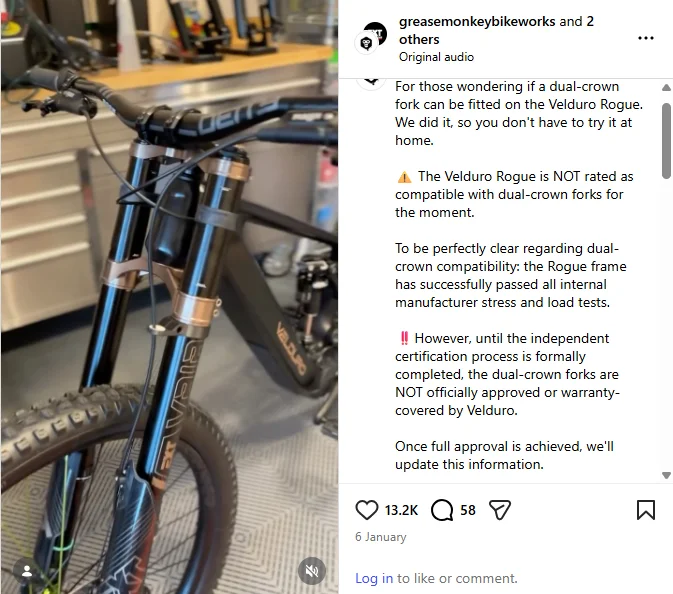

Any word on whether the Rogue will be rated for dual crown forks? I think I heard a while ago that it was being tested and might be approved, but I might be conflating Cat 5 testing with dual crown testing; apparently Cat 5 doesn't automatically include dual crown.
Cat 5 does not automatically mean dual crown certified. Although the frame may be strong enough to run a dual crown in terms of build quality, there may be limitations such as bottom tube width (too big and limits steering angle) meaning it's not recommended
Cat 5 in rider terms basically means the bike can take a punishing 😁😍
I suspect not in this batch at least. Future batches? Who knows at this stage.
The information released back in October is unlikely to be correct unfortunately as far as we know.
Which is a shame as i based my order on this. Probably going to have to buy a single crown fork now rather than the 40 i planned to use.
Anyway, here is a pic of one I found on Instagram. Steering lock would be terrible with a usd fork with the big upper tubes, depending on how much offset was in the crowns.
