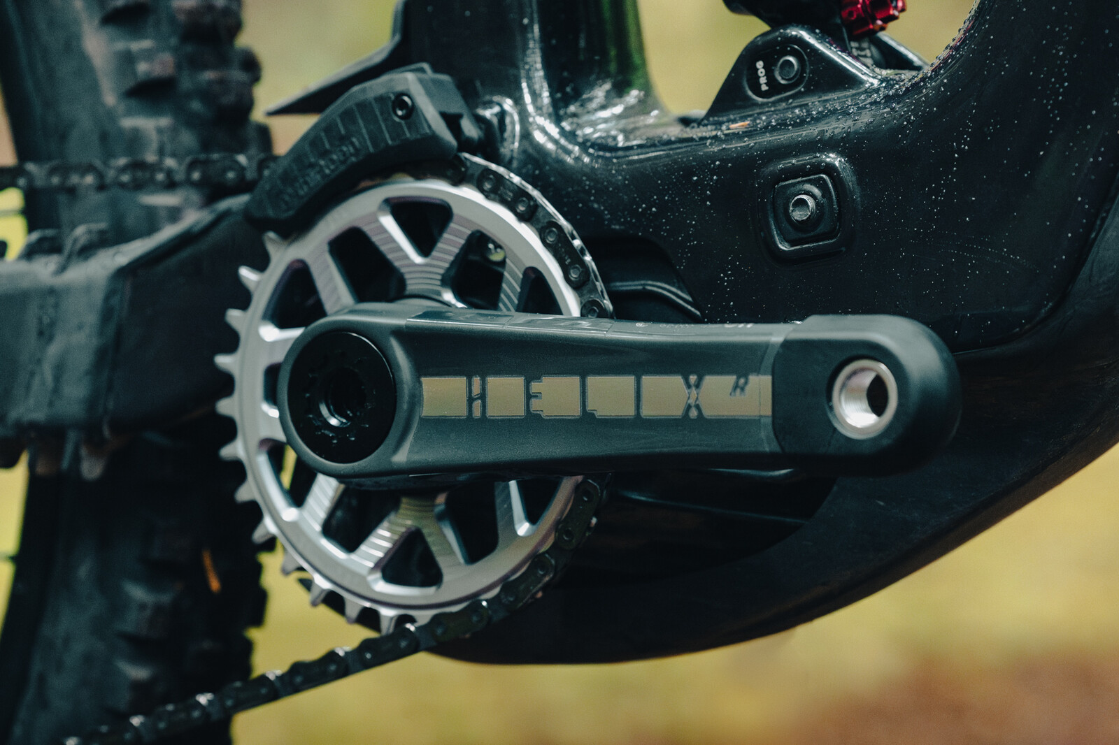

Im starting to plan my build, i see the frame ships with 155mm cranks in all sizes. I'm a bit of a weight winnie and looking to shave some weight off where i can. Will 160mm cranks arms be ok on a large? The cranks i want dont seem to be available in 155mm for the DJI motor.
Helix Race Carbon Cranks.
Helix Race Carbon Cranks.View attachment 168937
i cant see a problem other than slightly more chance of pedal tagging.
Going from 165 to 155 cranks on my current bike made a huge difference. My wife reckons the swap from 160 to 155 on her bike was noticeable as well. Personally, with all the power of the DJI motor I'd go for the extra weight....
Only time I’ve ever seen a buddy in my group walk his bike home, was due to carbon cranks. Pedal strike broke the pedal thread housing. Personally don’t think the weight is worth it when it comes to cranks. Metal is best 🤘
Concur. Pedal strikes on technical climbs were the bane of my riding till I swapped to shorter cranks. Go shorter like 150mm. But don't go longer than the 155mm.
It really helps with things like climbing stairs. And you can run your suspension softer, so the bike sits deeper in the shock.
I'll admit that i enjoy the hell out of my 150mm cranks on the crestline. But I also have 165mm on the dh bike and 170mm on the enduro mtb
