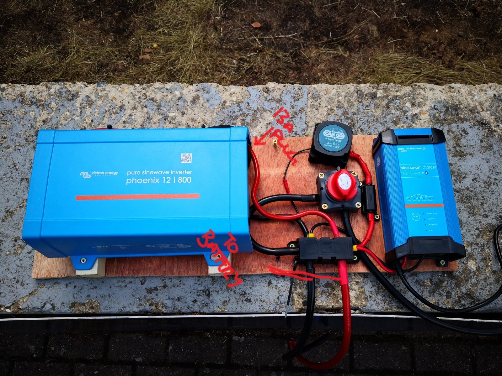

View attachment 19453Here's my setup. I can charge the leisure batteries from solar, the van engine and also from a hookup on a campsite etc using the charger on the right.
I've got 2 batteries as I run a fridge in the van, I reckon you could get away with one as an ebike charging station, you just need the right size invertor.
My charger is 2.5amp @ 230 (Shimano) so 2.5 X 230 = 575 watts minimum, so I got an 800 to be safe.
I'd be wary of cheap invertors as they rarely give the rated output and might give a dirty signal that causes issues with electronics.
I had my ebike charger on test to see exactly what it was drawing and never went over 0.8 not sure if that's volts or ah now.
Either way it's nowt
That's probably amps. It was probably that low because the battery wasn't empty, as the battery gets charged it will draw less as it's harder to charge.
It should say on the charger what the max draw is and you should really spec any system for that.
0.8 amps is about right for ~240 volt uk supply as it's around 190 watts.
The charger will accept a voltage range input, probably 100 - 240 and has a max amp draw of 2.5, the max amps is drawn when at the lowest voltage as the energy required is in watts, therefore 100v may draw towards 2.5 amps but at 230/240 volts the amps will be a lot less.
These chargers generally seem to be charging (output) a 42v pack at up to 4 amps meaning it requires around 168 watt plus inefficiencies in the charger and inverter if used.
I tested my charger at home and the maximum it drew was 175 watts which was 0.75 amps at 234 volts. a 250/300w inverter should be more than enough to run one of these chargers.

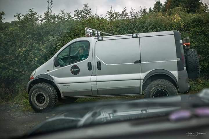

I've got a Renault Tragic for taking bikes about... But would love to make it like this one.
I don't think so, as far as I can tell only the first Gen Traffic was available as a 4x4.

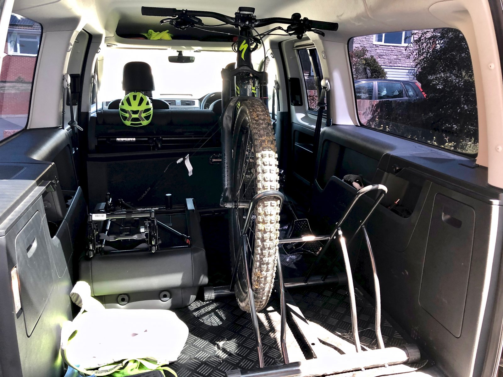

I have a VW transporter for my work (photographer) but could really make do with an estate car. I mainly use it for lugging bikes, surf boards etc around. I recently watched a review of an ebike on you tube and the guy rocked up to the trail in a van and he had this ingenious contraption installed against the bulk head. So simple, just a rack where the front tyres locked in. Have you ever seen this before? Have t been able to find anything similar online. I guess you could have one made.
any links to the YT review? :unsure:

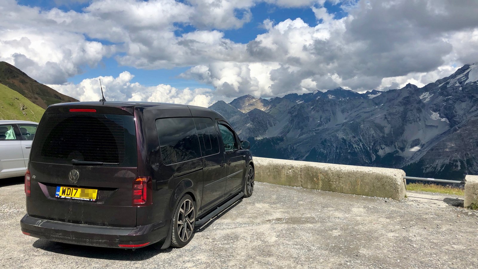

I like that a lot. Caddy Maxi ?
Yep, Caddy Maxi Life (Maxi = LWB, Life = MPV version). Preferred this over a standard Caddy panel van and then retrofitting glass & seats. The Life already has them and also classed M1 not N1 on the V5 by DVLA so car speed limits apply too.
Mine’s slightly non-standard, I’ve got 18” GTI alloys, 60mm lowering, sportline sidebars, front splitter, remapped to 190bhp and various other mods.

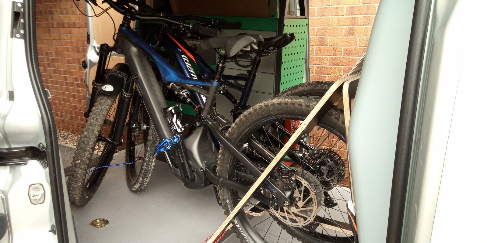

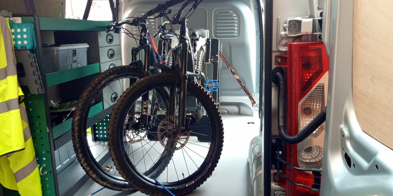

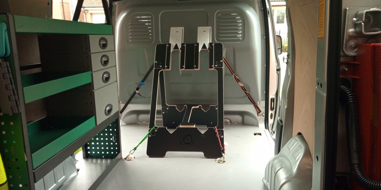

Have a Peugeot Expert Mk2 on a 65 plate. Use as my day vehicle and for towing a caravan, been a huge upgrade for biking and towing. Getting 40mpg out of it and with a 6 spd box it's great for motorways, was cheapest for insurance for me as wanted as a private and commuting vehicle.
Using a Bikestow for holding the bikes in place and shelving was in it when we bought it.
